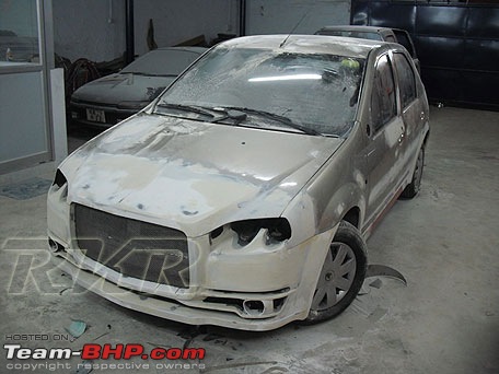

And how she looks now before going in for her pre painting operations.
Eyes off, grille on she presents a disguised, even sinister look...
Tidying up the rear with a grille in her undertray
She looked quite happy with the side profile of her famed aquiline nose
Scrub, scrub, scrub away gently down the side,
merrily, merrily, merrily oh massage away my hide
errr sheet metal is more like it madame...oh these huming damsels get it all mixed up some times, especially when indulging in a body massage; but who can blame her - dont well all love massages.

The front is indeed something very muscular like an American car from the 50s. The rear is still Loganesque but that's probably 'cause I know it is a Logan; it could also pass off for an Accent. The front looks kick@ss, for the record. I am curious. Are you going to re-do the interiors too?

Is the Audi/Evo like snout the final design idea? Or is it going to be changed? Currently, there is a lot of disconnect between the front end and the rest of the car in terms of design appeal.

The grill would add real charecter to the car, it can either enhance it or can take it to the wierd and wacky thread, I just waiting to see what would the grill look like.

Yeah RKR, the grill is gonna determine the looks. Suggest you study the various types of grills - wire mesh, honeycomb, the kidney BMWish grill etc. You can photoshop the options and then take a call. You could even fabricate 3 or 4 types of grills and change them from time to time...What ?

the workmanship is ultimate. especially the lines in the bumper. they are very detailed better than oems.
i think it will look a bit sedate if you can manage to split the huge grill likes ones on punto and have a tiny numberplate on the extreme right of the split.

I too percieve the front 3/4 to be more attractive than the rear 3/4 - but this was because asper our initial brief dictated by the budget, the rear was to only come with the subtle spoiler, number plate shift and bumper skirts. We further added the under tray and double chrome pipe surrounds to at least add an area of interest...
This will be taken care of in the next Logan project whenever that happens. It might even happen with the same car at a later date.
I am still on the lookout for a supplier of decent custom LEDs and Clear lens tail lights for the Logan. I do have a design for the tail lights LEDs and depending on the successful outcome of the current R&D it may be installed post painting and delivery perhaps.
As per the original brief, the paint shade might more or less remain the same as the innards of the doors, boot etc. will not be repainted this time.
I am actually inclined to paint her a darker shade of brown - but will have to consult with the painters and my friend before i go ahead...
OK guys let me let you in on the gory secret. the car already has the wire mesh grille (australian stainless steel I believe) installed in the last pics posted check the side profile on her aquiline nose. Not too clear in these snaps - it seems ok but needs to be highlighted by perhaps chrome paint on the inner border of the grille. This is some kind of new type of chrome paint I believe and will have to see how the finish is before I go ahead with it.
Once the logo is placed on it post painting and the crash bar behind it is painted black, it should look better and uplift the frontal look suitably. We do hope that it wont drag the poor lady nose first into the wierd and whacky thread. The mesh actually looks like a finer version of the Jag or Bentley grille. Well it is also my learning curve - might choose a thicker version the nest time.
I will convince my friend to advance his plans to fit 14 inch alloys to suit the car and fill up the more prominent wheel arches. No in-your-face spoilers/ skirts or other aerodynamic aids as this car is to be used for corporate IT applications. My friend who is the MD of an IT company believes that this car brought him and his company growth and good fortune. Therefore this makeover to help retain it for ages as a lucky mascot.
I will post the pics of the orange swift later when done - yes it is also undergoing a less intense lower bumper alterations...
I will probably go for a numberplate garnish when fitting the numberplate onto the robust stainless steel mesh grille.
No changes are being made to the functional aspects of the car except the twin headlights which have a better spread and are more lumious than the stock ones. So no modifying the wipers to RHD compatibility.
