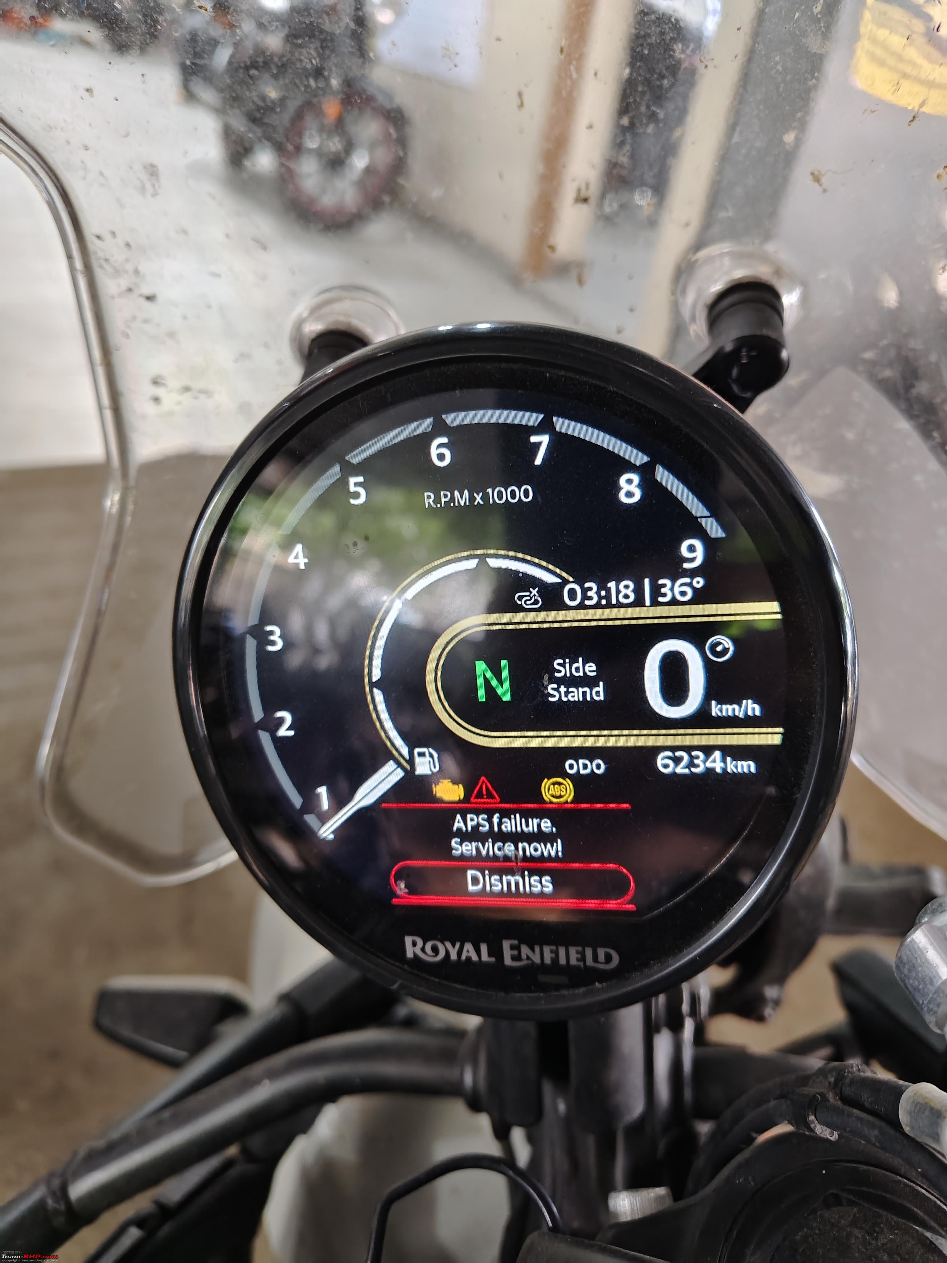

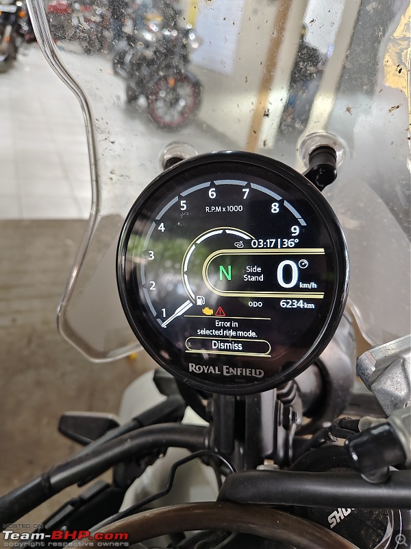

I have done more than 7000KMs on my Himalayan450 so far and I have been facing this issue on-and-off for the last 4000KMs. It started at around 3000KM on the odometer. The issue was similar to yours. 'Error in selected ride mode' and 'APS failure, service now' errors would flash back-to-back, the bike would not rev past 4500RPM with severe impact on acceleration. The issue would not go away even after turning the bike off and restarting after some time. I took it to service center multiple times. Initially they would simply delete the error codes and ask me to try. But the issue would recur sooner rather than later. They finally realised that the APS sensor (it's part of the right side throttle lever set on the handle bar) itself is faulty and replaced the whole set under warranty. The odometer was at around 5000KM by that time. Thereafter, the issue didn't show its face till recently. But, it has come back in the last few days. However, now the issue would go away if I turn the bike off - wait for a few minutes - restart the bike. I am planning for a service center visit coming weekend. I hope this time it's just a software issue.

From what I can infer from these posts, the APS and the "selected error in ride mode" issue at least per my understanding is perhaps TPS, Throttle Position Sensor or APS, Accelerator Position Sensor. Now, a software fix, reset works, if it works, if not my guess is that the entire APS unit has to be replaced, as TPS/APS sensors don't come as a standalone part on most of the bikes. But please do follow-up after your service appointment. APS or TPS sensor issues can lead to throttle working intermittently, the bike going to limp mode at set RPM when a complete failure occurs and what not.

Today also I have faced same issue while riding at around 70kmph. Luckily road traffic was not much, I was able to shift from right lane and bring the bike to halt without any incident. I keep on thinking how dangerous the issue is, if it would have been at a busy traffic, two way road, trying to overtake a larger vehicle.
Anyways after waiting for sometime the invalid riding mode message changed to "ECU/TPS Service Now" error. After switch off and on the ignition I found some error related to ABS communication and then it disappeared when I started riding. Also noticed that Fuel gauge is giving random readings, sometimes show mid of second bar and then mid of third bar at end of ride.
Looks like I have to pay a visit to service center, which is far away from my workplace or home.

Today also I have faced same issue... Anyways after waiting for sometime the invalid riding mode message changed to "ECU/TPS Service Now" error. After switch off and on the ignition I found some error related to ABS communication and then it disappeared when I started riding. Also noticed that Fuel gauge is giving random readings, sometimes show mid of second bar and then mid of third bar at end of ride..
Please visit the service center ASAP. The issue is not uncommon for Himalayan450. But the service center guys react as if our bike is the only one with the issue! They may just delete the error codes and ask you to give it a try. That would only waste your time. Tell them to have a proper check up and resolve it the first time itself(which may include replacing the APS sensor unit).
