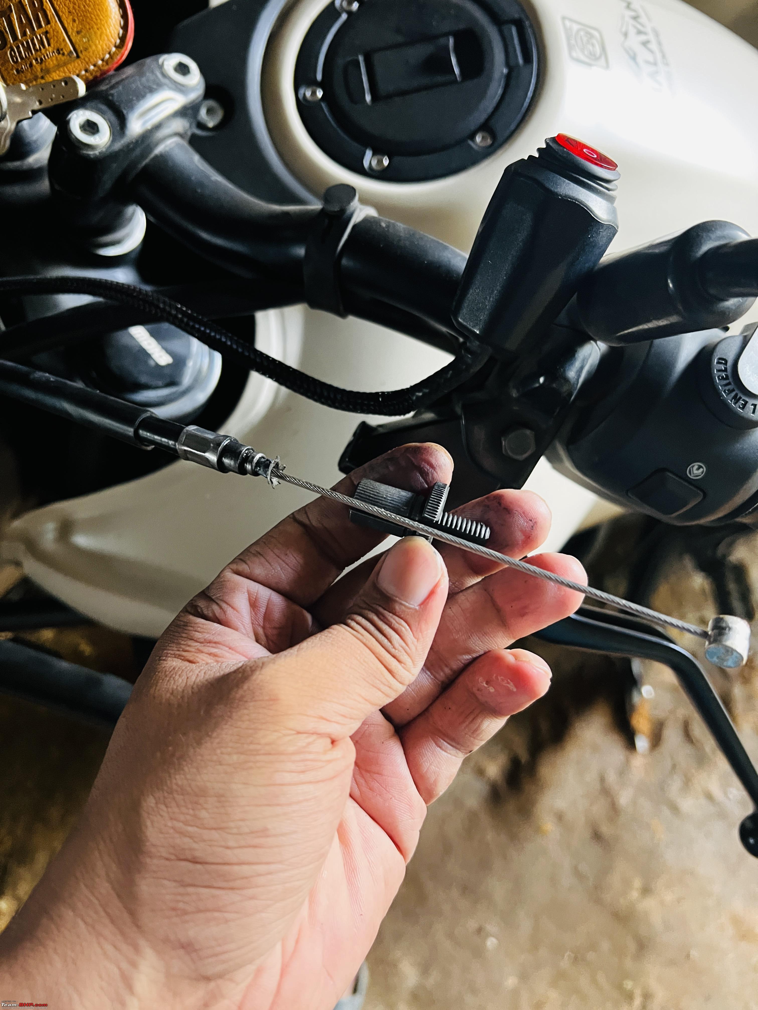

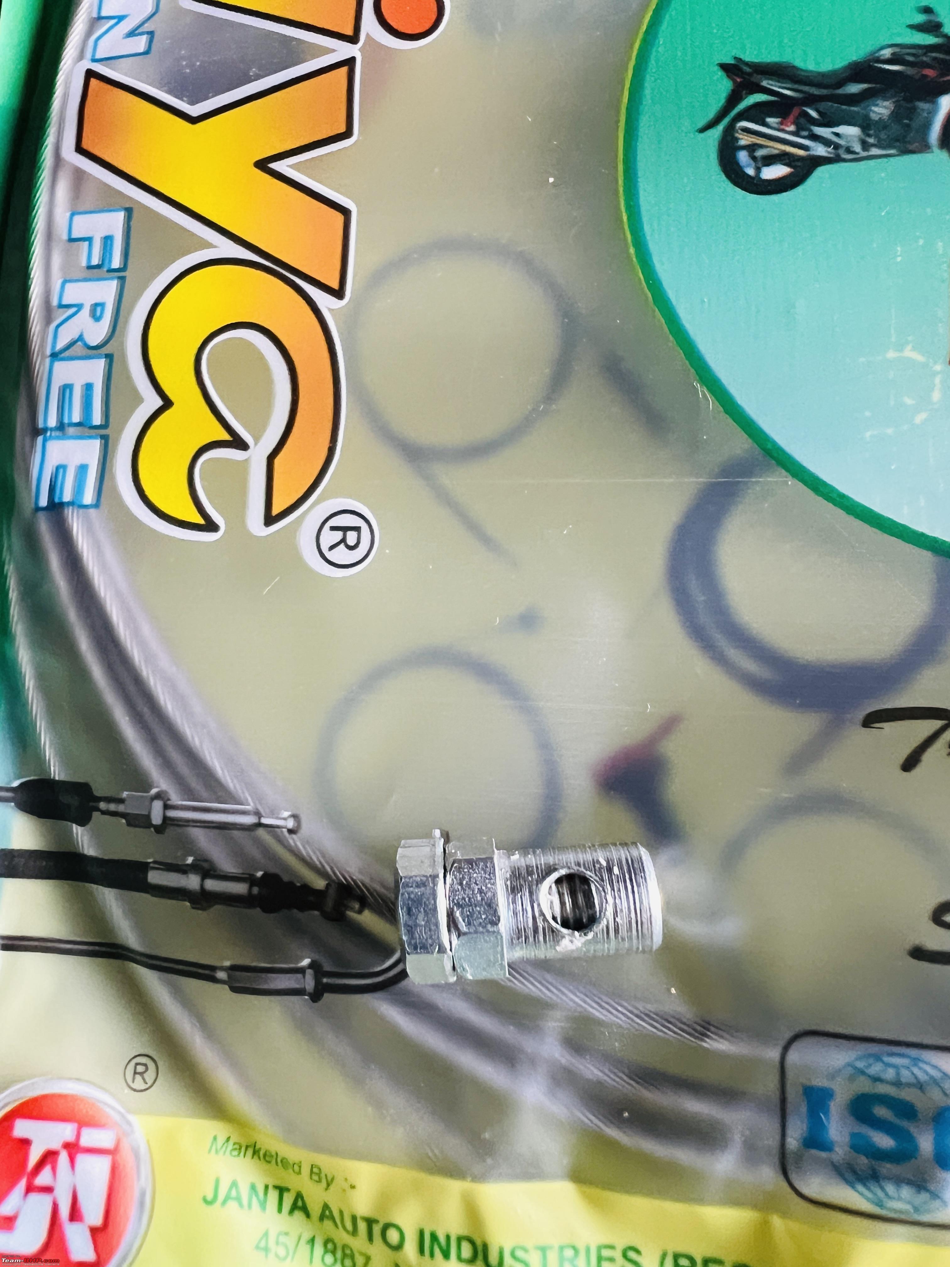

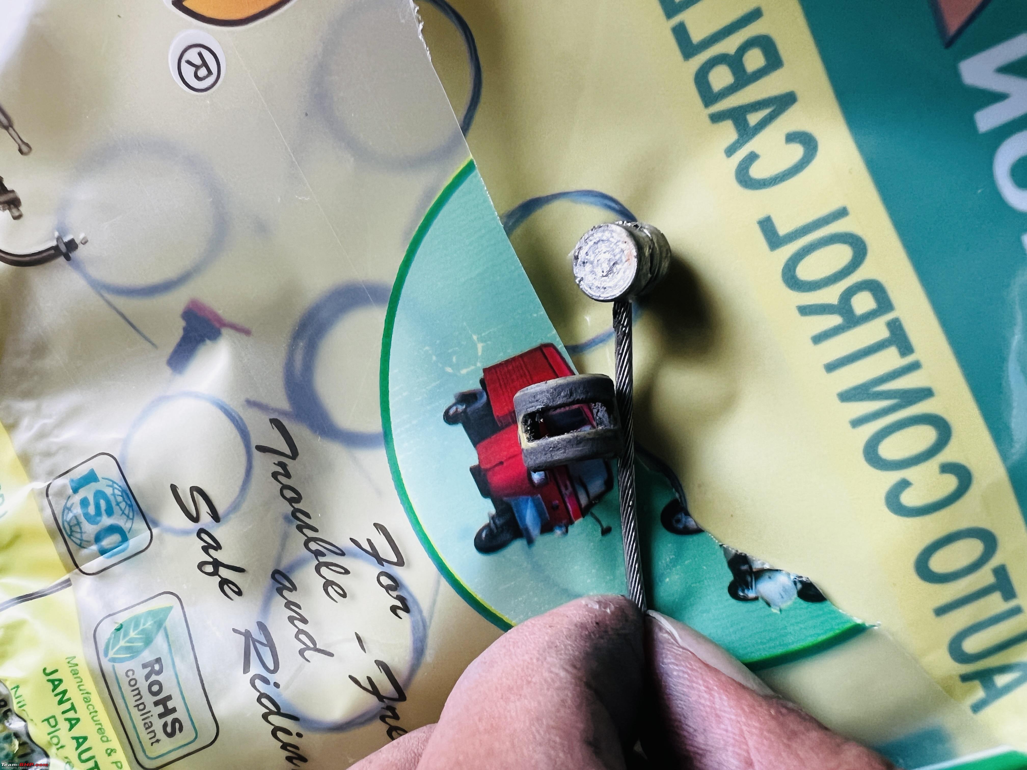

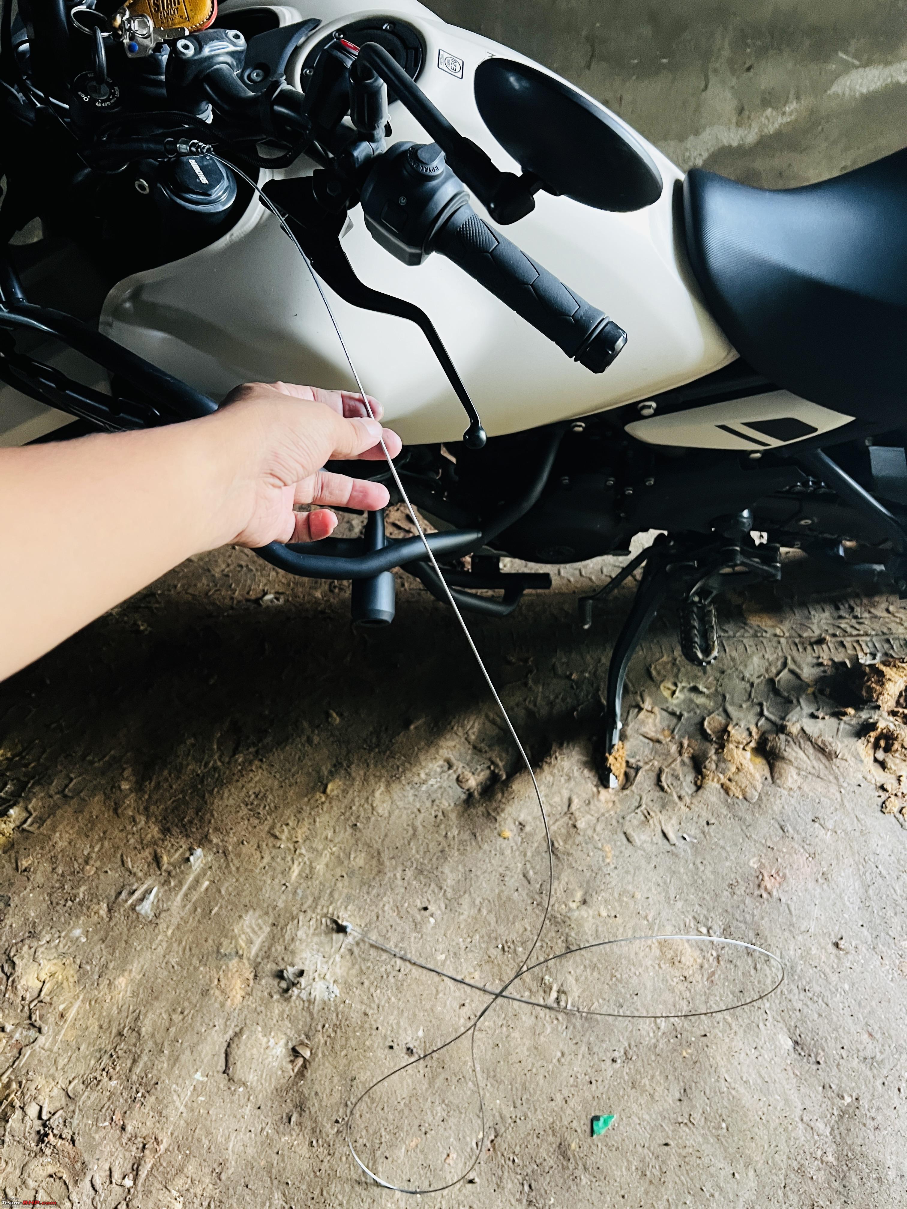

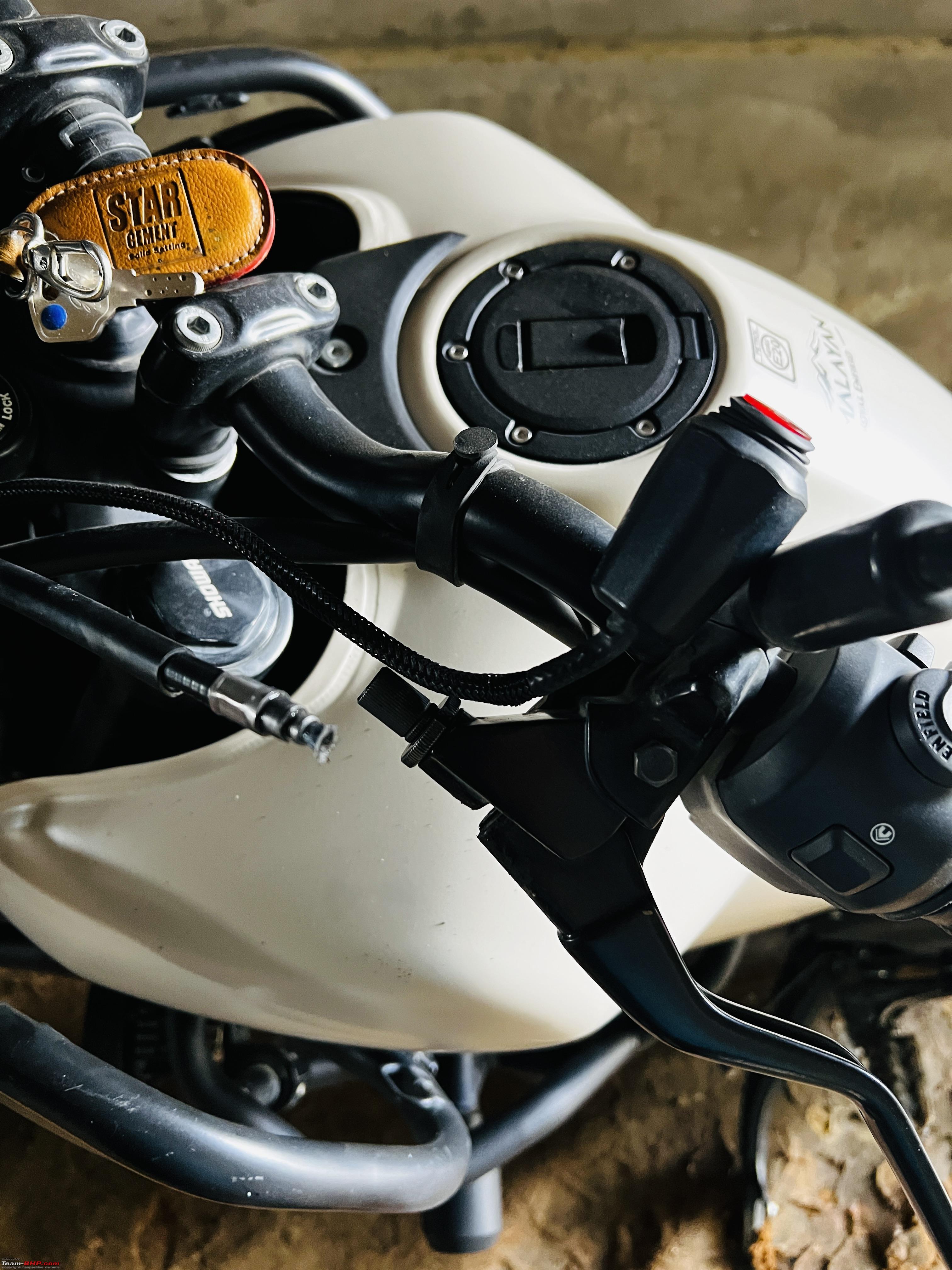

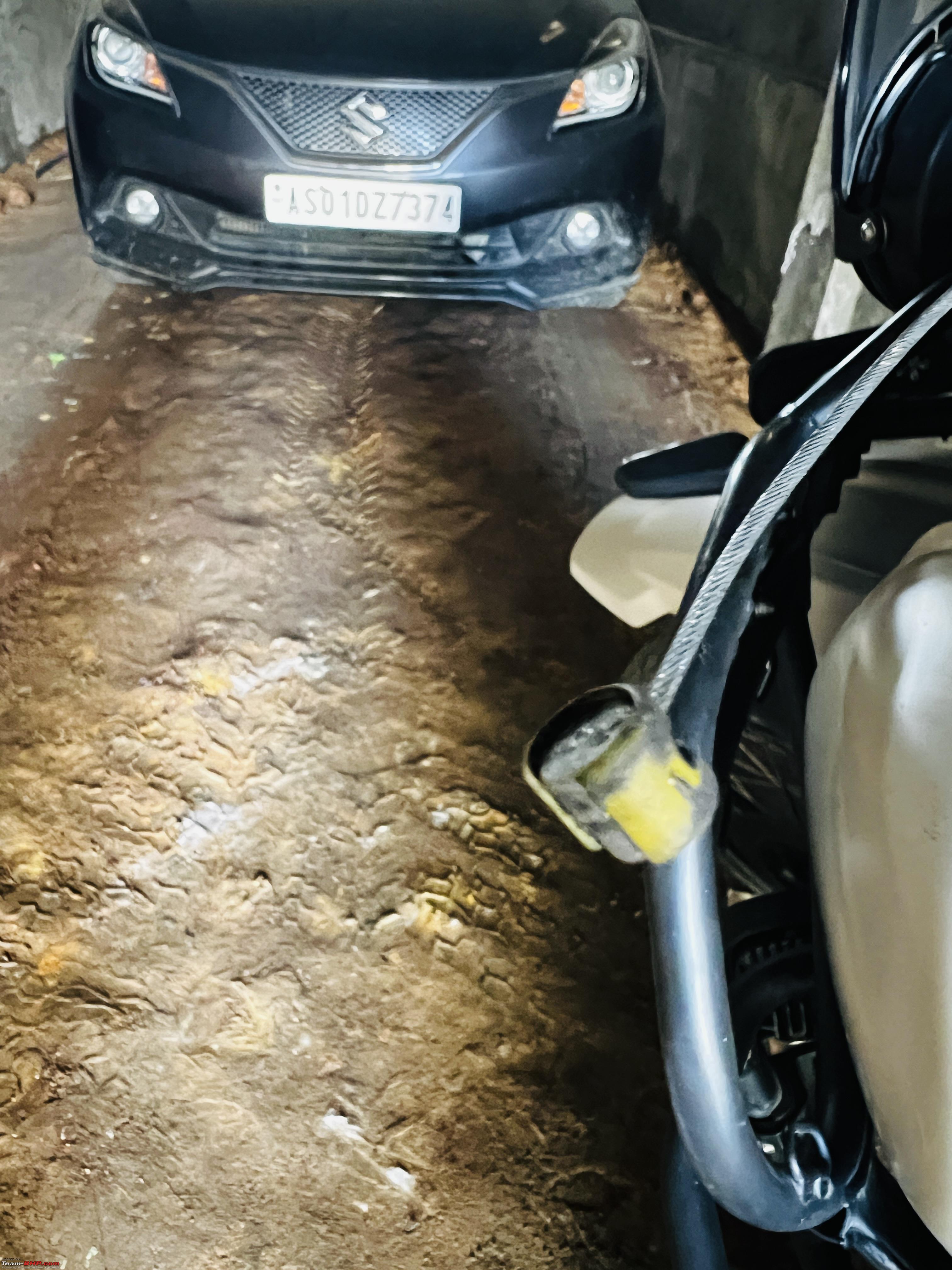

So did a cold start this morning and voila; my clutch cable gave up
Now the task is how to take the motorcycle to the workshop. Was thinking of pushing the motorcycle and putting in 1st gear and continue gear shifts with blips but later dropped the idea.

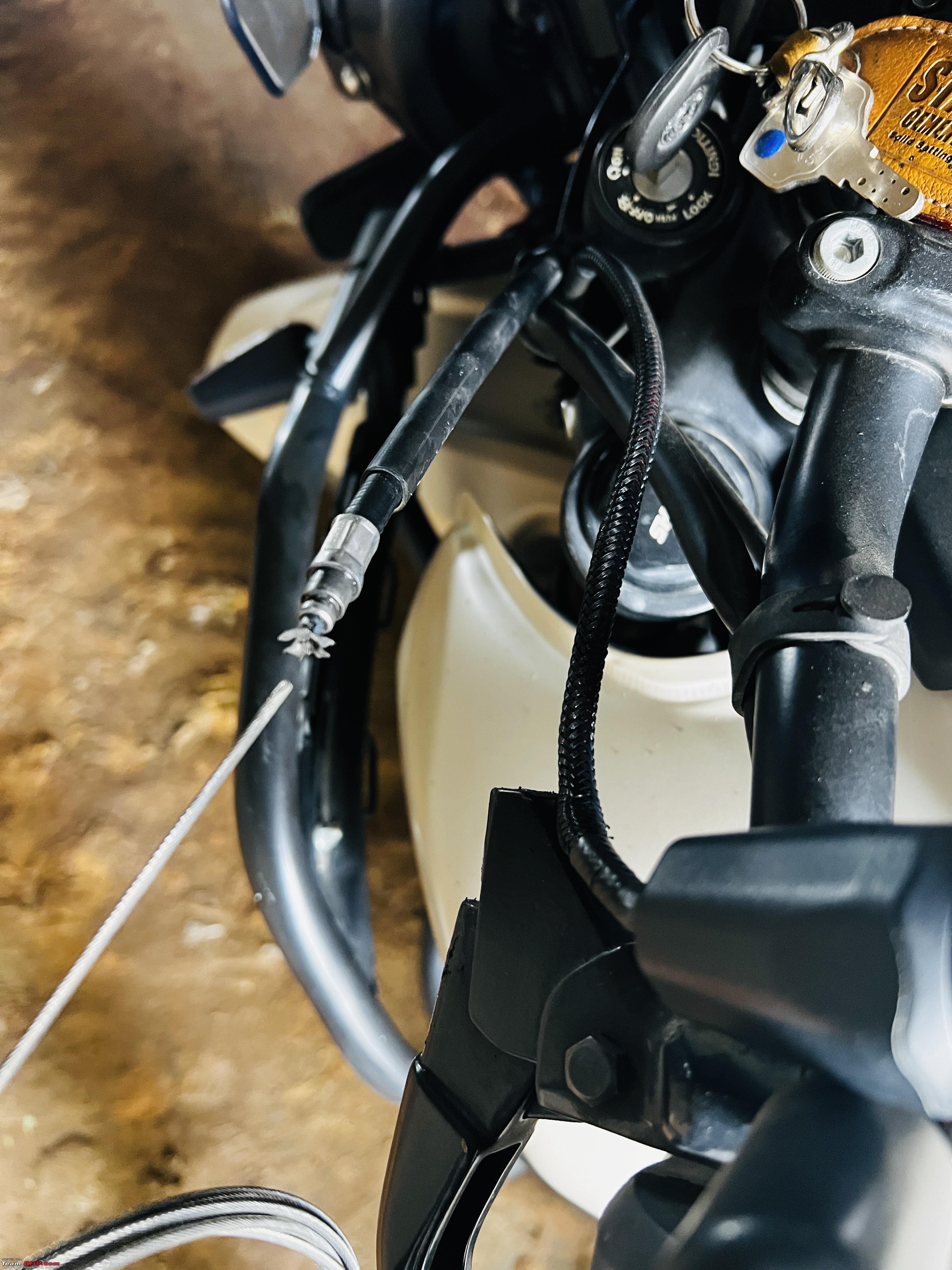

Now one idea came up, I guess most seasoned riders here use it but I did it for the first time.
I ended up using a locally sourced clutch cable meant for using Bajaj / Piaggio 3-wheelers and it worked wonderfully for rescuing the motorcycle from this situation.
Step 1: Disconnect the clutch cable from the lever end as well as the lifter arm end near the engine case.
Step 2: Hold the cable end at the lifter arm’s end with a plier and pull out the entire inner cable. Make sure that clutch cable outer shell remains as it is in its position, only the inner cable needs to be dragged out
Step 3: Take the new clutch inner cable and push the open end from the lever’s side slowly until the open comes out on the other side.
This inner clutch cables are easily available in any spare parts shop and costs ₹40 max with the cable locking nut included.
Step 4: Use the locking nut to hold the cable at the lifter arms’ end to lock the cable according to the length, the lifter arm needs to be pushed manually to the end where the clutch play ends and clutch engagement starts. The locking nut needs to be put inside the lifter arms bracket where usually the clutch cable end pin goes. The locking nut acts as a cable end pin.
Step 5: Put the starting tip of the cable in the lever slot. For Himalayan’s lever the slot is a bit wide therefore the plastic bracket needs to be inserted though the cable before pushing it through.
Step 6: Make clutch adjustments as per requirements and tie up the additional extra cable or cut it off near the lifter arms’ end as suitable.
Step 7: You should be good to go now and this cable can last for a considerable time if used judiciously till proper service / replacement is done.
Thought of sharing this as it can be a life saver during critical times in remote places.

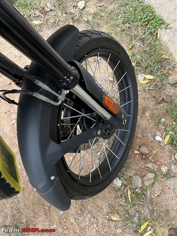

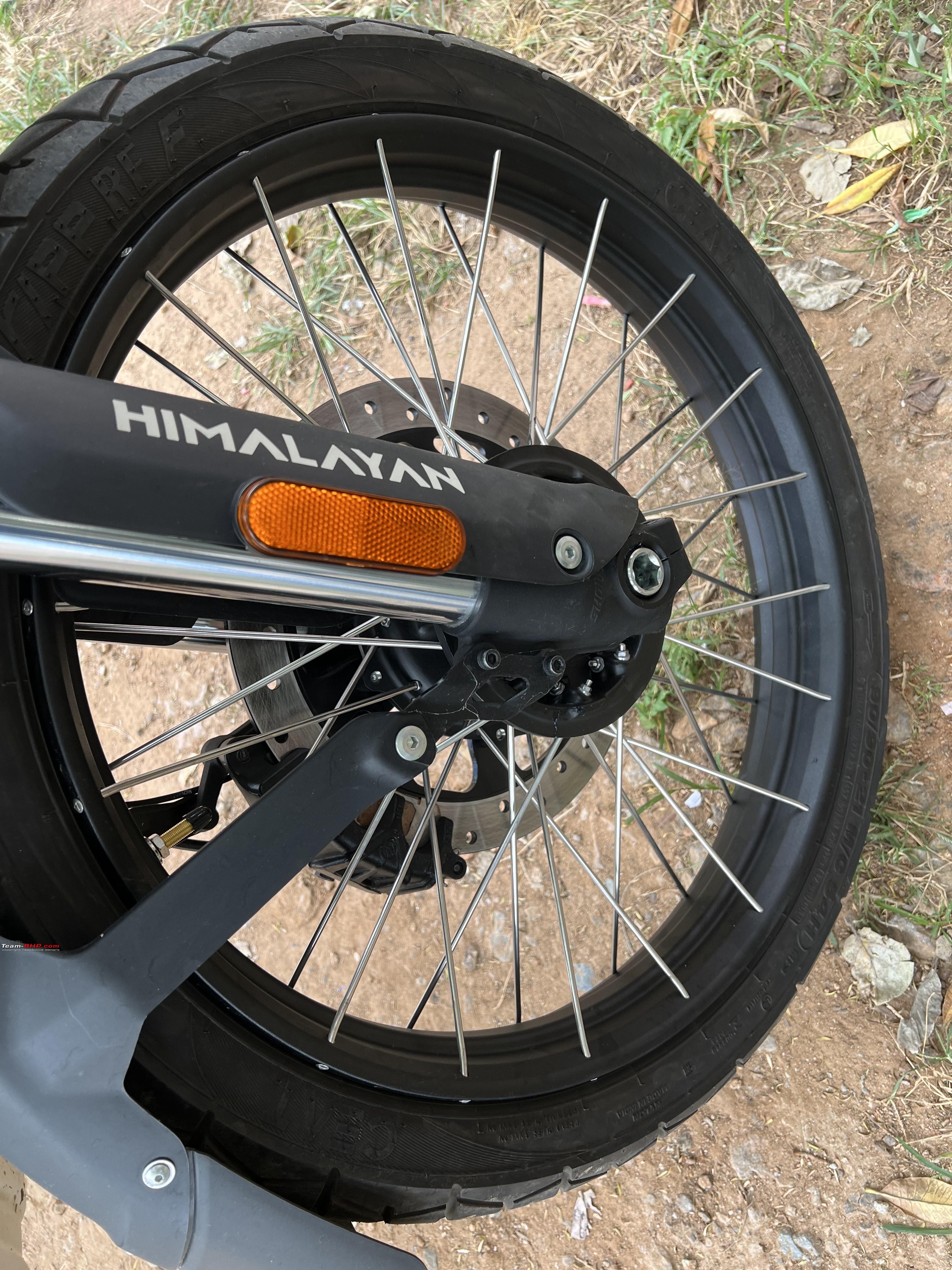

Got my Tubeless Spoke Wheels for my Himalayan 450 installed yesterday, the kit arrived 3 days back and I was told to come over the next day...only went in yesterday to get it fixed.
The kit came with tubeless spoke wheels with discs, hub, and the valve. My old wheels with disc, tube and hub were returned.
Steering the bike feels easier, may be my mind is playing tricks for now. :-)

While I can really appreciate the fact that these are finally available, can't help but wonder about the stupidity of not making them available in the beginning itself. As you can see, people are interested in this and will go for this, which will mean, the old ones will just lay there gathering dust and rust - what a waste of resources.
prakash_ajp is offline   (1) Thanks
Old 8th November 2024, 16:55   #958
Join Date: Feb 2022
Location: Erode
Posts: 175
Thanked: 361 Times
Re: Royal Enfield Himalayan 450 Review
This needs to be taken up with the Bureau of Indian Standards. They were ones who delayed the tubeless rims for India. Tubeless rims were being provided on the export models.
The rims are metal. They can be recycled / reused.
skviknaraj is offline   (1) Thanks
