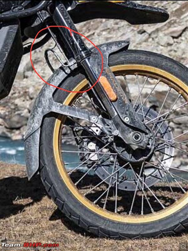

https://www.instagram.com/reel/DHi24...phaTlpbmYxdw==
Came across this video where the guy locks up his front wheel and crashes. According to the comments he has removed the front inner mudguard and had recently got new tyres, after the small jump the brake line caught the tyre block pattern grips as the suspension compressed and thats what caused the wheel to lock up.
Part of the brake line suspected to catch the tyre
Would advise anyone who has removed inner mudguard to rethink about it.

Popular youtuber Abhinav Bhatt seems to have crashed and broke his bones in a similar way, reading through the comments. Seems like a design oversight on a motorcycle designed to go off road. It's inevitable that the customers might remove the main fender for more hardcore trail riding and not to get dirt or mud stuck in between the tire and fender.
EDIT: Found a video about the incident.

What a conundrum. Keep the inner mudguard and let the tyre get caked with mud and not move or remove the inner mudguard and let the brake line lock up the front tyre.

Any particular reason as to why they have the caliper and rotor on the left side in the first place?
I'm just noticing this on this bike. I can't recall seeing a single disc bike with rotors on the other side (of the brake lever); which to state the obvious has what caused this complicated brake line routing. This must've also asked for a different hub and forks design, I suppose. So, they seem to have really made an active effort to do this. But I can't think of one reason.
Any ideas?

Honestly, no idea. Last gen 390 ADV had brakes on the left side as well but no such weird looping of the brake lines. This is usually reserved for twin disc setups. Unless they were developing the twin disc 750 and 450 Himmy alongside and decided to share some braking hardware between them.

I looked up a few bikes; and as it turns out, I'm just poor at noticing things. Except for the current gen, KTM's road bikes alone for some reason, have had front brakes on the left side- from the very first gen! The last gen 390 ADV, being not a committed attempt from KTM in making an ADV, seems to have just adopted this. Glad to see this is not the case with the current gen.
Even if RE were developing the 750 and this 450 together, the hub and fork designs would differ between single and double disc. If at all there were a good reason for RE to not consider the widely available designs- which sport brake on the right side- and to instead borrow the 750's wheels and hack it up to support just a single disc, chopping the wrong side off would be the worst type of over-sight for RE to have made, and continuing with complicating the brake line routing on top of it.
I couldn't find any reason from the 20-minutes-or-so browsing, except for the Google's AI thing claiming it is for 'balancing weight distribution', for which I can find any credible sources.
