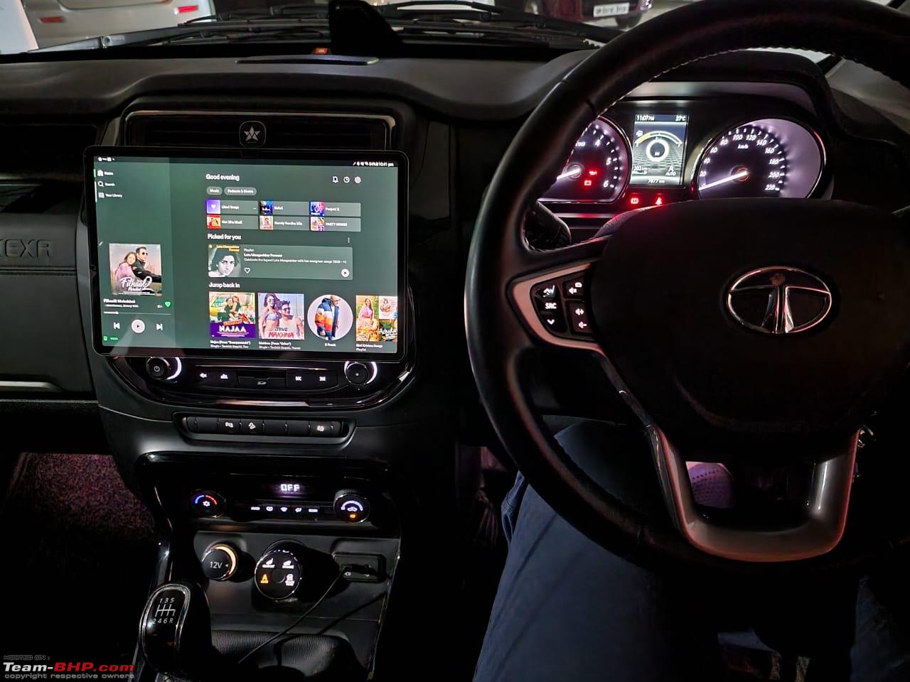

Congratulations on finding a gem, I would take this opportunity to introduce you a wild idea to infuse some freshness to an otherwise great car.Tata Hexa : Official Review-hexa-infotainment-.jpeg
GT_424038 is offline   (2) Thanks

Is this an infotainment system or a tab? Creates a premium appeal, how is the audio quality?
It's a Samsung 12.4 inches tab mounted on blackstar magnets.
