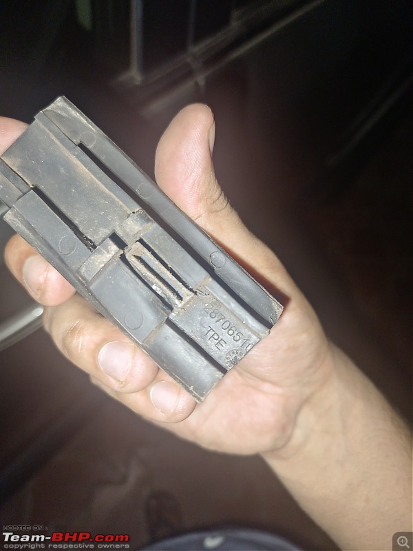

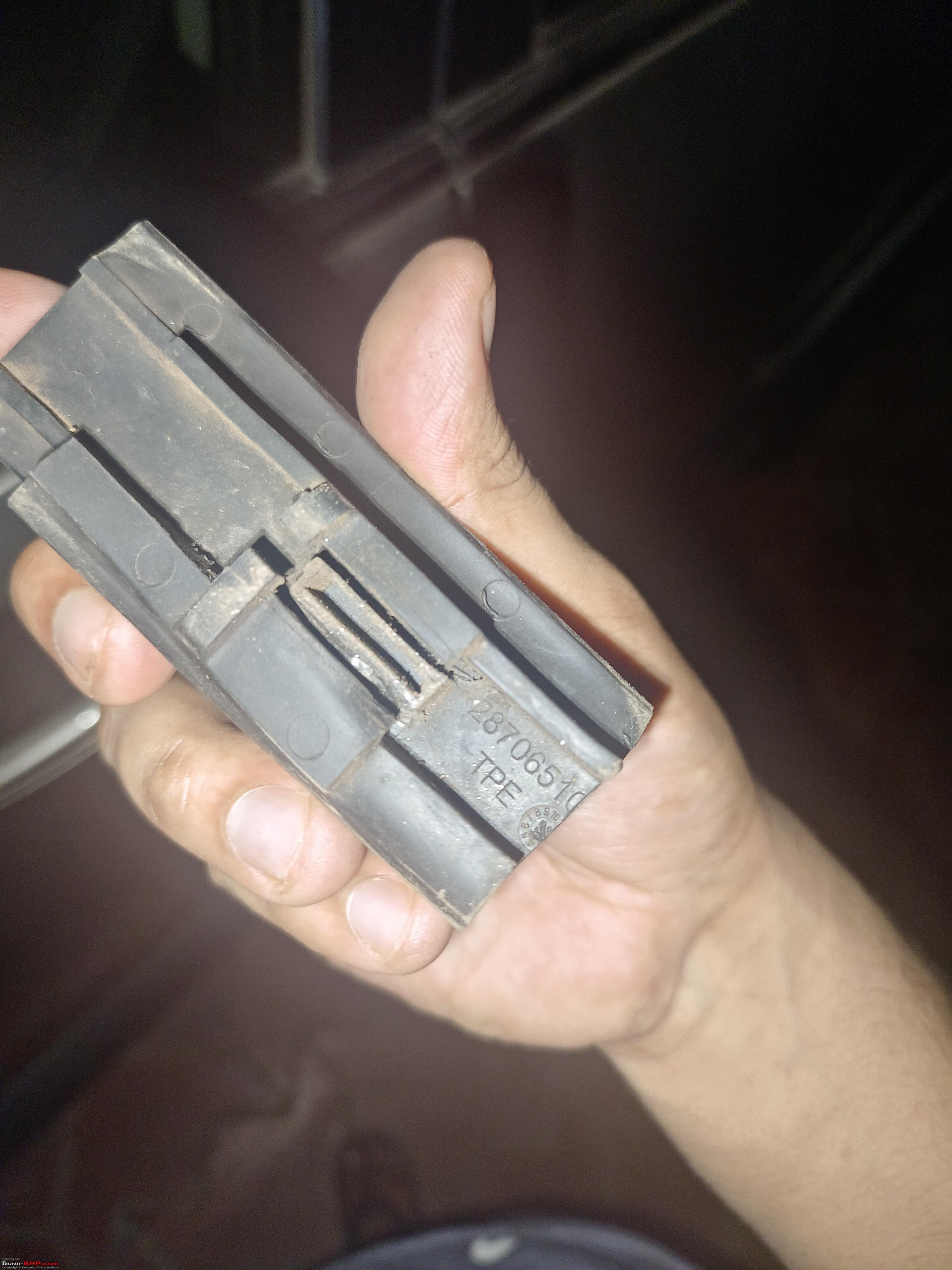

Originally Posted by smsrini View Post
I had to get my windshield replaced due to a stone hit on the highway.
Now the right side plastic trim on the windshield has become loose and is coming off.
Has anyone got it replaced and if yes, can you share part numbers ?
Hey! Did you happen to change the rubber part at the top as well? Somehow the part on my car came loose and I lost it, I wonder where.
I couldn't find a replacement part on Boodmo, and Tata service centre keeps ignoring my requests to provide me one. (I guess it's low priority for them)
But without this part, the plastic trim comes loose while driving due to vibrations and starts rattling.
Can somebody help find this part?
Attaching images from the left side for reference.
