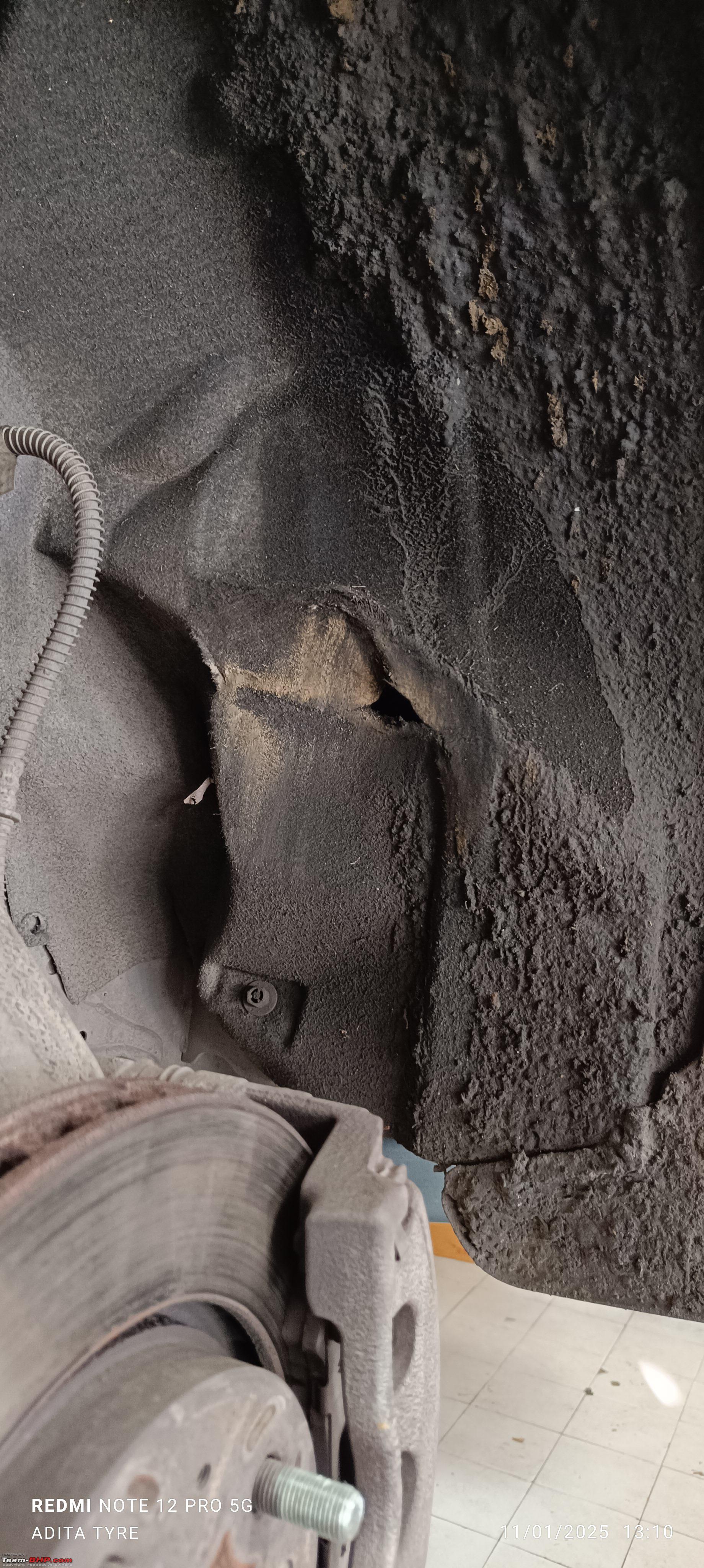

Originally Posted by Ameeth View Post
I kept noticing this sound right after getting the delivery of the car in June-2023.
I did point out about this sound on every visit to the Service Advisor as well as the Mechanics at the MASS. They couldn't find anything wrong anywhere.
But, today it seems I have found the culprit. The sound seems to be coming from the front wheel arches due to the scrapping of the fender liner with the tyre. There are visible marks of damage on both the fender liners, which will have to be replaced. This problem can be attributed to the fact that fender liners are of felt material, which become heavy once they get wet and after accumulation of dirt. The clips meant to hold the fender liners are unable to do so and it results in hanging fender liners resulting in scraping of the same with the tyre.
Will keep posted of the outcome after the MASS Visit.
Attaching the pics of the damaged fender liners.
Got it replaced today.
