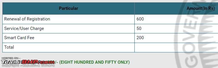

Re: Fiat Grande Punto : Test Drive & Review
It was done last year. I checked again on Vahan itself. It was 850 for the renewal, and 1000 for the environmental tax.
Fiat Grande Punto : Test Drive & Review-renewal.jpeg
It was a pretty simple process and just needed to have PUC certificate.
