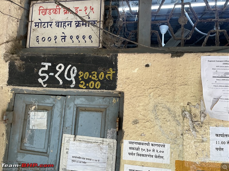

I checked on Google, which said the RTO office opened at 10 AM, so I reached at 10 A.M. and was directed to window number 15 in the E Block . The window was closed and timing at multiple places was written as 10:30 AM to 2 PM at two places. It was written as 11 AM to 2 PM.

I am attaching pics of the closed counter E-15, the form with information which I had to fill there and form 35 stamped from B-11 counter (Prosecution window).
