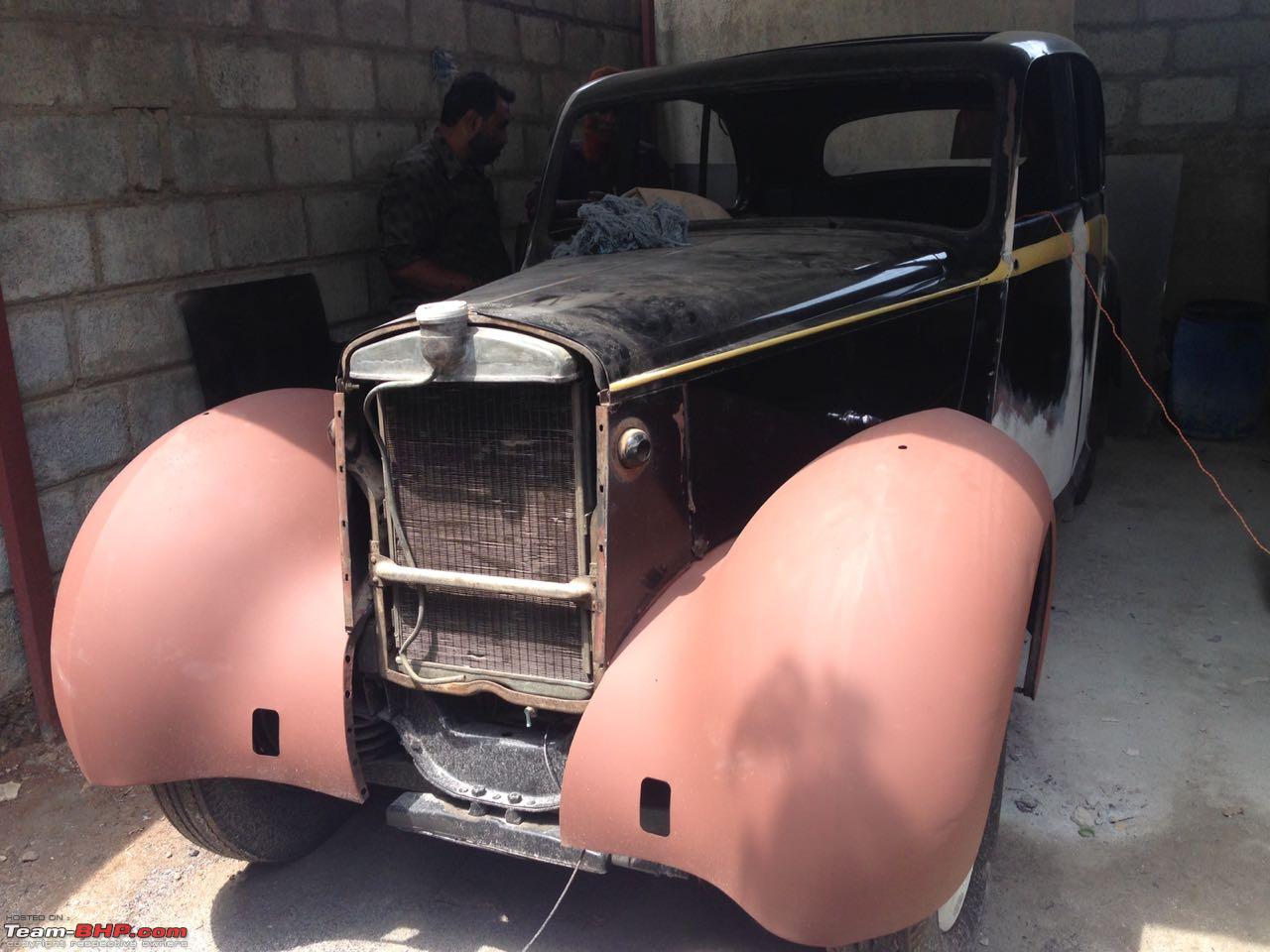

The Daimler is off to get new paint job. Will paint the car a combination of black and white. More updates as we start our work

Why has the plated trims of the front grill been lift on ?? Wouldn't the paint job been easier with those off ??

You may recollect we had fitted the panels back, to check the body alignment. We will remove the same when the painting starts. Just that it is easier to transport a whole car.

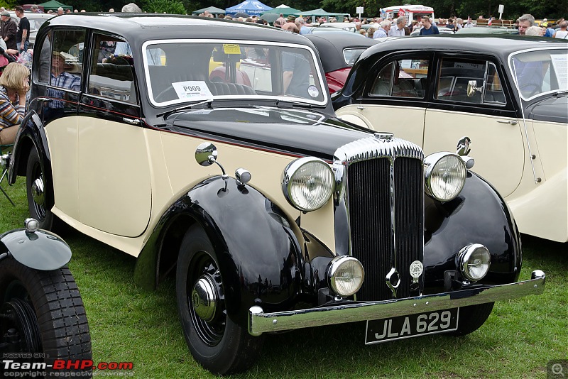

More an English White (Creme) as seen in the picture below
Picture sourced from the net.

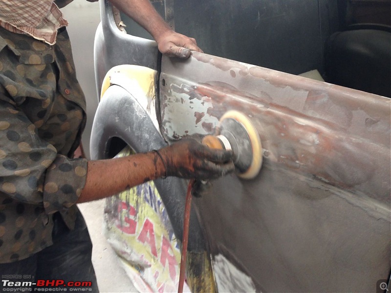

Here is the device in action for removing the paint

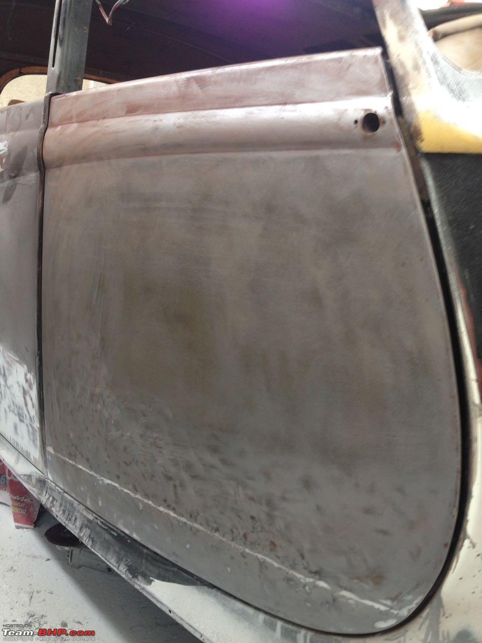

The door, after the paint has been completely removed. You will notice the absence of any swirl marks on the surface, as we used softer disks to remove the paint.

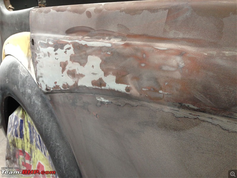

The yellow portion has "Japan Putty" applied in the past! This was something new to me. I understand that this is very hard putty and that is why it was preferred in the past. Unfortunately it retains water and cracks when it dries out over the years. We had a lot of small cracks in the yellow paint.
To rempve the hard Japan Putty, we need to more than a few iterations with this device.
