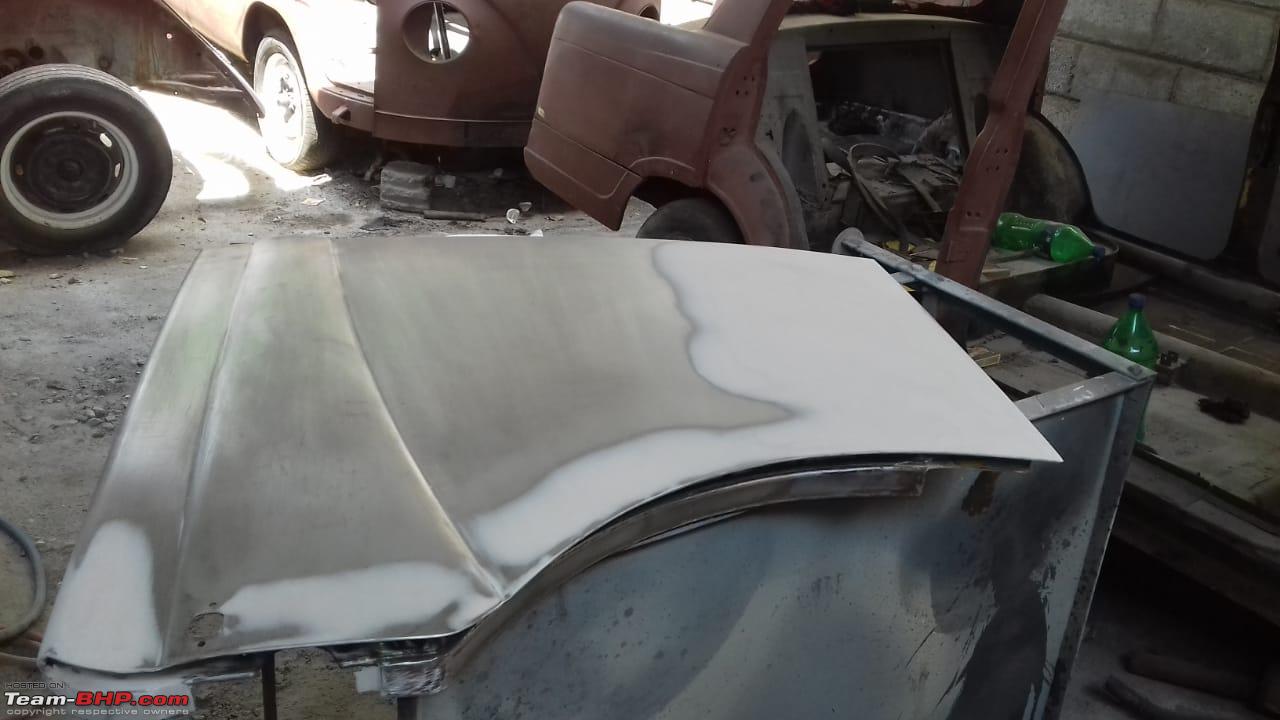

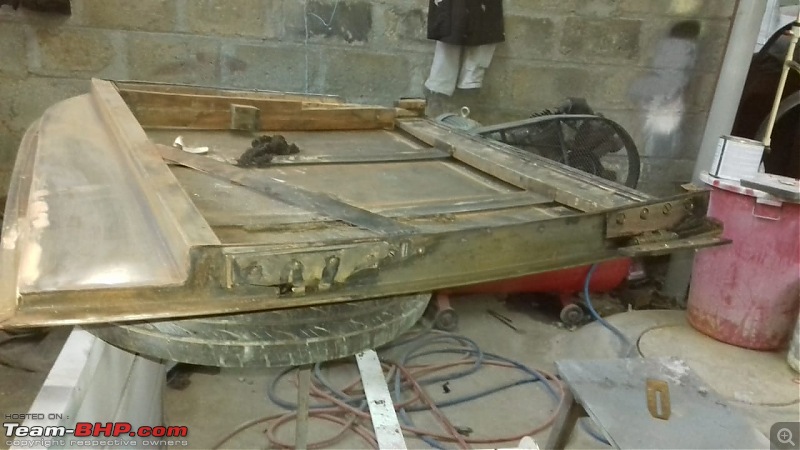

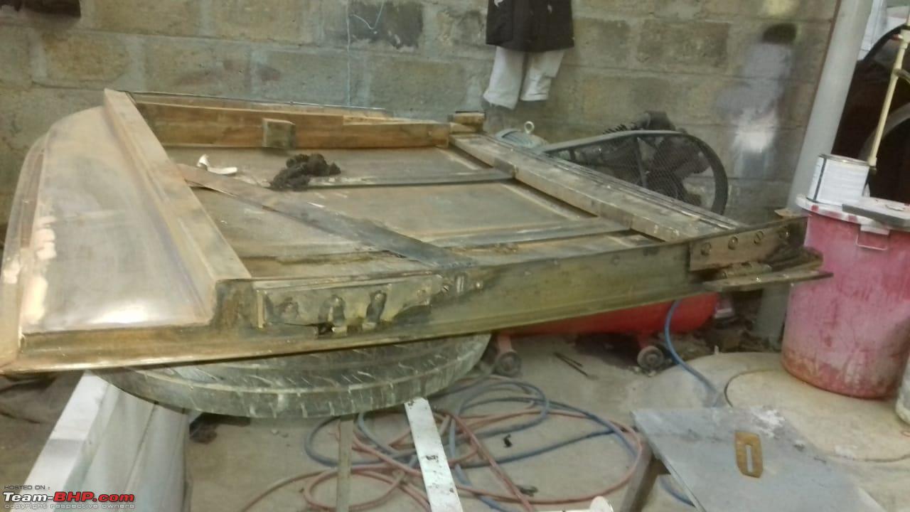

The removal of paint on all the doors has been completed
Redoxide paint job done to protect the metal

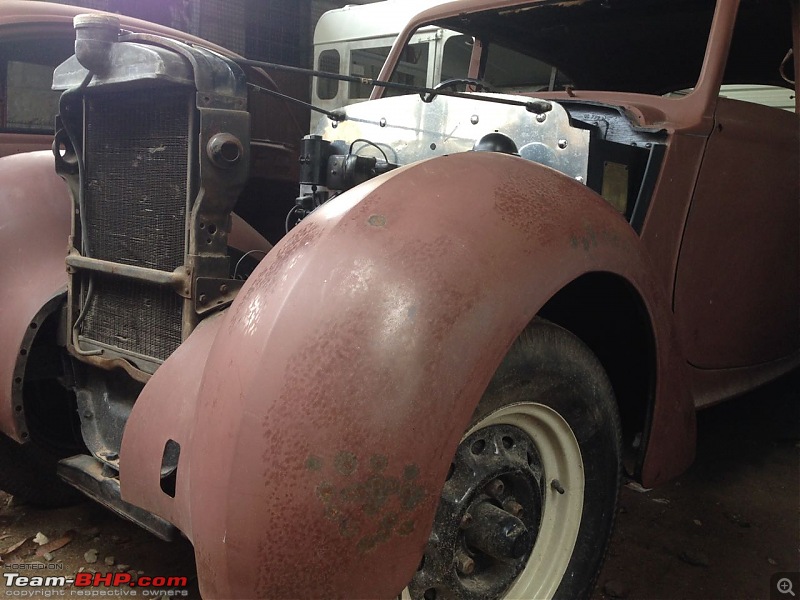

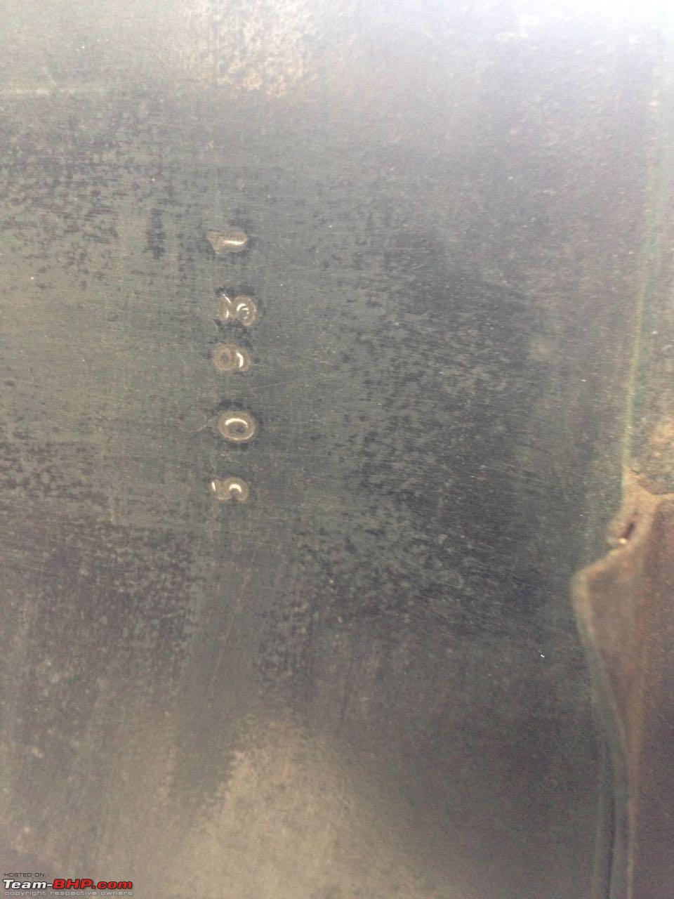

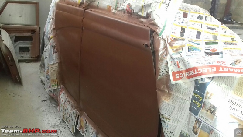

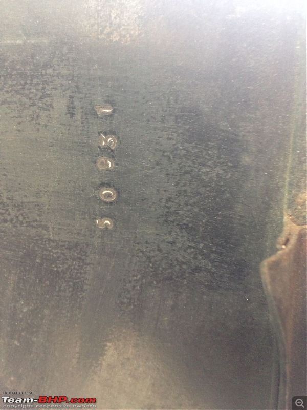

Now work is starting on the bonnet. Where the arrows are marked, we note that the chassis number has been punched.
The numbers on the bonnet are matching to the chassis numbers.

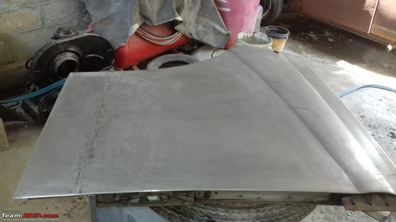

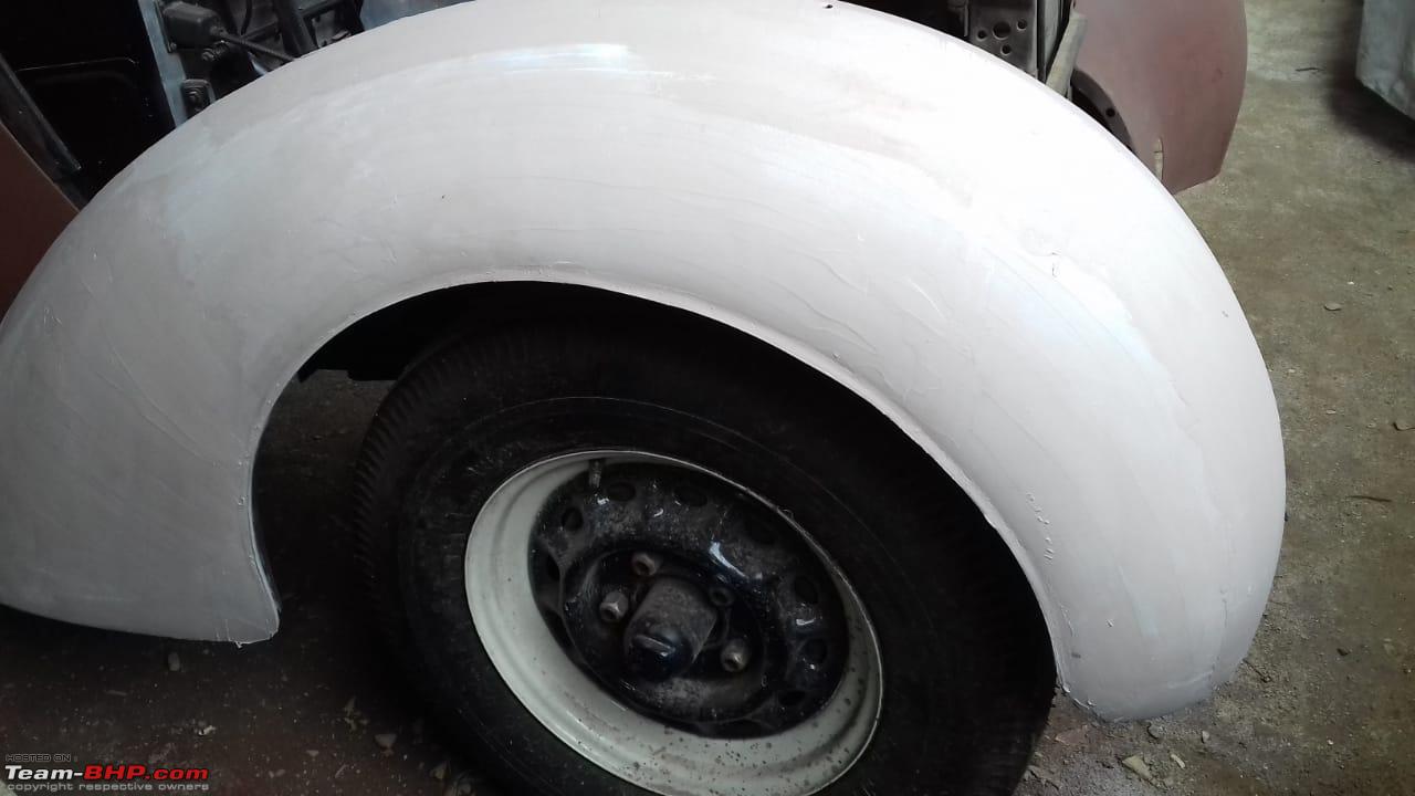

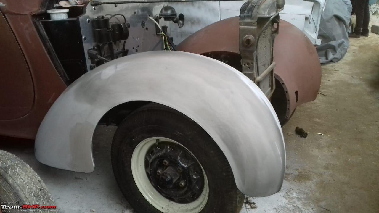

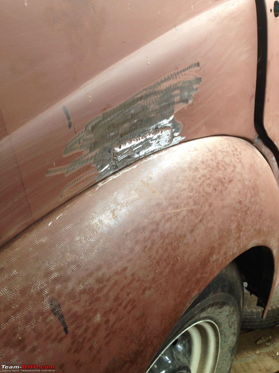

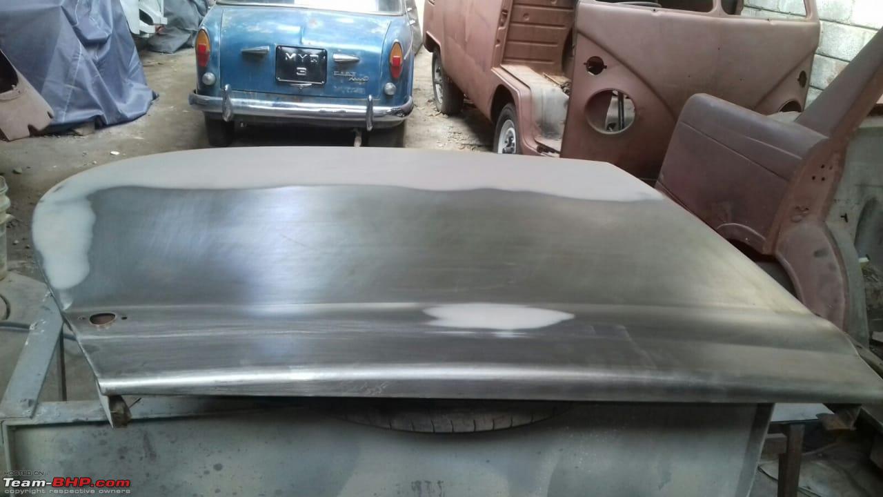

We have completed the tinkering and tapping of the car. The next stage we will start the paint job.
The tapping work can been seen on the front fender
Tapping on the rear fender
Work on the doors and cracks were fixed

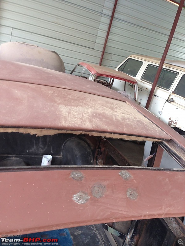

On the front roof there seems that in the past, there was a mast or light mounted. The was closed as we have no idea as to what was mounted in the past.

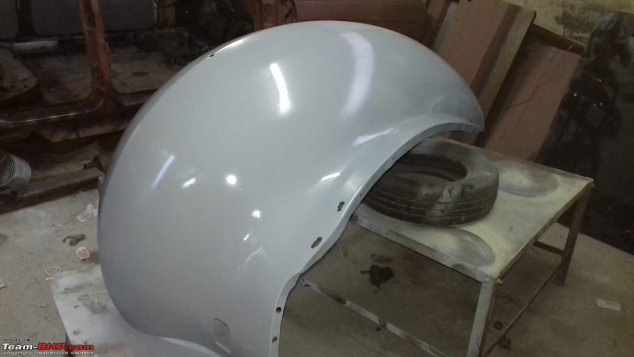

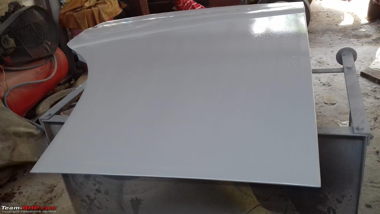

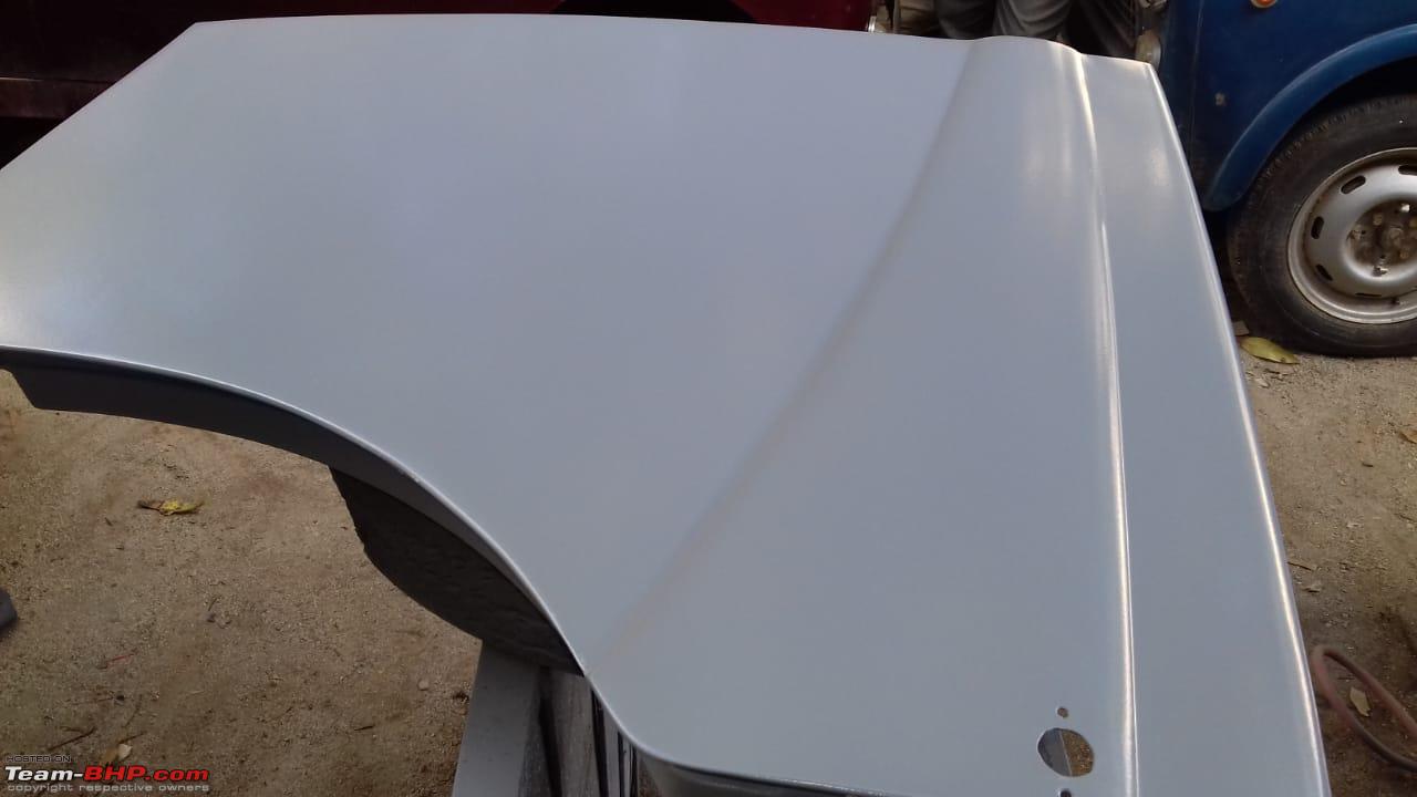

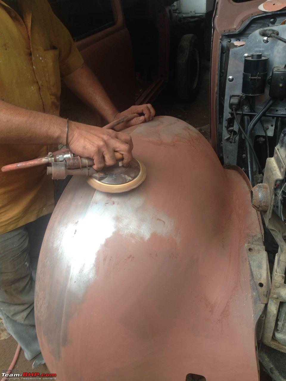

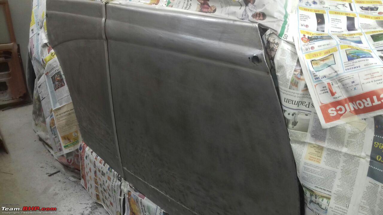

Post completion of tinkering, the putty work, sanding and primer work has started in right earnest.
Removing the redoxide
Putty work
Sanding
Primer application

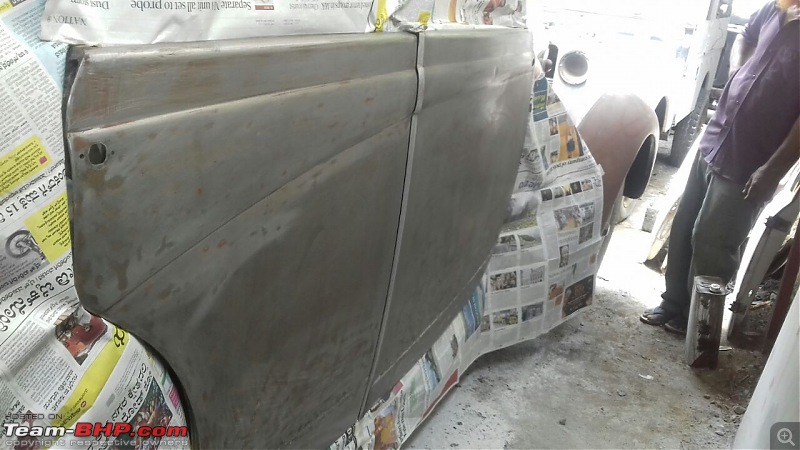

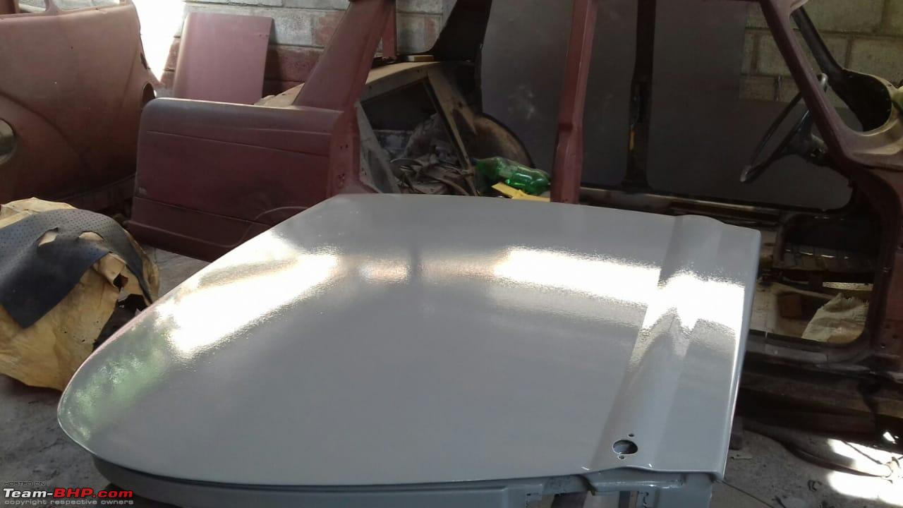

More pictures of the work on the doors.
