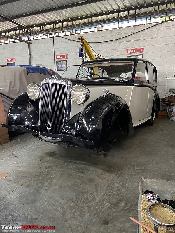

Here is the first glimpse of what the car looks like! Always the finishing take time, as we get to detail the car more extensively

The headlights look fantastic!

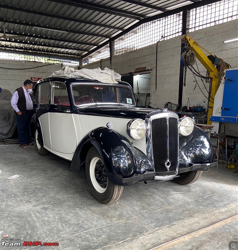

The original chrome has polished up very well.

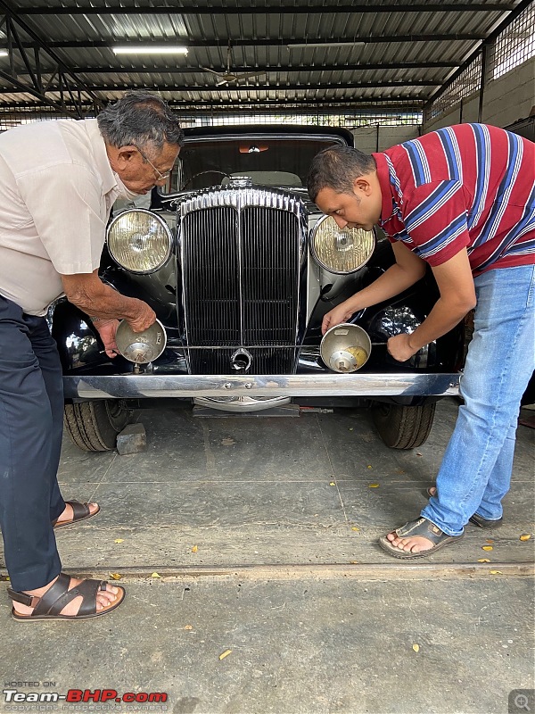

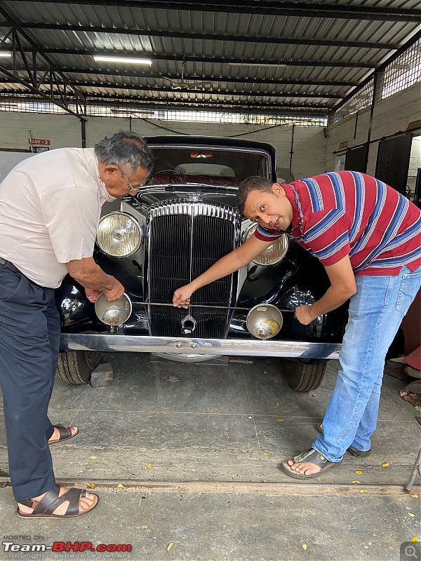

More updates

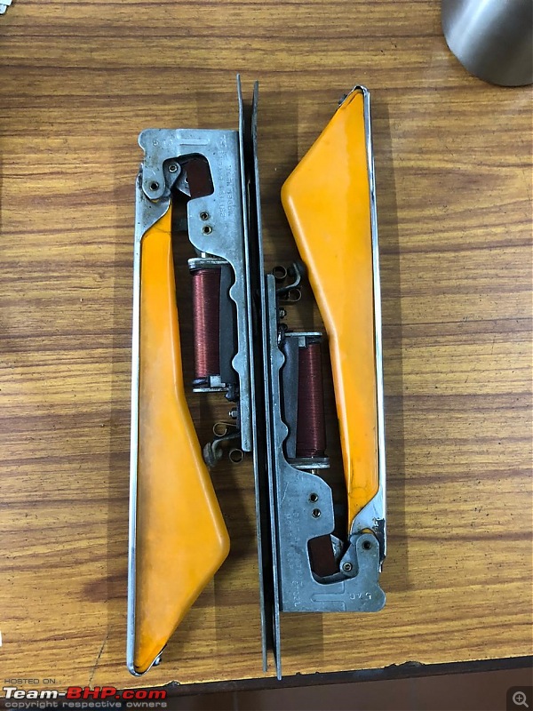

The Lucas semaphores had survived well and after a mild refurbishment were fitted back

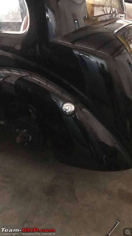

As Chris says " the fuel cap and filler pipe was fitted to sit flush on the body unlike before. Sounds like a small fitting, but we had to remove the tank, do the measurements and then refit without anything showing except the fuel cap"

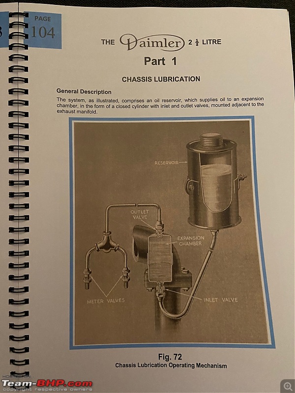

Sharing with you a lubrication system for rear shackles and steering linkages.
As seen in the car, the expansion chamber
Details from the manual

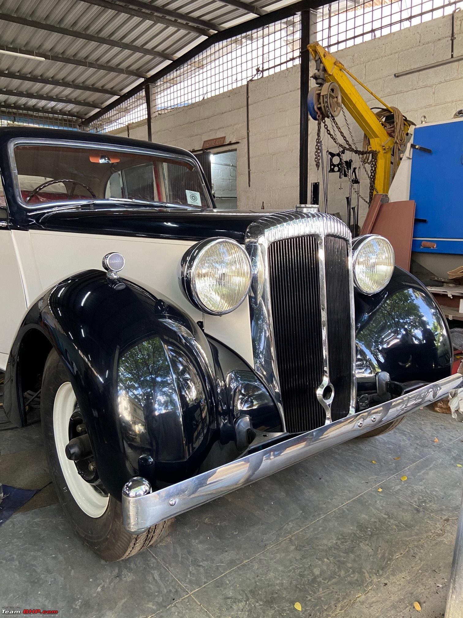

With the bumper fitted. We have not chromed the bumper
Post COVID, we would probably take up the chrome work

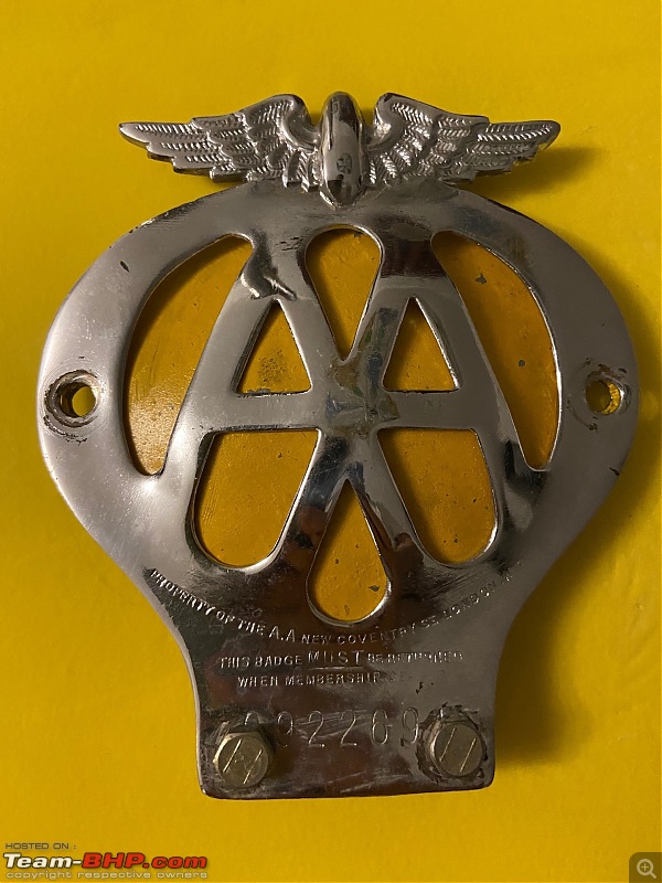

We decided to go for 4 badges. The first 3 were easy picks
DLOC Badge
KVCCC Badge (old type) which came with the car
The AA Badge from UK

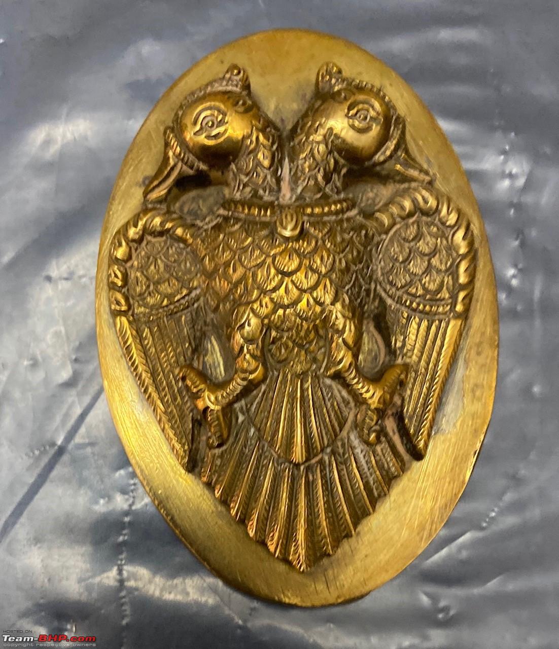

The Gandaberunda was gifted to me and we debated to have it on the badge bar as the 4th Badge. But we all agreed that it is more like an ornament and should not be part of the badge bar

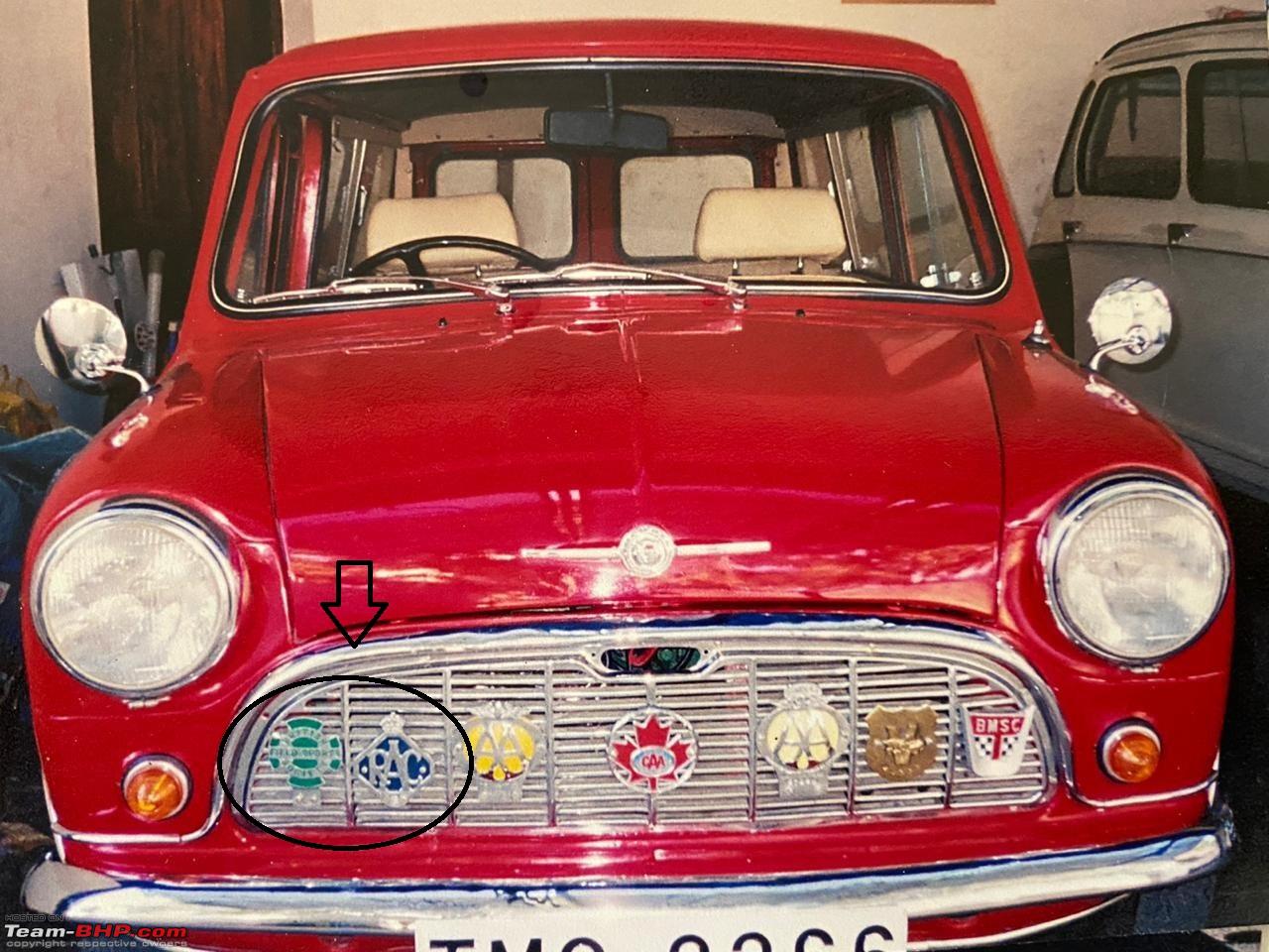

Old 2nd September 2020, 23:41   #206
Location: Ann Arbor
Posts: 2,579
Thanked: 7,151 Times
Default Re: Daimler Tales - 1947 Daimler DB18 Luxury Saloon
The 4th Badge will the choice between RAC and British Field Sports. RAC was decided against, as it has been duplicated quite a bit
Attachment 2049826
KPS
The RAC badge in this photo is not "period" for the car. It probably dates from the 1970s.
travancore is offline   (2) Thanks
Opted out of RAC!

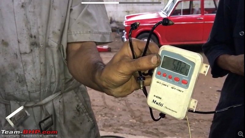

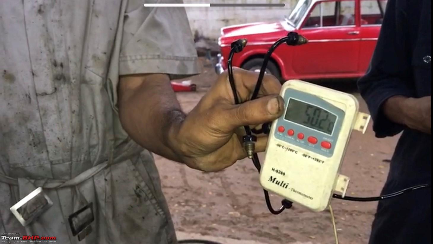

Engine tuning, adjustments and overall checks are being done
Adjustments being done
Engine is checked for signs while running
Temperature is monitored, a good indicator on the health of the engine
All is well!
