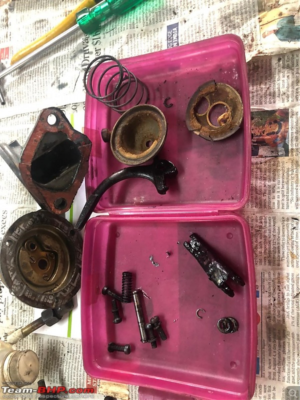

Chris has opened the garage after the lockdown was eased. The car has had much progress

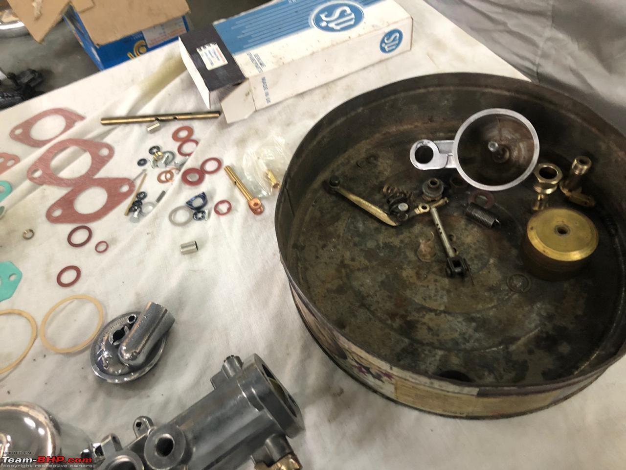

The SU Carb was rebuilt before mounting on the engine

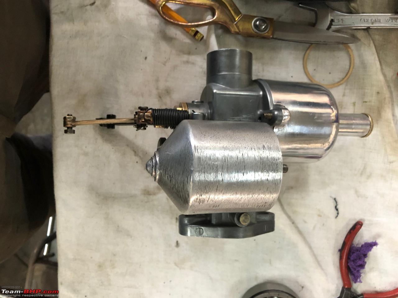

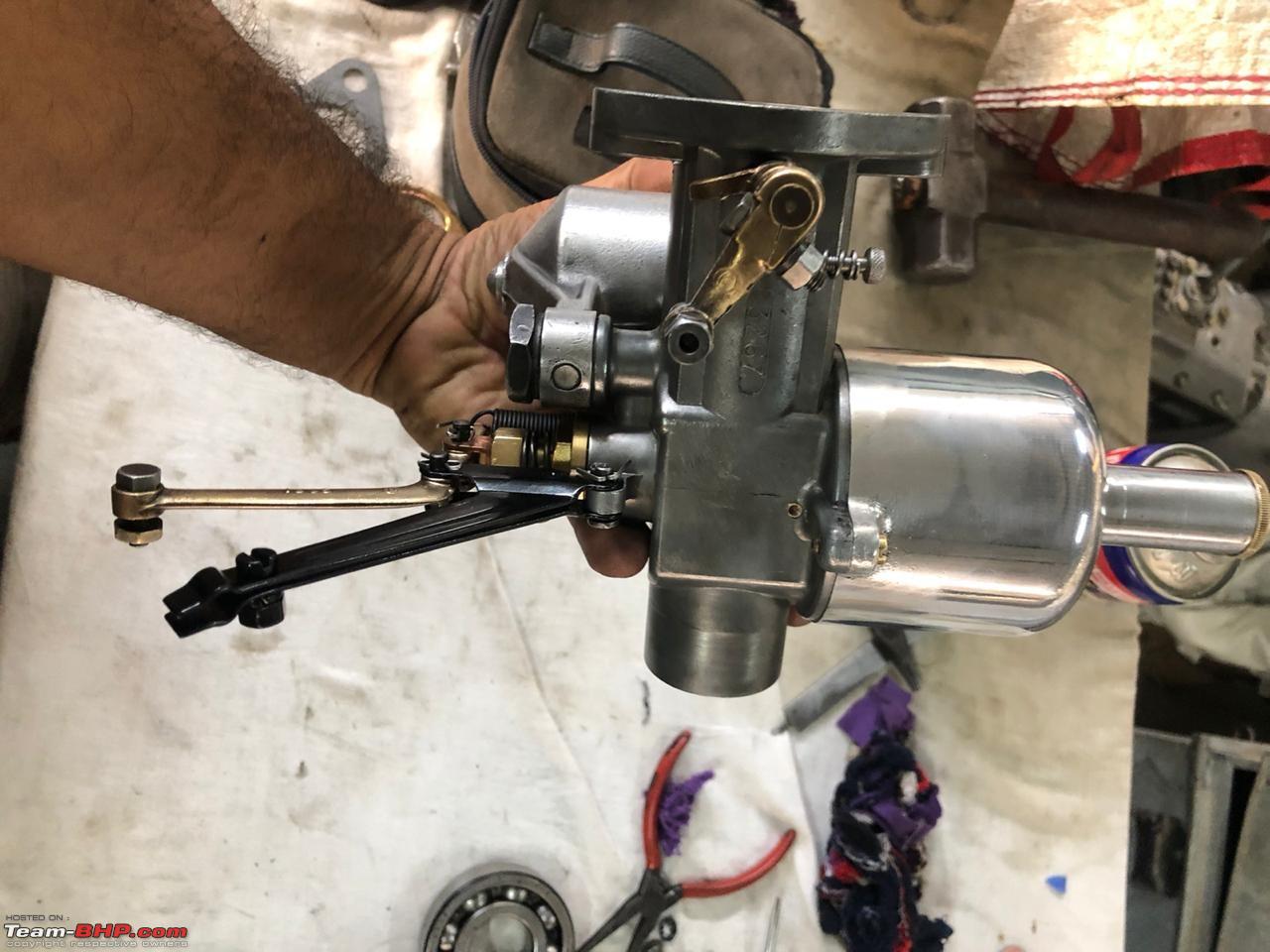

The rebuilt carb

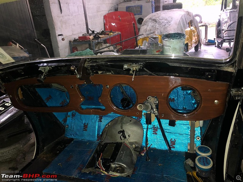

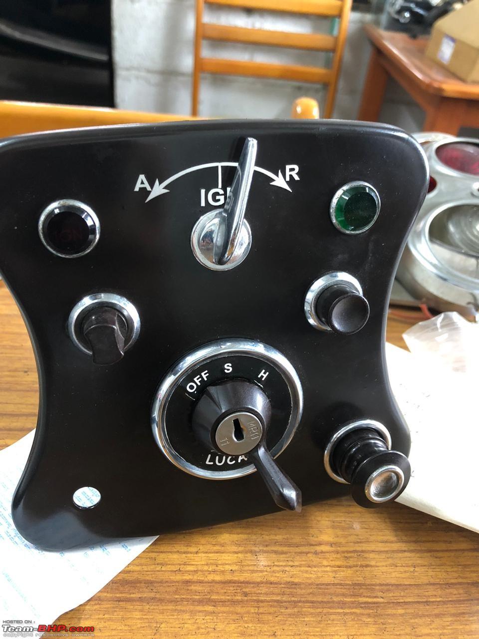

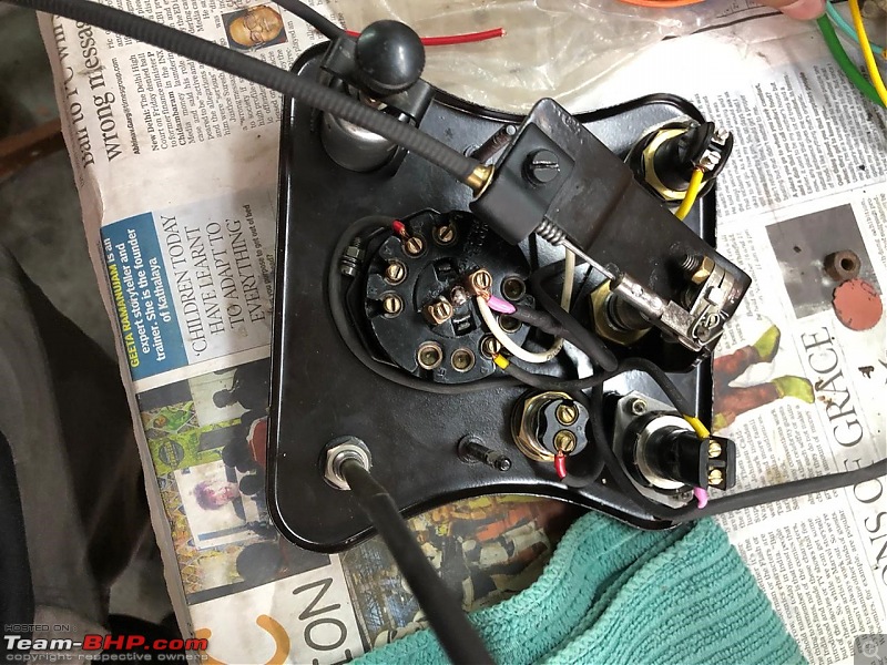

The dash board is slowly coming together. The cigarette lighter is very rare to get and very similar to that on the Rolls

was able to get the jewel lights too. Advance/Retard, panel light switch, starter button, keys withing the light switch and the cigarette lighter

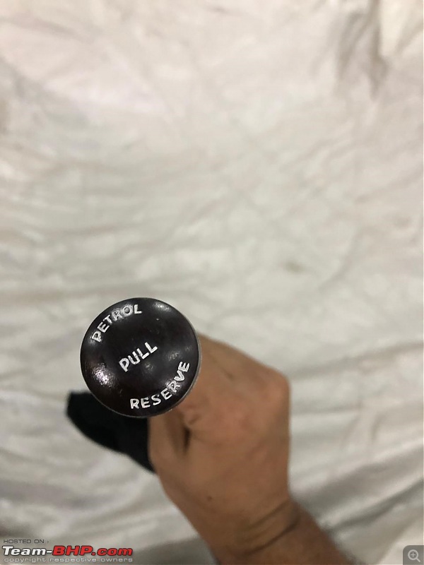

Pull knob for fuel tap

The dashboard wood

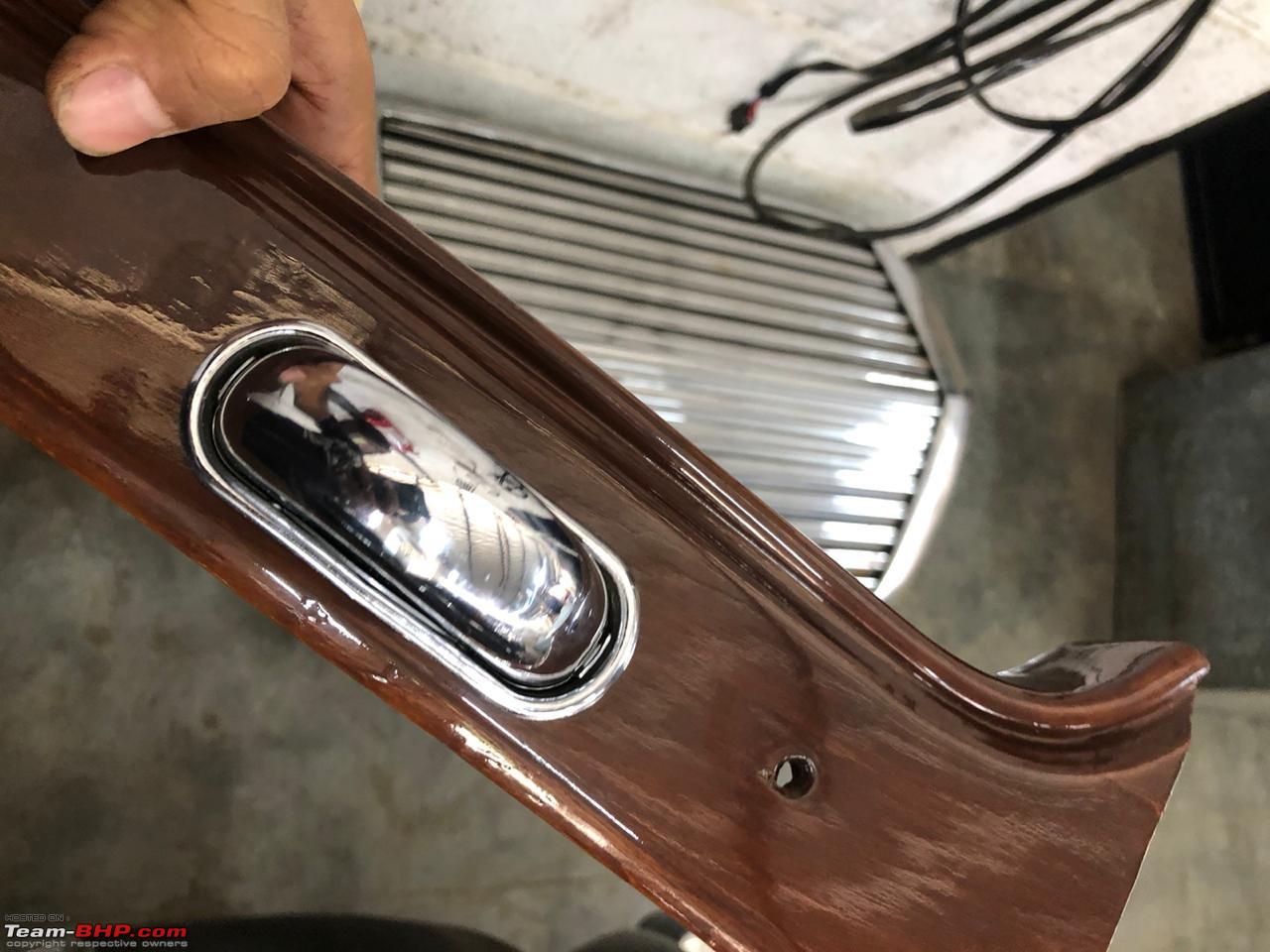

The ash tray fitted on the top wood panel of the dash

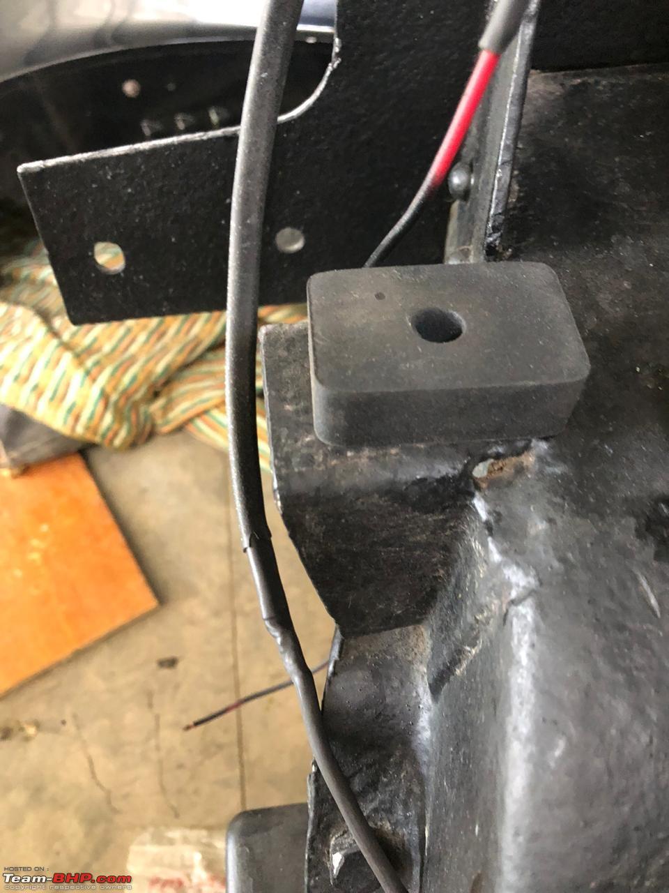

The radiator holding frame
New rubber bushes for the radiator base. That is not rust, but just dirt, which has been since cleaned up

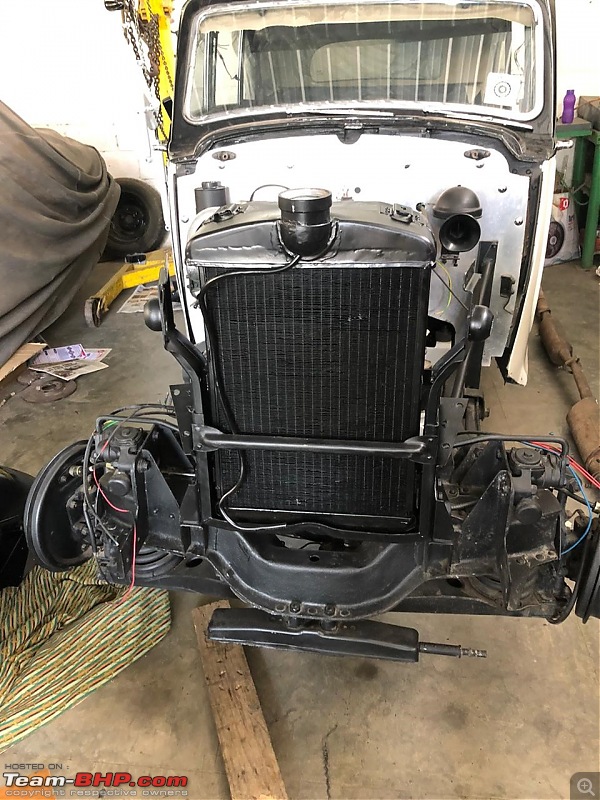

The frame is fixed
The radiator is fixed

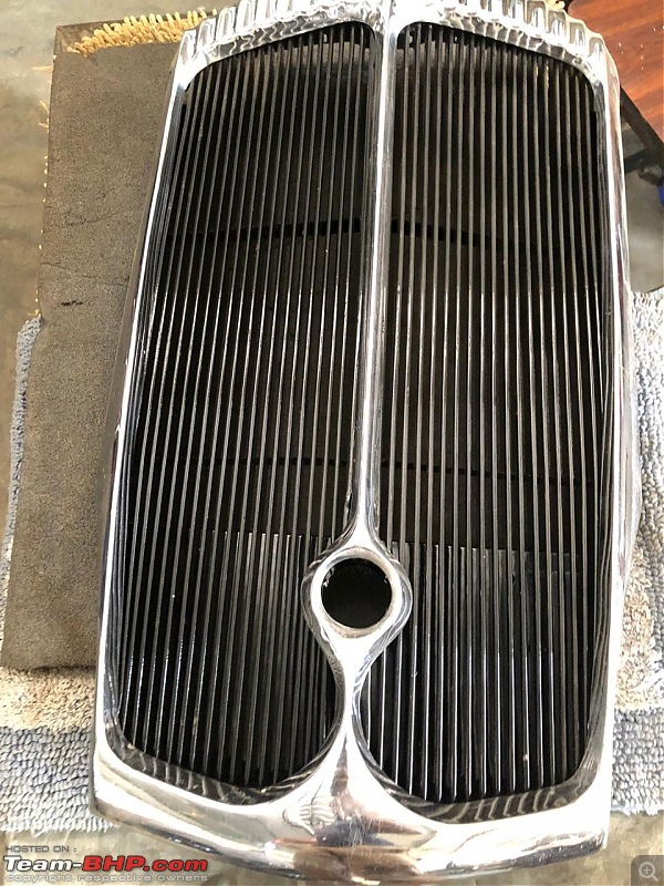

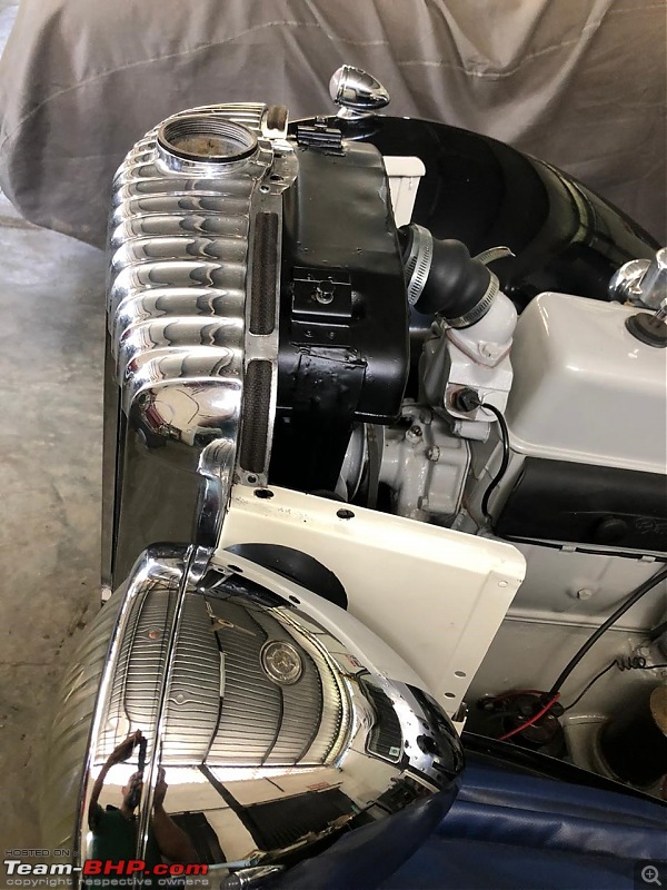

The grill is ready to be fixed. We are preserving the existing chrome
The cars is slowly but steadily getting completed

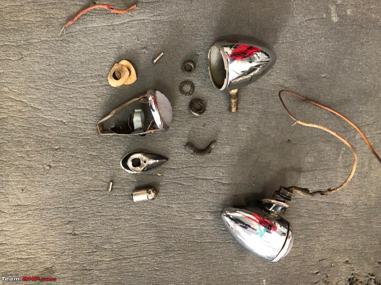

The Lucas "King of the Road" headlights and the matching fog lights and correct park lights are an important part of the car.
The lights we completely disassembled for the clean up

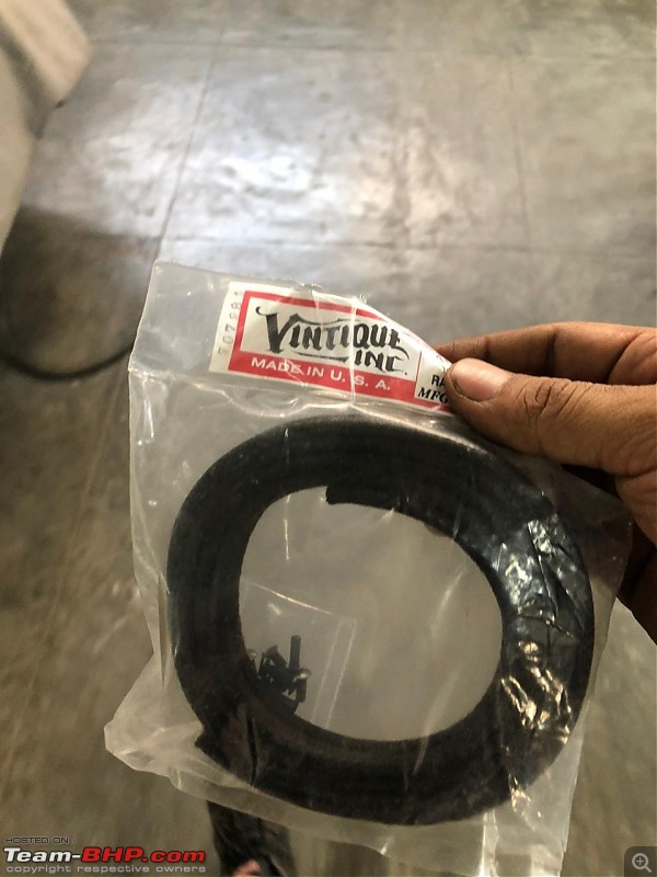

New Rubber seals where ever possible

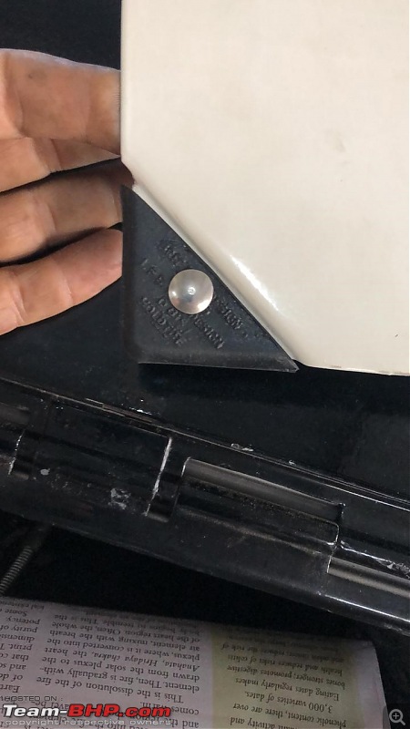

The corner bonnet rubbers were fitted with chromer rivets

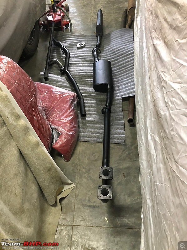

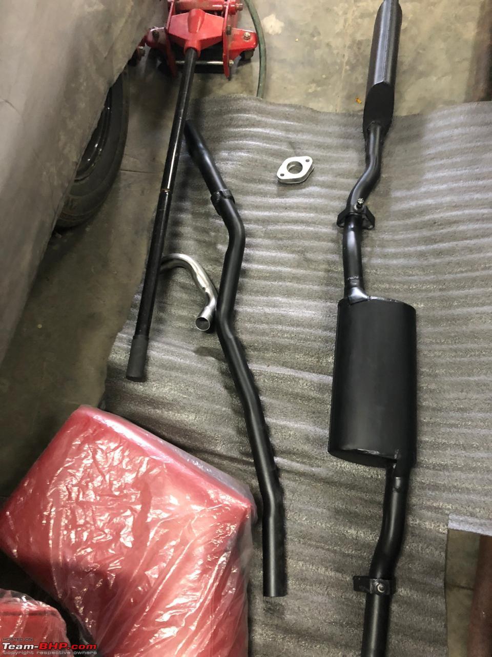

The exhaust was completely fabricated. The old one would not have lasted.
Heat treated painting was done

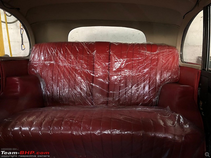

The rear seat has been completed

The almost complete rear seat is seen. Final fit needs to be done.

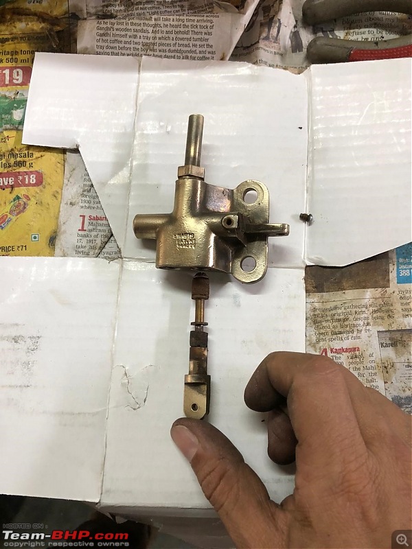

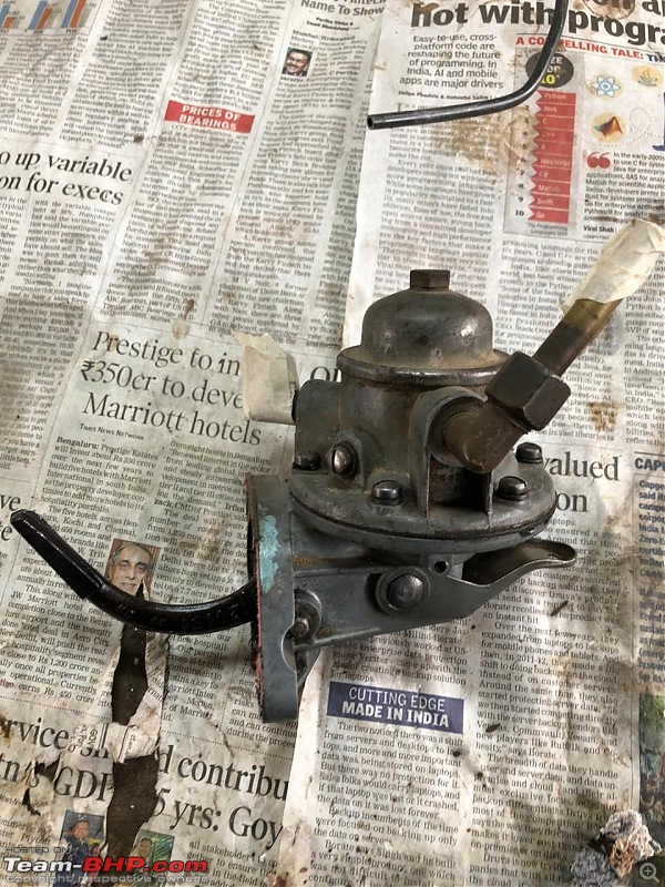

The little fuel pump was given all the importance that it deserves, a good scrub and clean up .

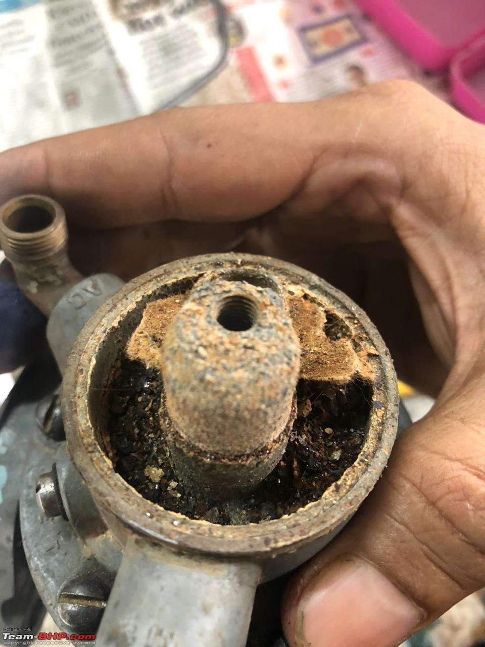

Clear signs that the car has not been in use for many years
Each part is carefully inspected
Cleaned up. The new few pump kit is ready the fitted

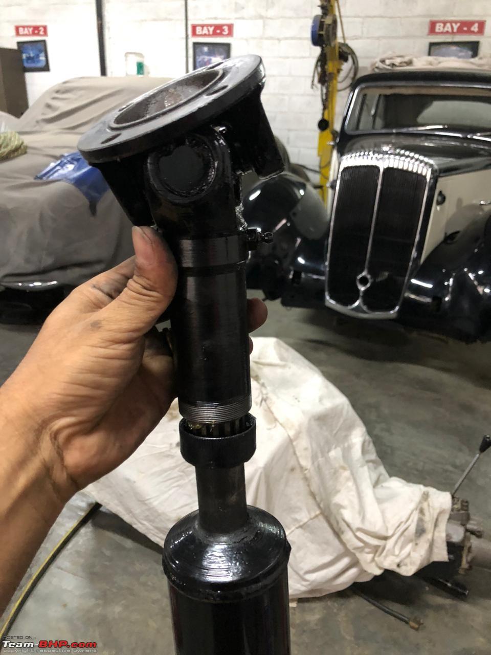

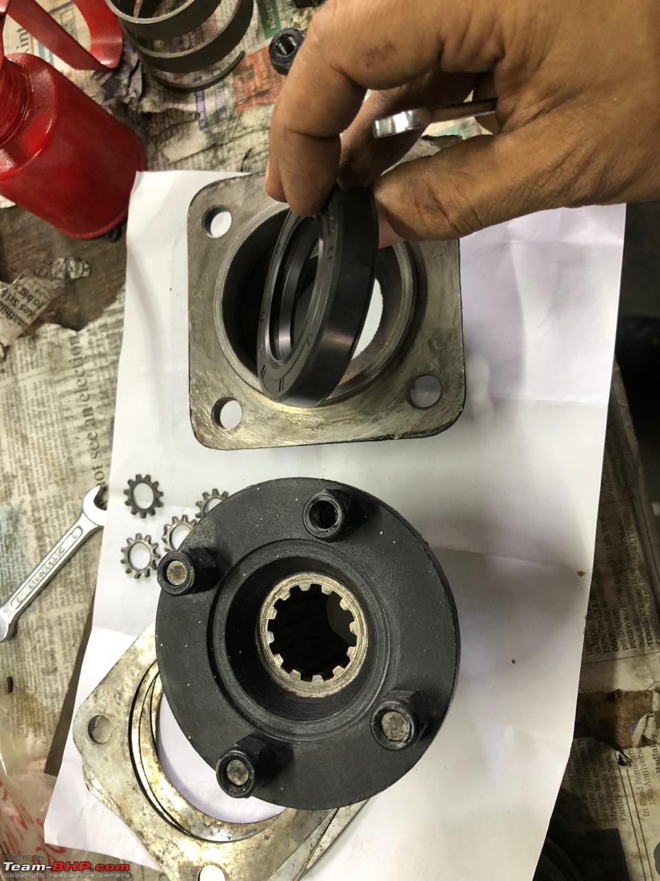

The rear differential seal was changed
Differential seal
The Drive Shaft us refurbished including the new grease seal and packed grease on the extension joint.

The meticulous work of Chris brings so much joy.
Attachment 2016236
Beautiful work going on
This pic brought back a lot of nostalgia. Our 1968 Herald MK II had a tickler on the fuel pump (not exactly like this). On the days/period when the car battery was on its last stages, my Dad would ask me to tickle the pump few time before he turned the key starter - so that the engine fires up on the first go.
Thanks for the pic - Chris is doing a great job.
