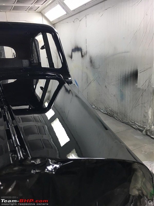

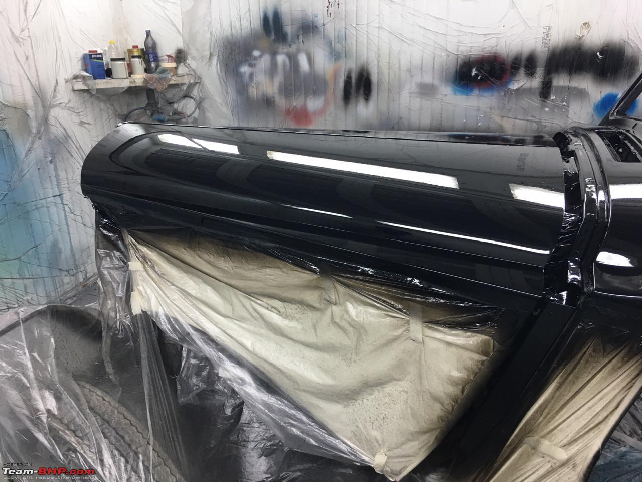

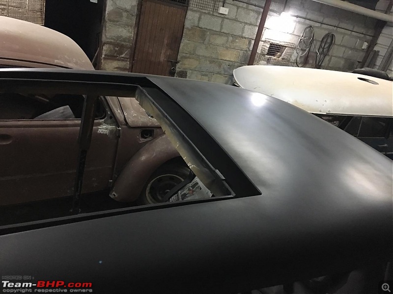

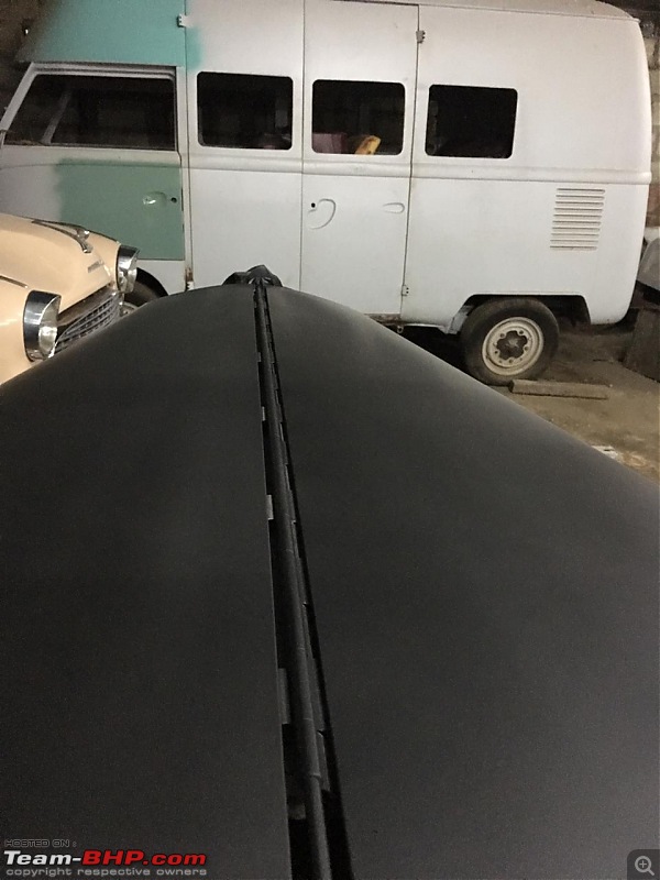

In the mean time, we are progressing with the surfacer application. Once we complete the surfacer, we will move the car to a paint booth for the final painting.
The black surfacer be applied, section by section

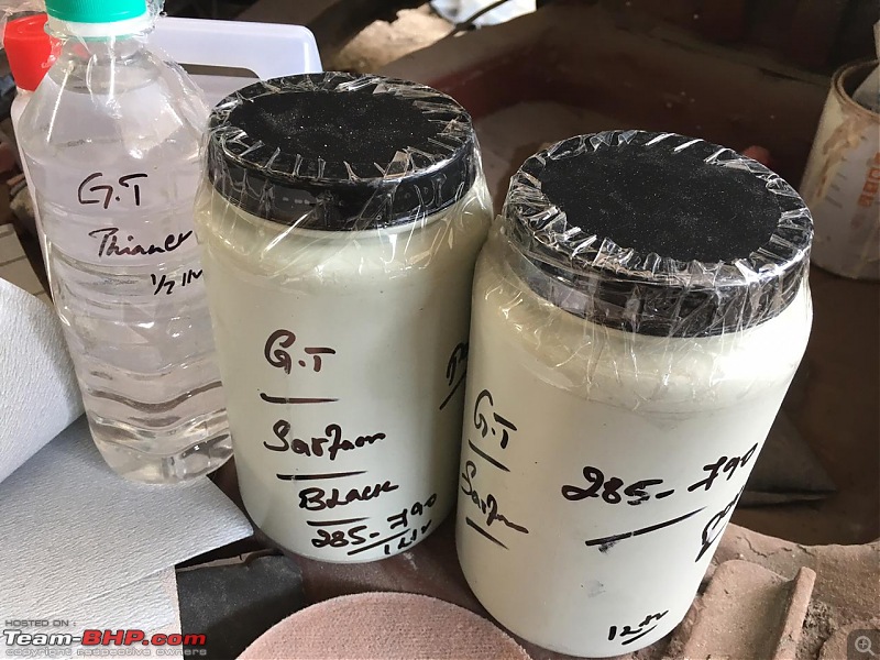

The Glasurit Surfacer is almost 4 times more expensive than any other surfacer. Matching the brand of surfacer and final paint is very important to get the best finish

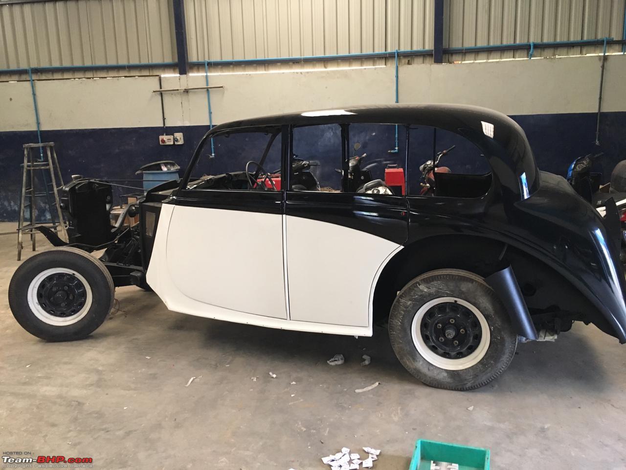

Body masked and painted with black and loght grey Glasurit Surfacer

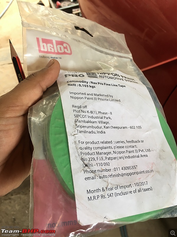

A Question: Do we have the brown kind of paper and green tape that is used abroad while painting to mask the areas where paint should not fall. We use newspaper which i felt "leaks" colour onto the protected areas..Cheers
car love is offline
Old 27th January 2019, 13:11   #139
r_nairtvm's Avatar
Join Date: Feb 2009
Location: Dubai/TRV/BLR
Posts: 2,115
Thanked: 2,625 Times
Re: Daimler Tales - 1947 Daimler DB18 Luxury Saloon
Green Tape - for grout/cement etc are available in Amazon India. So the other type should be available. Alibaba ans Amazon.com both ships this to India if you insist.
Brown paper - I believe the plastic coated/ with a sheen on oneside brown paper, which school kids use to cover their book will do exactly same and prevent leaching of paint.
I don't know if you've noticed good painters try to use those sheets of news paper where threr are glossy adverts or glossy/art (coated) paper (?) to mask the critical areas.
Green tape is thinner than the white masking tape we normally use, hence paint borders will be better merged.

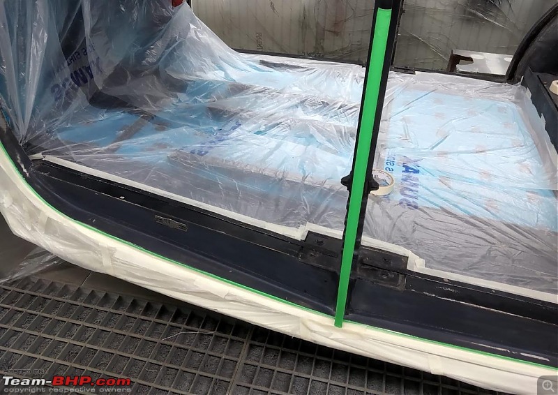

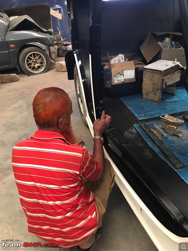

Yes, fine line masking tape and overspray masking sheets are available and will be used when we paint the car in the booth.
At this stage, the purpose of masking is primarily to protect the floorboards and wooden structural elements from any inadvertent spray, for which the ordinary tape is sufficient, since there is more than a few inches of gap between the wooden elements and the masking tape.
Daimler Tales - 1947 Daimler DB18 Luxury Saloon-fcea06fccea84f4abb8655d69d316c6a.jpeg

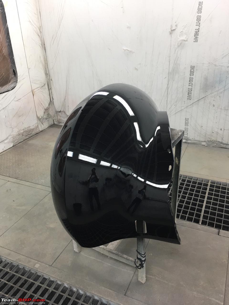

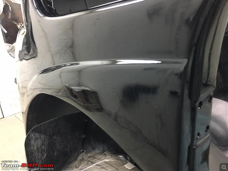

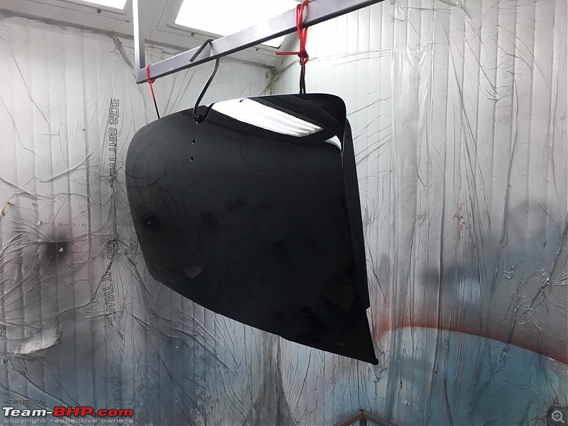

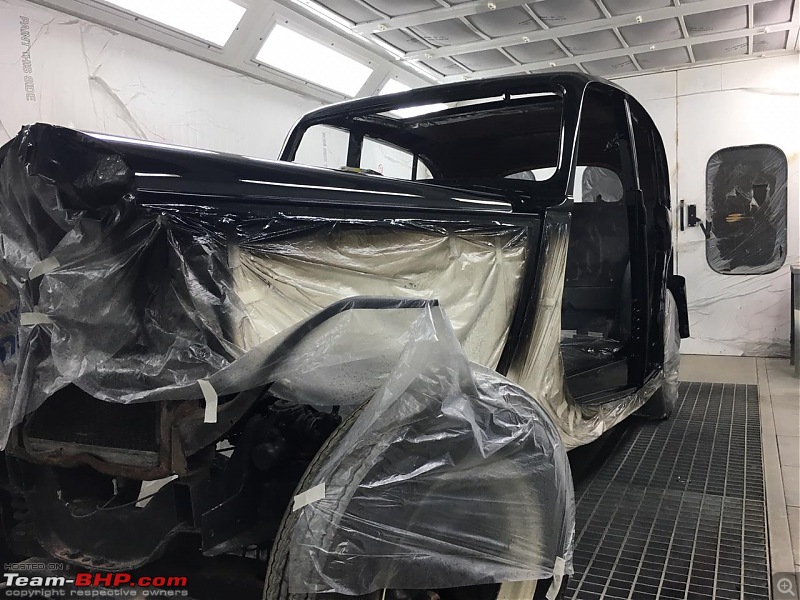

Some teaser that the painting has started. The lights in the painting booth throws different shades! Major part of the car is black!
The Boot lid
The front fender
Part of the cover near the engine

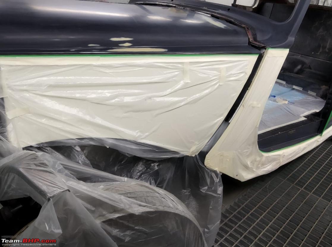

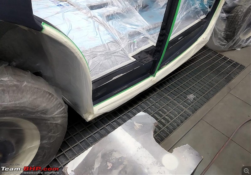

Masking does take a lot of time as extra care is being taken.
The finish. The white colour under the tube light looks different.

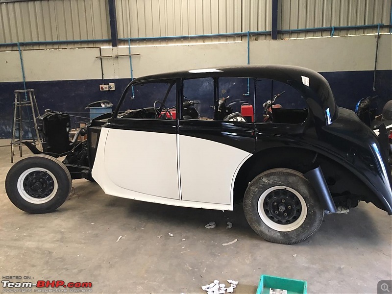

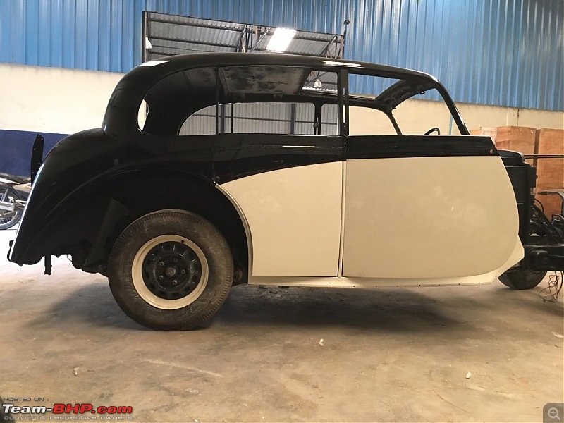

Posts: 2,790
Thanked: 12,098 Times
The painting is progressing very fast now
I cannot wait to see the paint work and get a sense of the car. My wife who is an artist in her own right is the one who chose the colour combination. I enjoyed the way she and Pankaj discussed the various combinations and finally firmed the mix.
Bulletboy has put his heart and soul in this project and finish is a reflection of this commitment. The prep for this paint job has taken many moons. Every dent or wave was tapped out, lines were constantly checked. The passionate man hours put into this work has been amazing
Guess, I am very fortunate to have Pankaj and Christopher in this restoration.
Post painting the car will move back to Chris's shop.

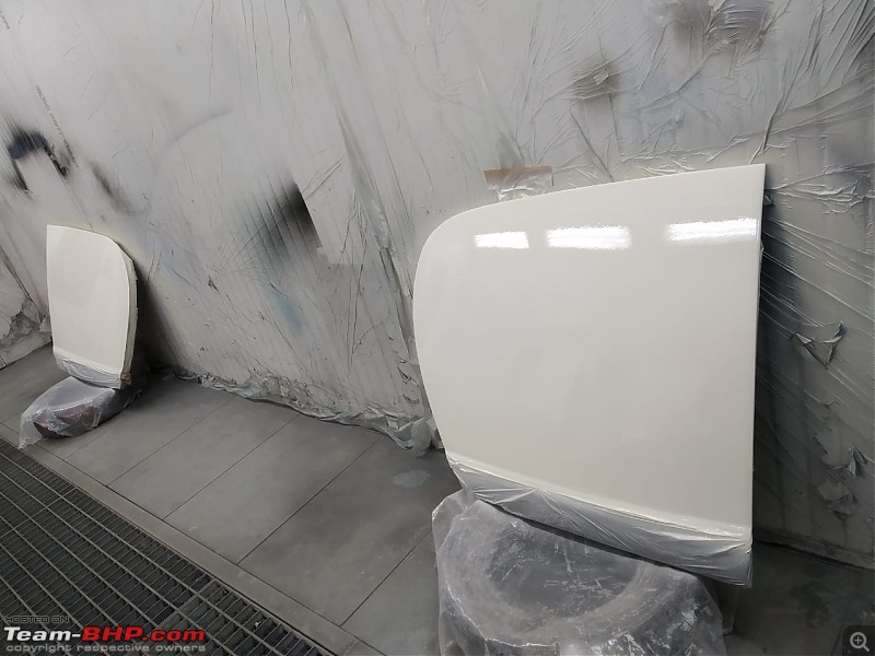

The doors fitted. The different shades of white, based on whether the car is exposed to indoor or exterior light.
