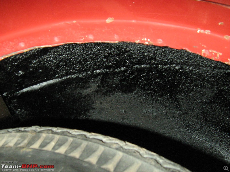

And yes, as mentioned, here it is, all done today! Turned out well for the most part. I like the finish especially on the front inner mudguards and front chassis rails, which are most visible. And done just in time (monsoon) I guess!

Thats some nice underbody coating Shyam bhai. Just curious to know how was it applied, i mean was it applied by a brush or a piece of cloth.
PS: i used it on my car too and must say its a great product, will last longer than most of the other rubber seals. Did it cost somewhere around 150 or so a ltr.
It was SPRAYED on bhai!!
Glad to know you too used it. It costs much more here, 500/- a ltr/kg. I had to use 2 tins.
They have 2 - 3 varities of the underseal coarting, i saw one for 300, 350, 500 and 700. Frankly speaking I was not able to chalk out the difference between them. I used the cheapest one . And spraying is a big headache, I know beacuse I only sprayed the coating

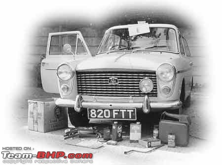

Old 28th August 2011, 17:38   #179
KkVaidya's Avatar
Location: Ahmedabad
Posts: 983
Thanked: 894 Times
Re: Welcome my new (b)ride, CAN 1526 (nee APF 4050)!
Sorry sir I didnt get what you meant by classic style?
Hi Stanher,
I have got 2 pictures that have the Classic style number plates. I feel, there should be no PLASTIC on classic cars. In those days, there was no acrylic so people used metal fonts pasted on aluminium plates. Those wanting something cheap would get the number hand painted!
KkVaidya is offline   (1) Thanks
