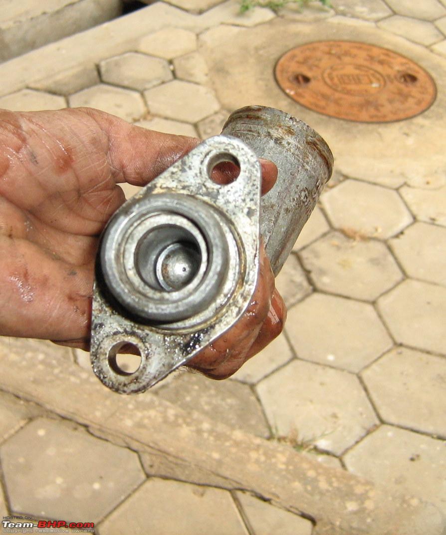

Now here comes a new challenge- I'd got the clutch MC kit changed with a new one (GIRLING UK) recently but my mech. found that the clutch pedal wasnt working- went straight in on depressing! So on opening up the m.cylinder (again!), it was found that the piston inside has gone...ironically after the cylinder was rebuilt with the brand new kit! :sigh:
'will see if a new piston is available else will try fabricating one (made of metal) but thankfully nothing wrong with the kit!
