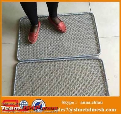

Any place in Bangalore to get steel wire door mat, like below?
Home Construction / Makeover / Maintenance Thread-images-1.jpeg
