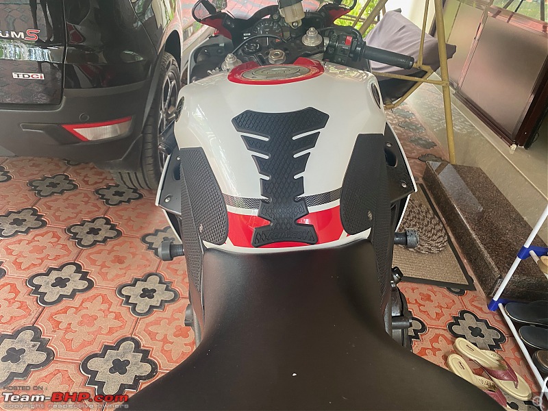

The Keiti CF design tank pads had worn out pretty badly over the years and the warning label sticker on the tank was such an eyesore and the fact that the tank pad was just stuck on over the warning sticker had me go nuts every time I look at it.
I had got a rubber tank pad along with the Techspec snake grips that I had ordered way back and it seemed like the best thing to do. A few days back I was able to get back the part from Bangalore and decided to remove the old tank pads and that god awful sticker and install the tech-spec tank pads instead.
A hair dryer, a plastic pry tool(did not want to use anything sharp to remove the current tank pad), and some WD40 and rubbing alcohol/ hand sanitizer .
The tank pad came off quite easily and left no residue at all. So that was easy. But on the other hand, the warning sticker gave me a really hard struggle to get it off, it tore off mid pull in multiple places and left behind annoying little pieces of stickers here and there and over the years the adhesive on it had really become gross and sticky that even after heating it with the hairdryer heat did not make it to want to come off. Tried the alcohol method but that also failed, went to the trusty old WD40, and worked like a charm in getting the residue off.
Post that cleaned the surface properly with a wet cloth to make sure no WD40 residue is left behind prior to installing the tech-spec tank pad.
Here are the before, after, and mid pics of the tank.

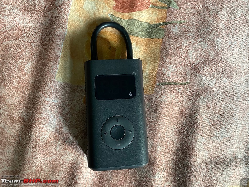

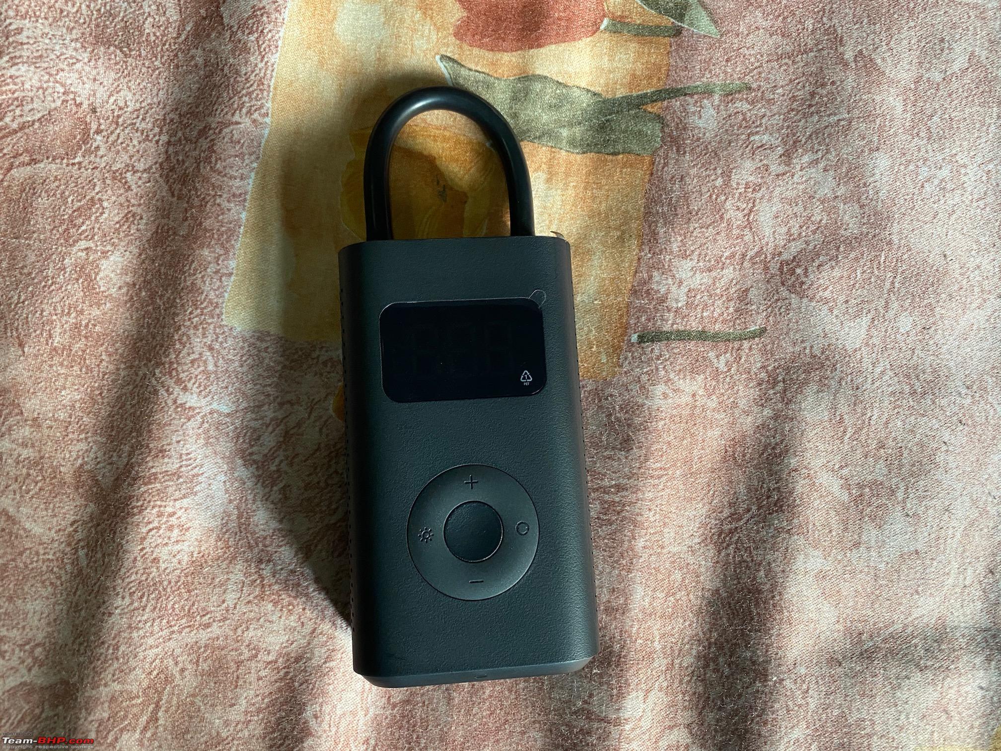

Also, I got one of those Mi Wireless Airpump for filling the tyres. Super portable and super silent too, with no hassle of connecting to the bike's battery. It holds enough charge to inflate the bikes' tyres 2-3 times over.
