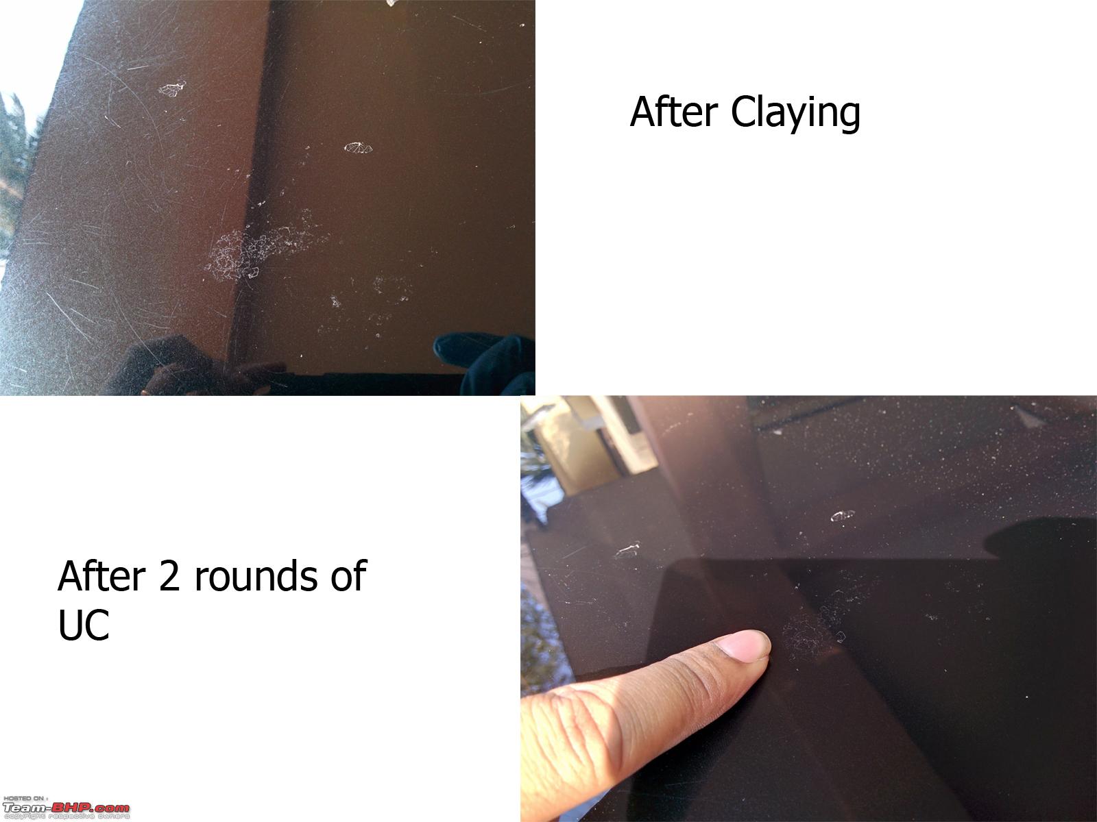

Today I tried compounding the roof as suggested.
Made 2 rounds of 5-6 section passes with UC + LC CCS Yellow pad, first with speed 4 and then with speed 6.
The Defects, especially the type 2 etchings are reduced somewhat, and some of the shallow swirls are gone.
Overall some improvement is there.
Had to pack up quickly today, so did not polish and just sealed with a coat of C845.
Some Before-after pics

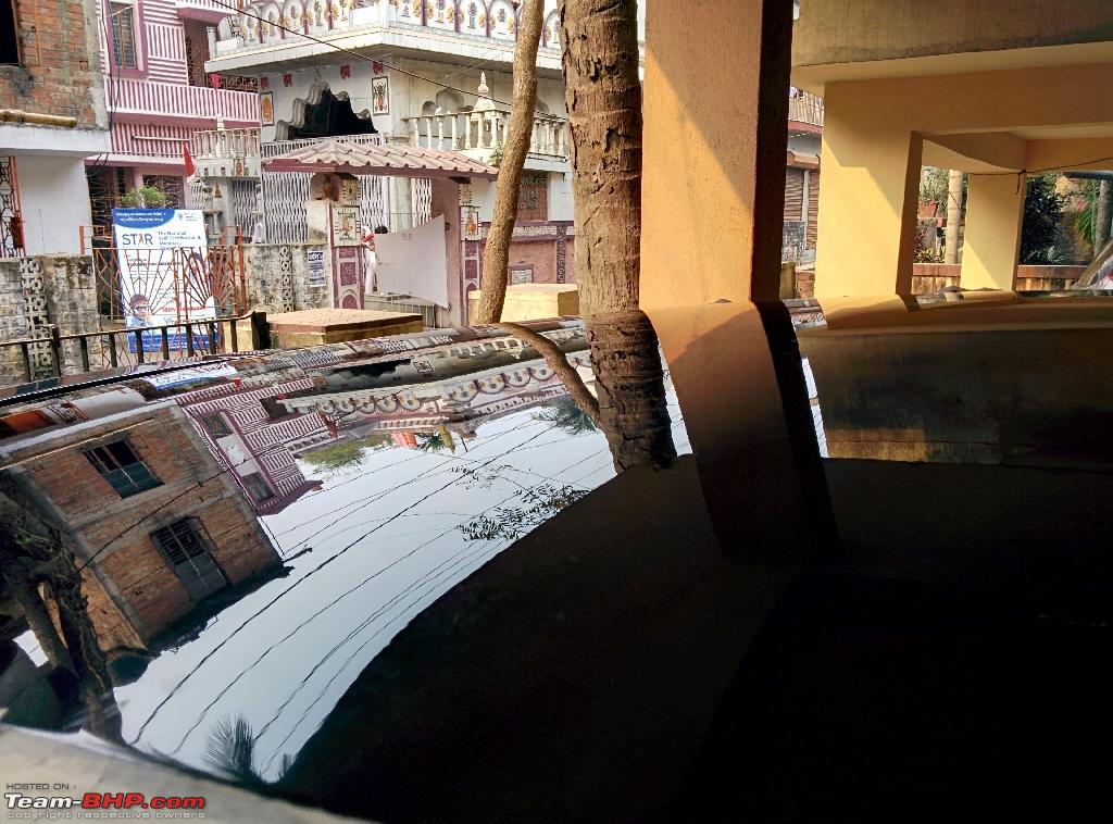

Ran out of Meg's car wash last week, so decided to put the flip-top cap from the same on the C845 bottle. Fits like a glove.
After a coat of C845. Plenty of deep defects visible.
Eye level, almost zero visible defects.
So guess I shall leave the roof like this until I can decide about whether or not I shall go for a wrap.

The clay bars are expensive though.
I had purchased stuff from Sanjay in November 2011, and now, I am on the verge of needing to buy again pretty soon.
I have only heard good things about bilt-hamber clay - though have never used it personally.
Placed an order a few days back, with shipping promised by 6th Jan. Let's see how the first buying experience is.
