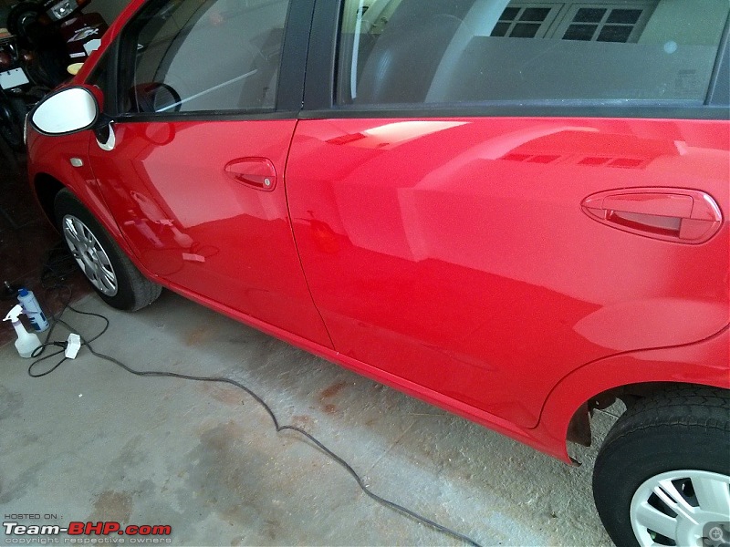

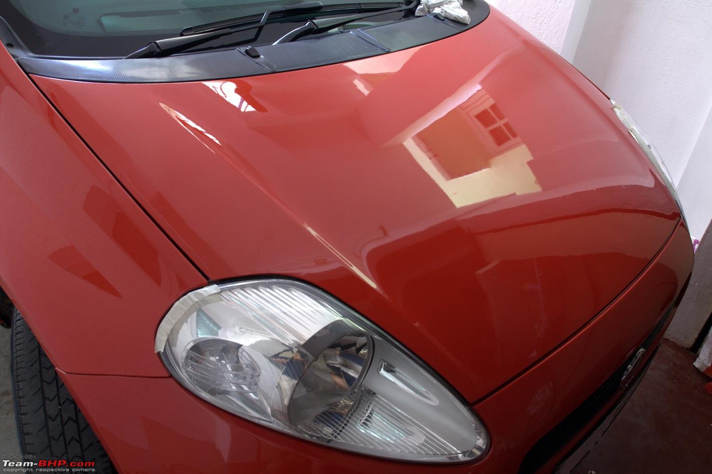

Detailed a friend's punto recently. Pics:

Done. Hood:

Doors :
Made a small video of the hood. Do watch in HD:

Great work.
What all products, DA did you use and procedure you followed? If you could detail it, it would be very helpful.
The 50/50 pic, its more like a 40/20/40 in which the right most side is comparatively better than center whereas as the left most is absolutely brilliant. How many passes of DA have been done right most and left post panel in the pic.
Thanks.

Thanks. I dont have a DA, all the work was done using a SKIL rotary.
This was a one step job done using Meguiars Cut n Finish + LC Orange pad on the rotary. I did another pass with M205 + W8207 but it didnt help much. LSP was Meguiars M21 2.0
For the 50/50 pic, I pasted three strips of masking tape but while doing the passes I crossed the three strips and so you get the 40/20/40 look.
These pics were after only Cut n Finish one step, its a DAT compound so had to do enough passes until it broke down. Pics in first post is with LSP

Very Good Work On Red Punto SunnyBoi
