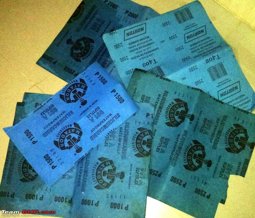

I picked up a huge stash of fine sandpapers over 6 years ago. Got a few of them here :
I have a few sheets of 3000 grit as well somewhere up in the attic. I restrict myself to 2000 grit since 105 + rotary can remove 2000 marks easily without needing 2500 or 3000 refinish.
I find it difficult to get anything more than 1500 in the market. No one stocks them since no body shop foes beyond 1500 grit while wet sanding. If you find some, do let me know!
Meguiars India does not sell either sandpapers or sanding discs. If you want sanding discs, contact Keystone, I saw boxes of 1500 and 3000 grit Meguiars sanding discs in his inventory.

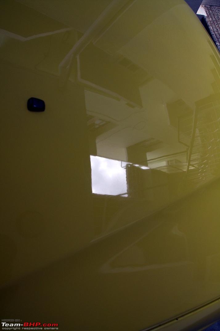

Washed my ZMA after a year and gave it a coat of M21.

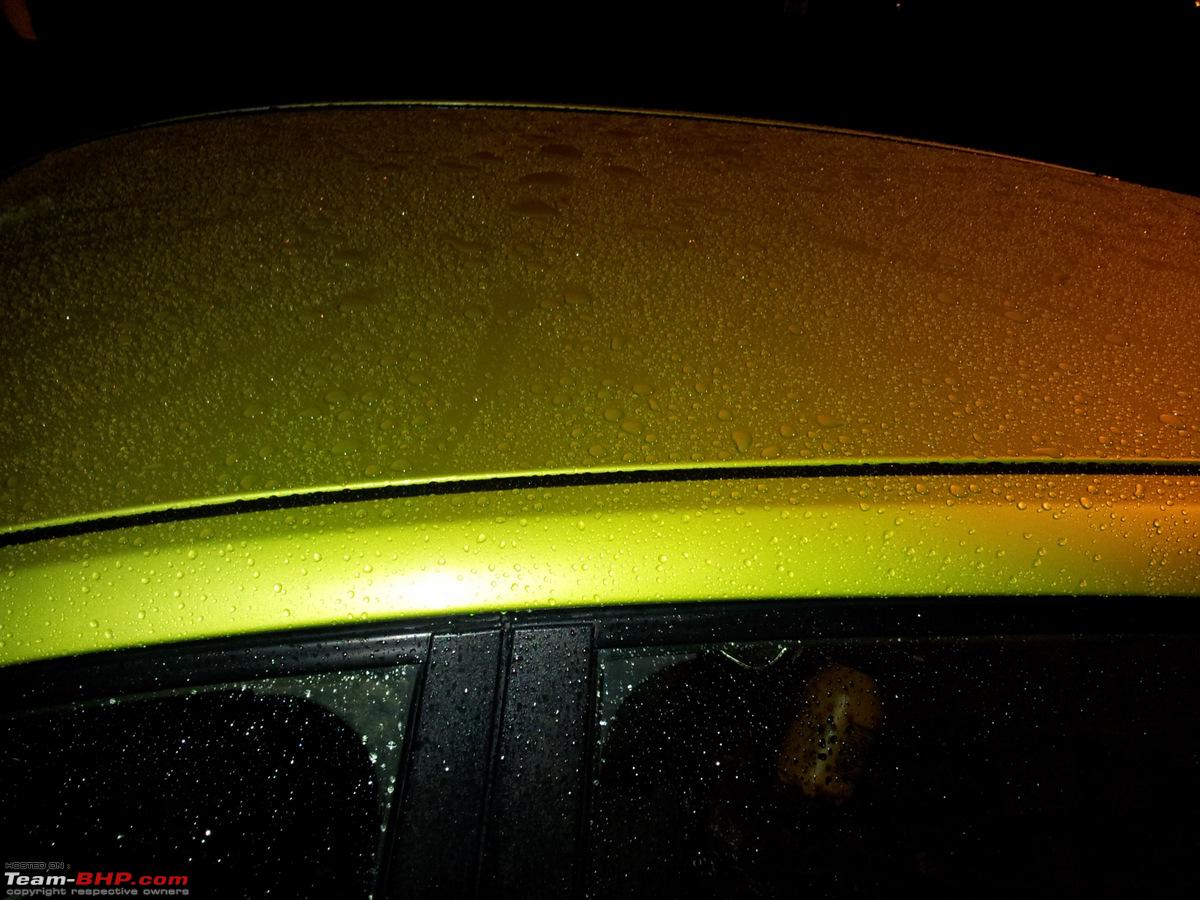

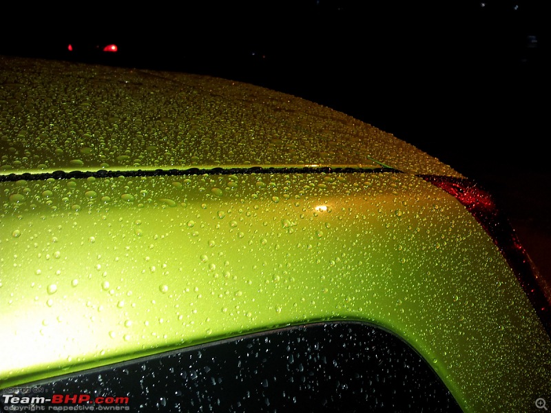

Some photographs after todays rain. Can anyone guess what has been used?

Talking about wetsanding, got a different brand of sandpaper for tomorrow's wetsanding session:

It had been a while since I polished the car. Clayed using Mothers Clay, brought out the rotary with LC White pad + Autoglym SPR and sealed with 4* UPP. WIll add a coat of Mothers Carnauba wax later on.
End results:
