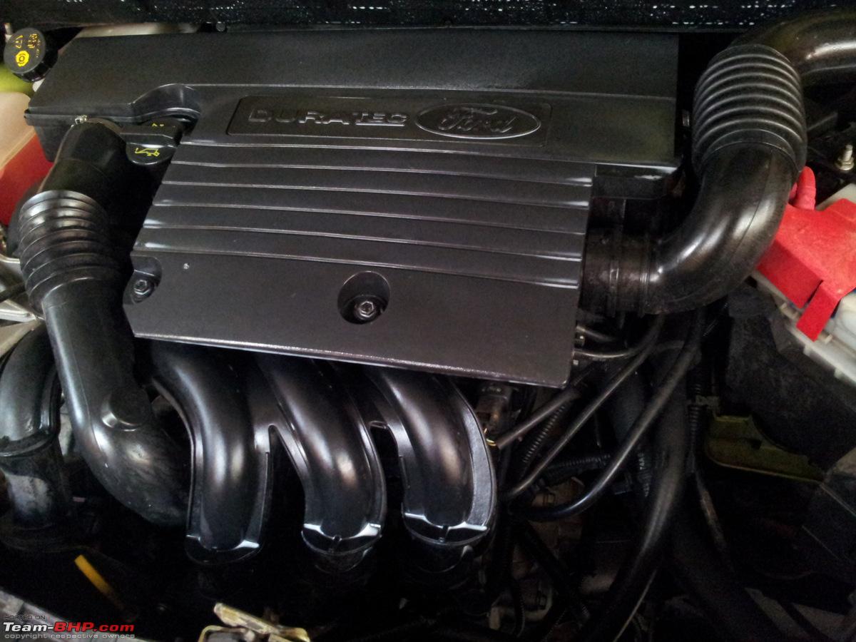

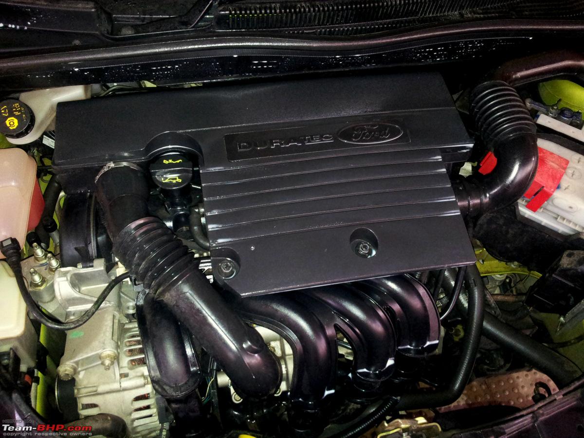

Cleaned my engine bay today. Wanted to try out the Daytona brushes that I bought from Keystone recently. The big one is great for wheels, but for the engine, the Daytona Jr is superb.
This brush agitates the dirt properly lifting it away unlike using paint brushes. Plus it reaches all the tight spots and brings out the dirt.
Only bad thing is, one needs to be careful because the bristles tend to recoil to their original shape and in doing that, all the dirt splatters onto your clothes or hands or even face.
Some pics

V nice Partha! Can you pl elaborate on engine bay detailing process - materials used, sequence etc? Thanks n cheers

Fantastic. Megs Super Degreaser and Hyper Dressing? I can see Hyper Dressing Residue on the after pics :P

Yes SunnyBoi you are correct. Super degreaser and Hyperdressing. The residue is there because the pics were taken just 2 minutes after applying the dressing. And it was still dripping off at that point. It dries to a nice finish however.

Hi Ravee. Good to see you on the thread. How about some more pics of the duster?
Engine bay detailing is pretty simple actually.
I used a pressure sprayer, super degreaser and daytona brush for the cleaning. And dressed it with Hyper Dressing.
The 3 things you need to be careful about -
  • Air intake
  • Alternator
  • ECU
Dont let water come in contact with these, as they can get damaged. With a pressure sprayer actually the force of water isnt much and can be directed away from them.
Spray on Degreaser to all the dirty areas, start agitating with tthe Daytona brush and spray water to remove all the agitated dirt. Use the brush to get into all the cracks and crevices and agitate the dirt out.
Give a final spray down and once that is done, spray hyperdressing on the black plastics. Let it air dry to a nice finish.
I had actually written about this earlier. Here is the link
http://www.team-bhp.com/forum/indian...ml#post3047956
At that time, I didnt have Super Degreaser so had used APC. Now super degreaser and daytona brushes are also available so that makes it pretty easy now.
