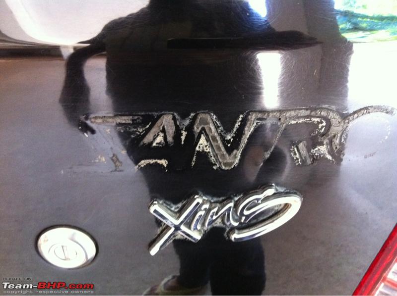

Hi.
While washing the vehicle yesterday, the badge broke off. So I removed it completely. Now there's a foam kind of gum residue which isn't coming off with shampoo/Meg's QD.
Any idea on how to remove it cleanly? I'll be using Meg's Ultimate Polish to remove swirls/scratches & Wax the area afterwards.
Thanks!

I am in search for the same. Cloth dipped in turpentine oil did not solve the problem.
In the past I have used nail polish remover (the one with acetone) to remove super glue residues - so that should work. I shall try that this weekend.

This video was shared a few pages back or in another forum post(don't remember exactly).
Sadly no access to a heat gun or hair dryer to do this.
You can try it if you have a hair dryer with you.

Spray on zorrik ( equivalent to wd40) put a couple of tissue papers on this. Spray some more on the tissue. Wait for a couple of minutes and then rub off. Should do the trick if you do it a couple of times.
Then a polish and paint sealant will make it look like new. ( two coats of wax )

You can also use hot air (a hair dryer) to make it easy for the gum to get off.

WD40 will help in this case, just spray on and lightly rub with a microfiber cloth, also Tar X from Carpro helps to remove adhesive residue from acrylic double sided tapes such as these used to affix emblems !
Hope this helps !

@torquecurve & nirmaljusdoit : Don't have WD-40, will try & source it though I don't know if I'll get it in Yelahanka. Fingers crossed!
OT : Can STP Engine Degreaser be used as an alternative to WD-40. Reason I ask is I've ordered it couple of days back & expecting it by monday. Then I can avoid buying another WD-40.
@KkVaidya : No hair dryer sir! Guess beg/borrow/steal from someone. A lesson well learnt in college.
