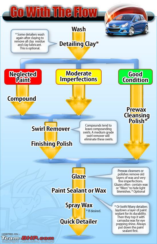

Originally Posted by wanderer4x4 View Post
So, it means that after rubbing the car with rubbing compound, I can straightway apply any one of these. Isn't it? And if these are the final items, anything that is suggested after rubbing and before the wax?
Yes, you can, if you wish you can rub down the surface with isopropyl alcohol to clean the surface of all compound residue & could also use a polish to refine the finish further. Try compound first & observe the results, Please refer the flowchart below from Autogeek which shows the steps including the optional steps for detailing !
Thanks for the flowchart. But then again refer to the last point there and that precisely is my confusion. They talk of using a sealant before carnauba wax. So, what are the brand names of such sealants that are available? Earlier I thought Collinite 845 is a sealant but now from your post, it seems that its a wax only and not a sealant (albeit very durable).
Whats your budget for paint sealant and which car do you own ??
can suggest you accordingly !
Collinite is as good as a sealant. The cheapest sealant you can get is the motomax paint sealant.
I plan to do some DIY heavy polishing with rubbing compound as my black car has all those tiny scratches all over with heavy swirl marks. Now, I'm clear about the way till applying and buffing with the rubbing compound. Confusion is regarding what to do after rubbing? Shall I go ahead and wax the car with Formula 1 Carnauba wax and then apply Collinite 845 in that order or anything else needs to be done in between? Or both the Formula 1 Carnauba wax and Collinite 845 the same thing and only differ in durability? I am under the impression that Formula 1 is the wax and Collinite is the insulator covering the wax. Am I correct or I'm missing something here?
Without confusing you, let me add a few things
1. Are you going to do rubbing/polishing by hand? If so- at best what you can achieve is visually hide swirls but no paint cut to remove them completely which can only happen with a machine polish
2. LSP- Last step product. You can apply a sealant OR a carnauba wax. These are mutually exclusive in most cases, unless where people want to layer wax to get that "deep look" that a sealant does not give. A sealant is more durable, yes but the look is a gloss and sharp look finally. Carnauba waxes these days are more durable than earlier, but very few are actually having proper carnauba content. A good one can be expensive because of the high quality T1 grade carnauba( like dodo juice waxes)
Collinite 845 has wax and synthetic polymers which makes it a hybrid- best is to refer http://www.collinite.com/about-us/faqs/ where it clearly mentions this on question 2
3. To get BEST results in terms of durability, layer your sealant/wax with the SAME product as base and then later add a product on top for the look etc.
Ex If you put sealant X, layer the same one again after the time it takes to cure and then finally you can add something else like a wax for the extra look and possible protection.
Again refer the FAQ's from the manufacturer and its says Collinite can be layered over your sealant
To get accurate answers on a product, best is to go with manufacturers technical details but take the recommendations on times of usage/durability with a pinch of salt as there can be some marketing/sales flavour there!
Hope this helps and not confuses you more ( sorry if it did!)
