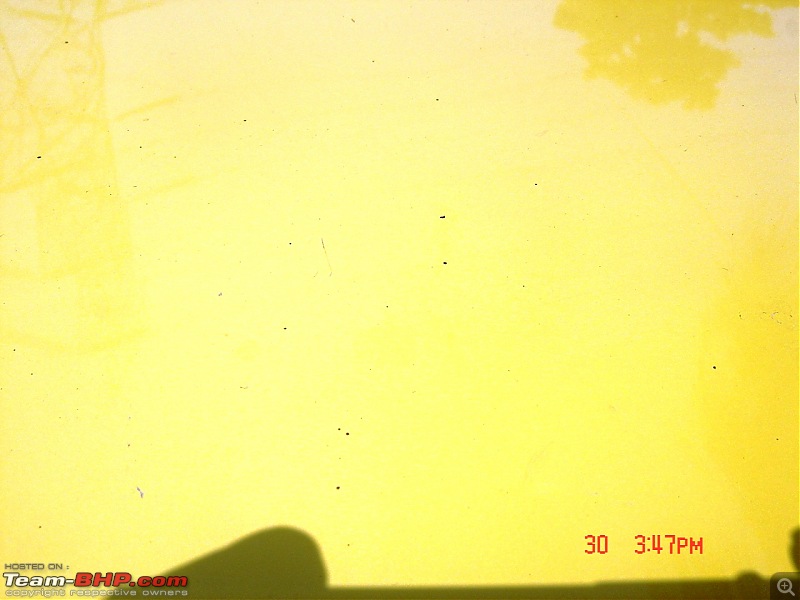

Why are those different patches?
Sir Ji, dont know why there is a mismatch in the paint those 3 marks, i think is it because some drops of the rubbing compound were left for a longer time, as the area was the one which is covered in the pic by the camera, the cement clot was there.
I think that must be the reason for those marks, what you say?

That cannot be the reason. Check it again and if need be, polish that entire area once again.

they are not different patches
thats his reflection holding the camera and taking the pic
hes polished it to a mirror finish

Ooops! you're right.
@sharma_sanjeevi, do not polish again boss. It's fine.

@Rudra Sir,
I went to see the roof of the car in the parking & took a pic before polishing or cleaning the area.
@Dockap,
You seem to be right mate, it must be the reflection which was causing the illusion of paint mismatch.
Find attached the latest pic before polishing that i took just now
