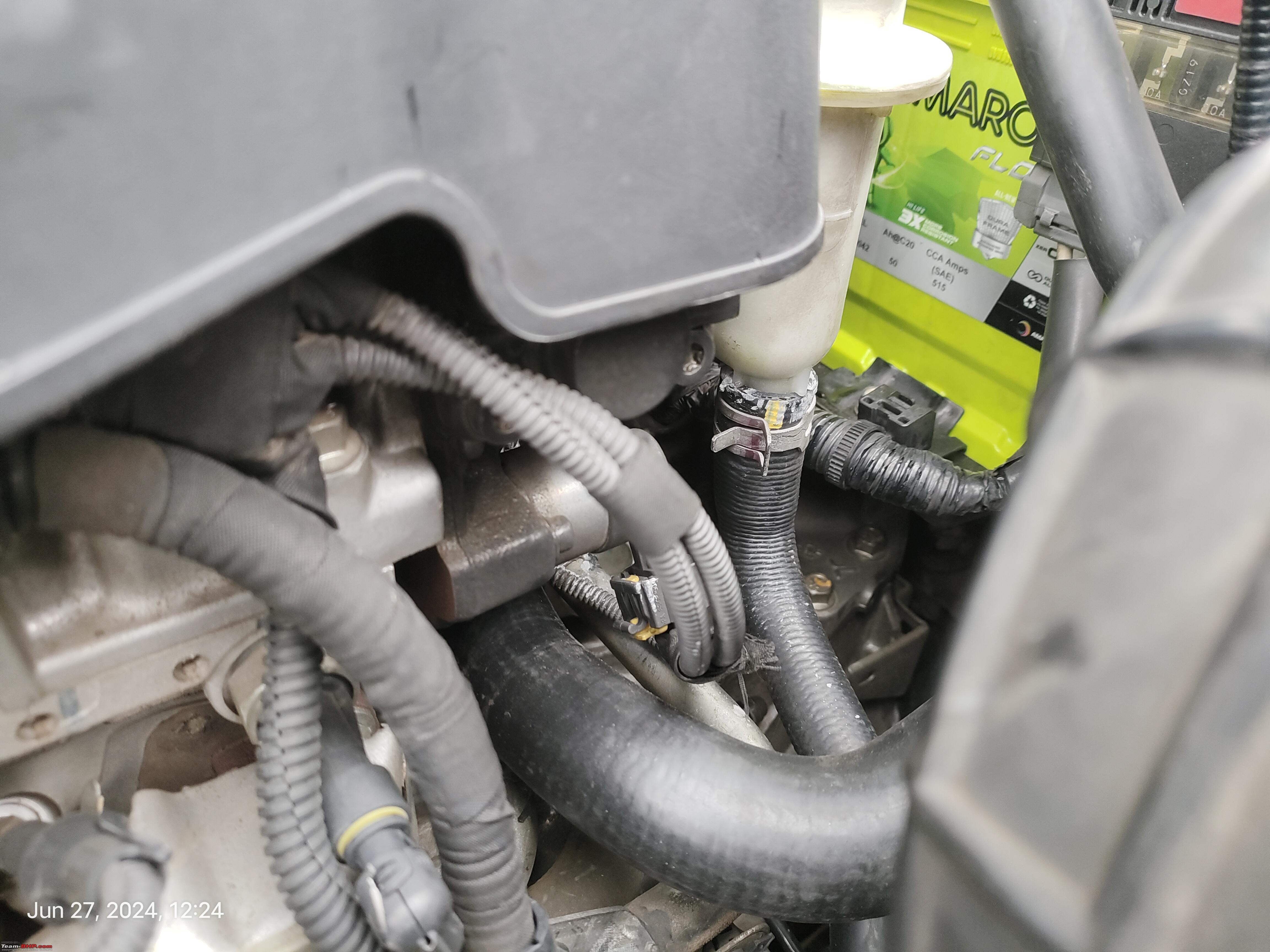

I own a Baleno Diesel 1.3 ddis. The vehicle has clocked nearly 153k and is properly serviced by the dealer and all the services are carried out at the required intervals. As an abundant caution, the thermostat and the radiator hose as well as the hose connecting the coolant expansion tank to the radiator was changed on my request since I thought it would be prudent to change them since the vehicle has completed 8 years. Unfortunately ,after changing the thermostat and the hoses, I noticed that the hose connecting the coolant expansion tank to the radiator has come loose and it was immediately brought to the attention of the dealer who promptly fixed the same. Unfortunately, the very next day as i was returning from a trip, the hose popped out draining all the coolant and the engine over heat lamp flashed for a second or two and I immediately parked the vehicle.
The service center guys blame the head gasket and say that the combustion pressure is finding its way to the coolant circuit and that caused the hose to pop out. I am attaching the images of the hose. I strongly believe the cause for the hose to pop out to the neglect of the mechanic to use new clamps for tightening the same. They used the old clamps itself and only when the vehicle got stranded did they use new clamps to secure the hose. I would like to know the cause for the hose to get disconnected . There is no abnormal pressure in the coolant circuit when the engine is cold and neither was any low coolant levels or engine overheating issues. Are the dealers trying to cover up their shoddy job by blaming the engine head gasket?
