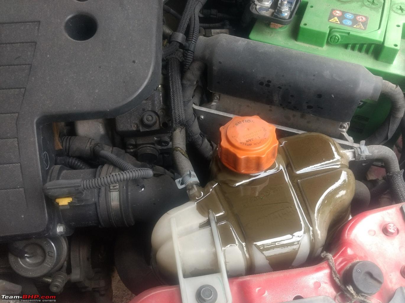

My Tata Zest has been a victim of coolant and oil mixture overflow. There was no low coolant/high temperature warning as such on the instrument console. Although, I did notice the engine temp. to be higher than the usual by a notch only after the radiator was abnormally running continuously. Parked aside and opened the hood and saw the mixture sludge oozing out of the coolant tank.
I was advised by a nearby FNG mechanic on call to wait for 10-15mins till the engine cools down and then drive it to them. The FNG quoted 15k, 2 day repair, that includes changing oil cooler and cleansing the entire radiator, coolant system.
Thought it was expensive and I took it to the nearest Tata motors service station(about 4kms). The service advisor is suspecting a conked oil cooler. As per him the entire exercise of cleansing would take 2-3 days and would cost about 20-25k if radiator is replaced as well.
Below is an image of the oil, coolant oozing out, the moment the coolant cap is removed

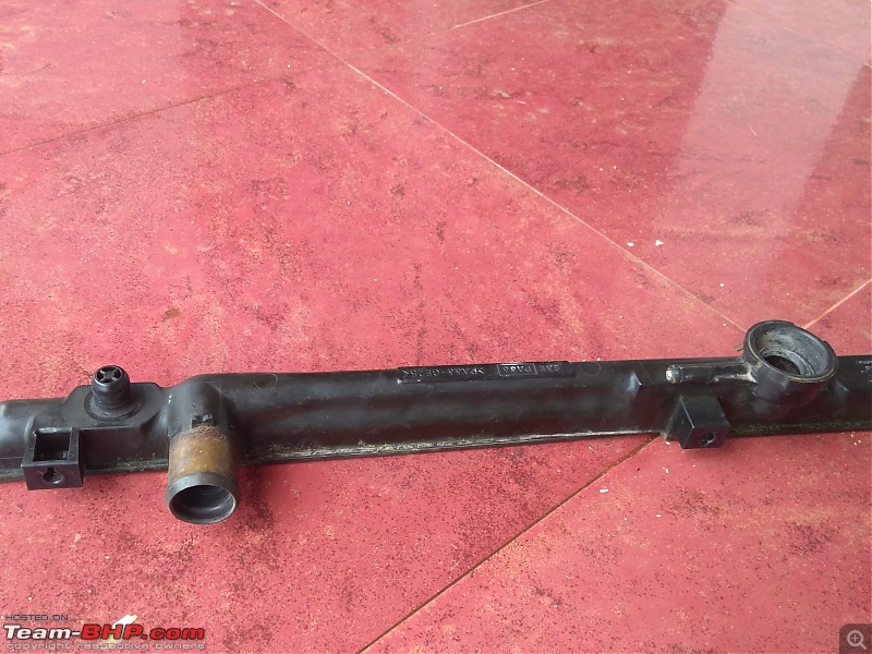

I was on a long drive during last weekend and all of a sudden lost the A/C and noticed the temperature needle raising up to my surprise. Immediately I switched off the A/C and then the needle came back to normal. I assumed something wrong with the A/C compressor and believed that is the reason the temperature went up. Drove for a few more kms and then the temp started raising and this was a shocker. As I was driving through a deserted place I continued to drive but at a very slow speed which kept the temperature display at normal level but intermittently going up and down. Drove a few kms until I found a mechanic. Opened the bonnet from there and as expected saw that the coolant has leaked out. We diagnosed it to a crack on the radiator top tank. The mechanic guy made a few phone calls and found the top tank available with one of his partner but it was quite far away and he asked me to wait. He went and picked it up and took about 3 hours all together.
Top tank which had a crack on it.

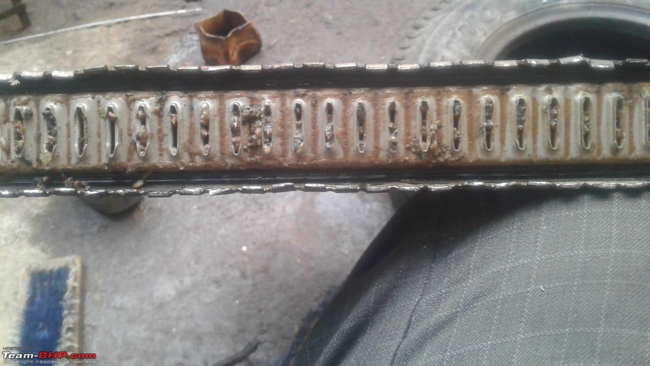

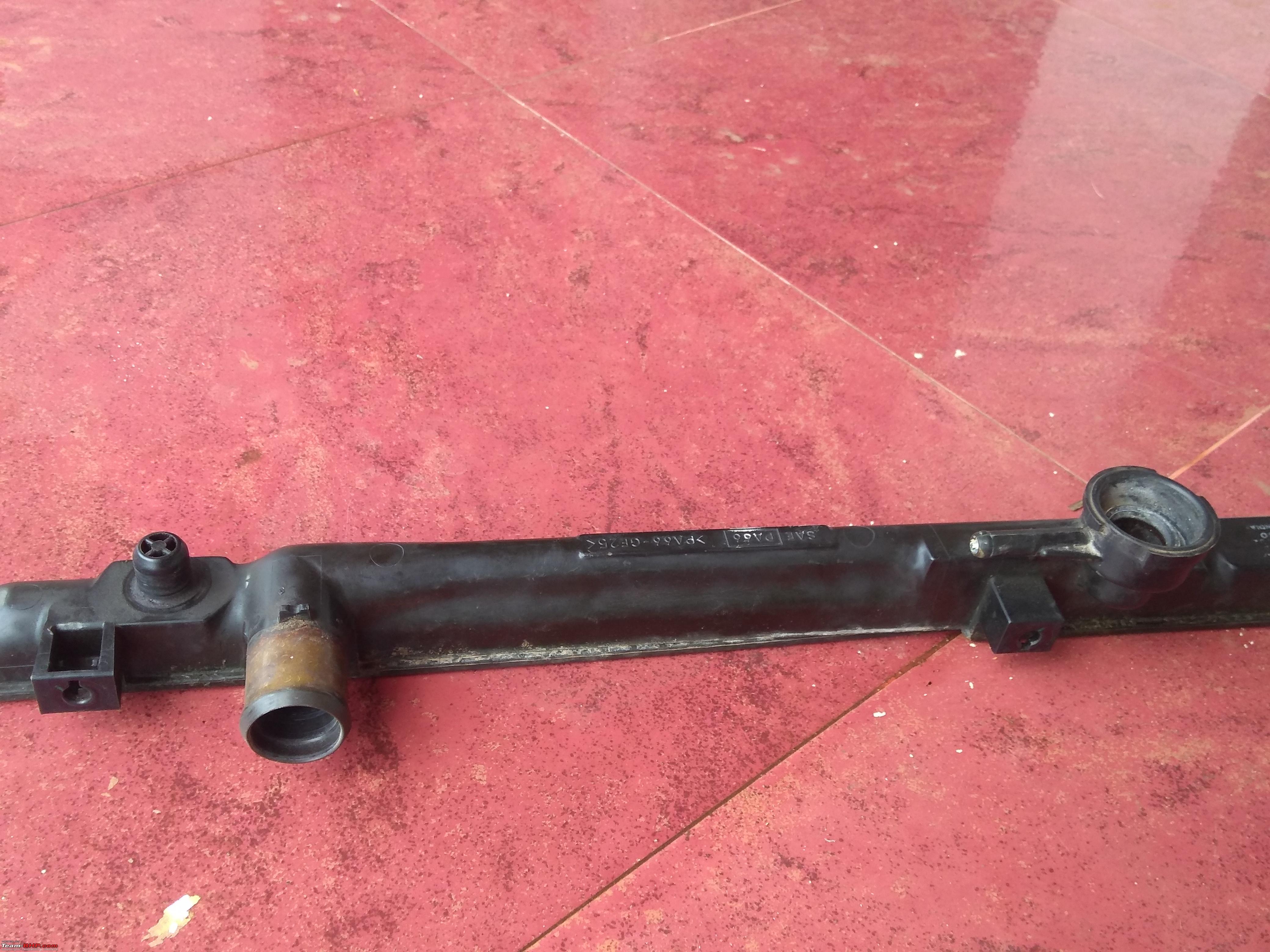

And in the process found out that it was all clogged inside the radiator fins. He did a proper cleaning of all these and fixed it back along-with.
