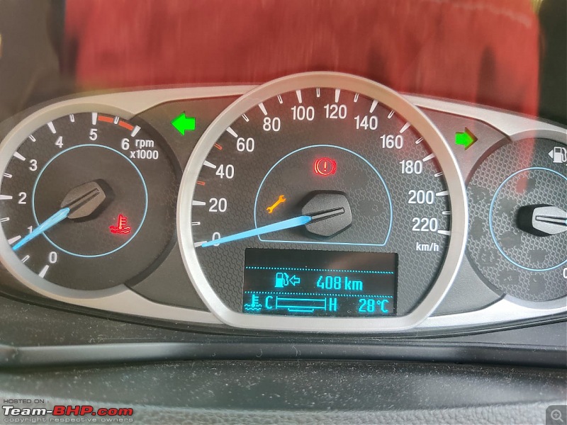

Our Ford Freestyle Titanium Plus 1.5 TDCi is currently being used by my sister for her commute to work. She called me in the morning and told that the dashboard has lit up with two warning light. On checking, I found that the warning lights were “engine overheat“ and “service indicator”. I also noticed that the temperature gauge was still on the colder side. She told me that she felt a coarse engine start than usual with black smoke. Also, the engine was running coarse and not smooth as usual. I thought it was due to cold-start because the engine temperature gauge was also on cold side but the engine overheat warning beside that was strange.
I immediately called my SA and explained him the situation. He asked to drive it down to the service centre. The car was 30km away from the service centre. I asked my sister to drive it down below 1500rpm.
I noticed the radiator fan working for approximately 5 minutes even after turning off the engine.
Upon inspecting, FASS found that a rat had damaged a cable. I suspect it to be some temperature sensor which sent wrong signals to the ECU. This lead the engine to run on richer mixture considering the engine to be on colder side.
After sorting the cables, the car is starting normal and running fine.
The car is just 11 months old. I’ve concerns over the engine which faced overheating. What could’ve been damaged? What should I do to check for any internal damage? What should be done to ensure the long term reliability regarding the damage caused due to this incident?
