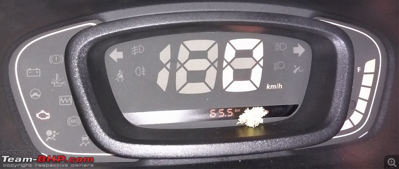

Yes definitely it over heated. That's what I also presumed from the symptoms. But then had I been staying at Mahabaleshwar, wouldn't I take the car out? Infact in that case, the climbing etc would have been more frequent. The only restrictions that I have understood is that I should not rev the engine hard and stay within the 80kmph till the first servicing, (2000km/2months)
My simple logic says that once the threshold was reached (if at all that was the case), it should have been detected and driver to be warned. Modern cars definitely have built in features for detecting these. Then how come there was an exception this time?
What to do if your Engine Overheats on the road-img_20170403_072953-1024x434.jpg
Referring the above image (which was taken sometime in the initial days), in the second column, neither the second nor the third indicator had lit up when this issue was about to happen or when the issue had happened. Was this then an onboard diagnostic failure?
Majumdarda is offline   (1) Thanks
I am not sure how the Kwid is wired up to alert the driver to unusual problems under the bonnet. That said, I have known cars that have experienced catastrophic engine failures (seizures) without so much as an single indication from the dashboard lights.
R2D2 is offline   (2) Thanks
