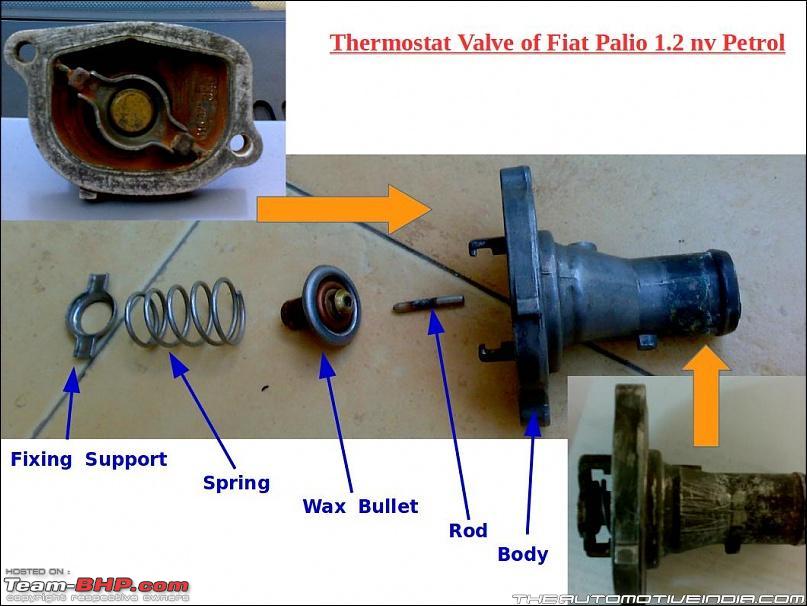

The thermostat's pintle(rod) or spring could have temporarily remained stuck-closed for a while, blocking the coolant flow to radiator, causing the temperature and pressure to rise up rapidly.
Probably the thermostat worked fine after a while. That's why you did not face the issue of coolant temperature climbing up again. Anyway it is a faulty thermostat, and you got to replace it as early as possible, before it causes further damage.
What to do if your Engine Overheats on the road-2tv-thermostat-valve-fiat-palio-1.2-nv-petrol.jpg
Image source:www.theautomotiveindia.com
As far as I know, the thermostat is not connected to the ECU. There is no sensor, to tell if is closed or open.
Read here:
Why thermostats don't have a sensor ?
BLACKBLADE is offline   (1) Thanks

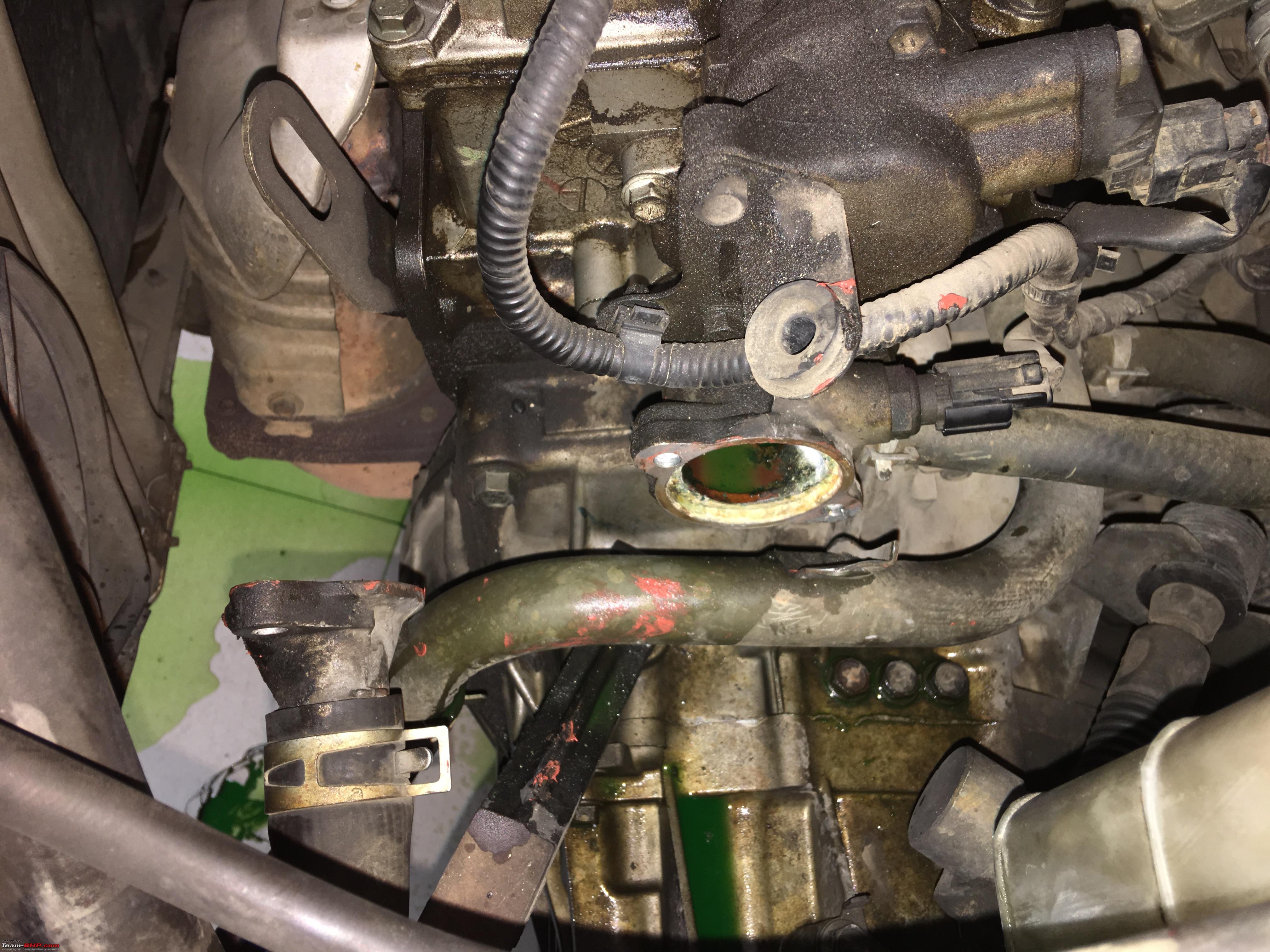

The thermostat was faulty.
The rod inside was bent and the spring jammed.
Surprisingly the issue did not re-occur even with the coolant tank almost empty.
Filled the tank and replaced the thermostat.
tharian is online now   (2) Thanks
