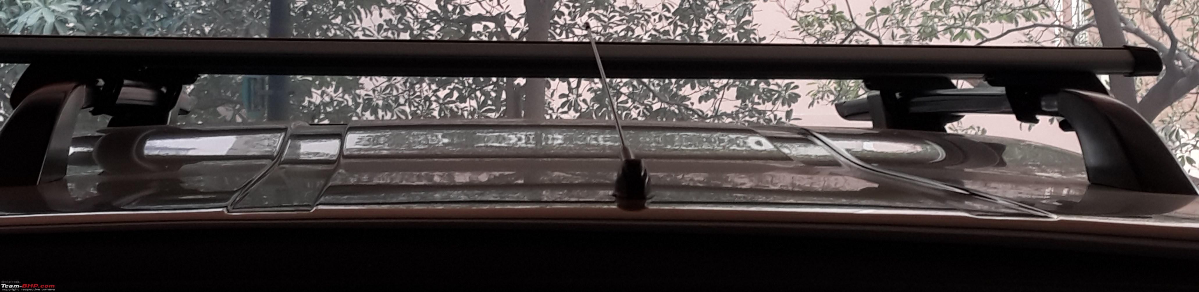

Here's what I've installed and been through a impromptu trip. Held out well
Questions About Roof Racks / Carriers / Bicycle Carriers-scorpio-rack-ski-rail.jpg

Where did you buy these bars from and for how much? Did it manage to hold your stuff well and without much movement? Thanks.

Could you post a picture with the load as well? does it go on top of the cross-bars? or between them (on the roof of the car). I'm looking or something with as low a profile as possible because I need to go through some pretty low ceiling parking spaces at home and office.

Ajit I picked these from US in Nov. Cost me inr 4000, if you see the pic there is slight gap on the outside clamp which made me suspect its weight bearing capacity and sturdiness. These are universal roof rack 49". I took the measurements with me however nothing to be found which fits snug. This has rubber padding within it so it clamps tight. Despite this it has handled well. I carried 50kg in total 3 large duffle bags tied with bungee cord and waterproof cover. The rack can be assembled within 10 mins and comes with keys to lock the foot pack in place after tightening so stealing is pretty difficult, not impossible :-). I'll be getting a sectionwise detachable aero bag which makes it easy to store things not to be used until destination.
Also be careful of one thing the ones on ebay are shady ones have been bitten once already . You will need ones with adjustable width since US folks dont have India specific designs. Here are couple of measurements to look out for. Max and min width adjustment. Roof rail width and shape. Most of these scorpio ones are tapered D from the top. Roof rail vertical height and clerance required between roof rail and roof. Hope this helps, i looked at multiple ones in India and didnt find what i wanted. Thule is good but not so much for the money, my opinion before someone bashes me. Main criteria was low profile, sturdiness ease of install and uninstall.
