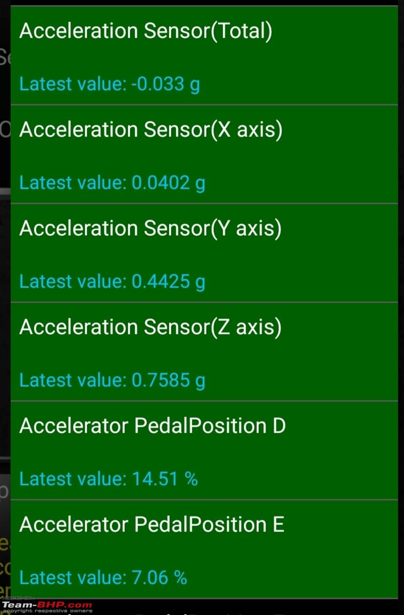

Doc, can you help regarding throttle position percentage at idle. In torque I get value of throttle position at idle as 37% what does this mean? Shouldn't it actually be 0% as I am not pressing the throttle at all.
I have never observed it as zero percentage in torque pro app. There are 3 or 4 parameters, I remember one was showing 7.5% and other one was double at idle in my S-Cross.
I will check for SX4 too
Please do let me know as I am curious about the same and haven't been able to get a satisfactory answer.
Also does smoke maps affect driveability of a car? Will a car with High control on smoke limit maps be same performance wise as a map with moderate smoke limit maps?
My second map where in I had asked for more low end and less smoke is not very satisfactory. I have to keep pushing the pedal more and more and this tires me out. The smoke is quite less but somehow I find the engine very restricted and un eager. Feels more like I am towing some heavy load and to compensate I keep pushing the pedal harder.
Earlier map I feel was better. Maybe il switch back and have a back to back drive to get a feel of car one again.
These are the values shown for my SX4. It's similar to all my other cars.
ECU Remaps : About Tools, Software & Tuners!-img_20191119_215243.jpg
Smoke limit maps / AFR Maps are usually tweaked so that it doesn't limit the changes made in other maps.
Cool, but ECU needs some time to fully adapt with the new map. If you are not concerned about smoke, ask Wolf to give you same map as mine .
Attachment 1936587
Thanks.
What does excess smoke mean? Does excess smoke have any impact on engine life?
In my car the pedal position is 37% at idle, I am wondering if the map has only tweaked accelerator position sensor to possibly show more accelerator input then what it should be?
I have run over 800 kms with the new map so I guess that should be enough time to understand. What I actually need is a map that makes me have fun and say wow everytime I drive the car. Right now it isn't. So am contemplating going back to the previous map or try your map and take a call.
Wolf is coming down for the weekend and I shall spend sometime and finalise.
Thanks.
Thick black smoke on acceleration (full throttle). Don't worry about the engine, turbo will give up much before it . That's why I do not go WOT at high speeds for long duration to keep the EGT in check. My map has very high fuel and boost even at top end. But, no reliability issues till date except for occasional high boost error.
Better check the A pedal sensor first. Wolf would never tweak any parameter at idling, doesn't make any sense to do that.
Thanks again.
My suggestion: Get a map similar to mine, but with lesser boost and fuel at top end.
Cheers!
