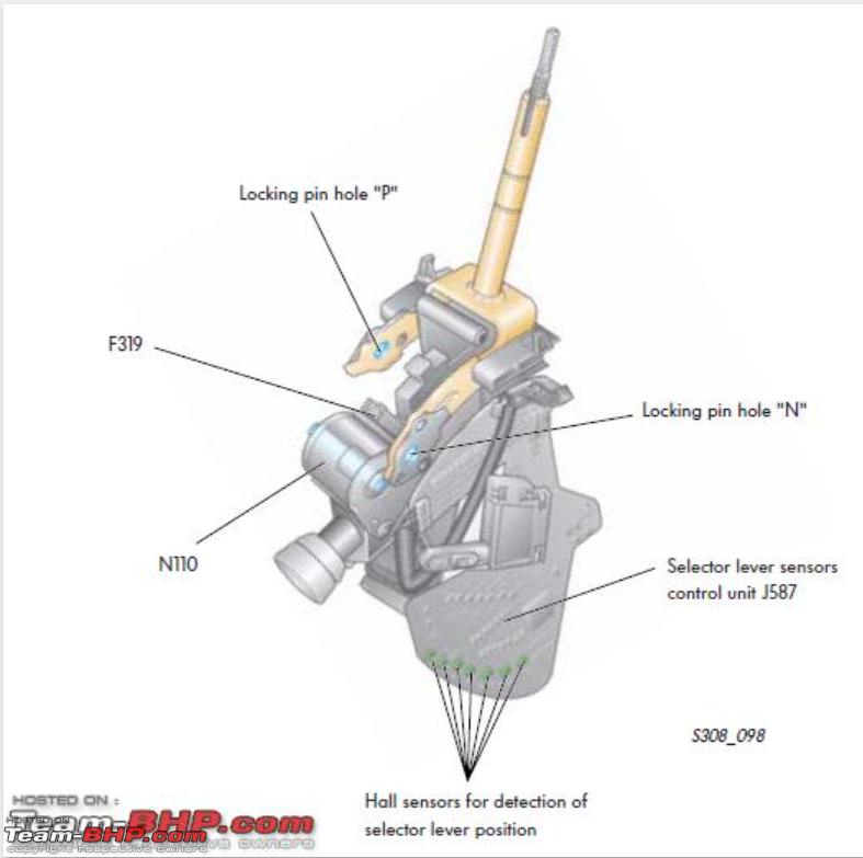

Hi,
Facing a peculiar issue on my 2015 Vento 1.5 TDI.
Parking gear is not engaging whenever I keep gear selector to “P” mode. Literally car moves like I put the gear in Neutral.Rest of the gears behaves normally even Reverse gear hold the vehicle properly even on highly inclined road.Gear shifts are smooth and shift flawlessly while driving.
Have strange feeling that while shifting between gear modes (P,R,N,D,S) lever feels so slippery, can’t feel that changing notes while moves from P to D.
Changed Gear Box oil on previous service (10 months before). Mechatronics oil didn’t changed that time since item was not available on India.
Parking gear is not engaging whenever I keep gear selector to “P” mode. Literally car moves like I put the gear in Neutral. Rest of the gears behaves normally even Reverse gear hold the vehicle properly even on highly inclined road.Gear shifts are smooth and shift flawlessly while driving.
Hey, good to see a fellow Vento 1.5 DSG TDi owner. I was a proud owner of this beauty till about couple of years ago.
I think your problem of the 'P' mode not getting selected properly and the slippery shifter COULD be a possible symptom attributed to non/mis-functioning of the 'Hall sensors', which are responsible for proper selection of the gear lever position.
See this diagram:-
Name:  selector level design.png
Ofcourse, there could be some other local issue. But better to get it checked pronto.
