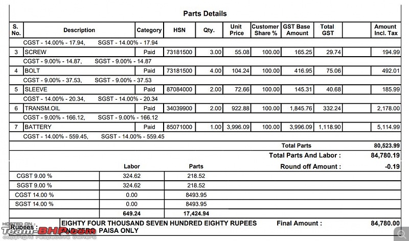

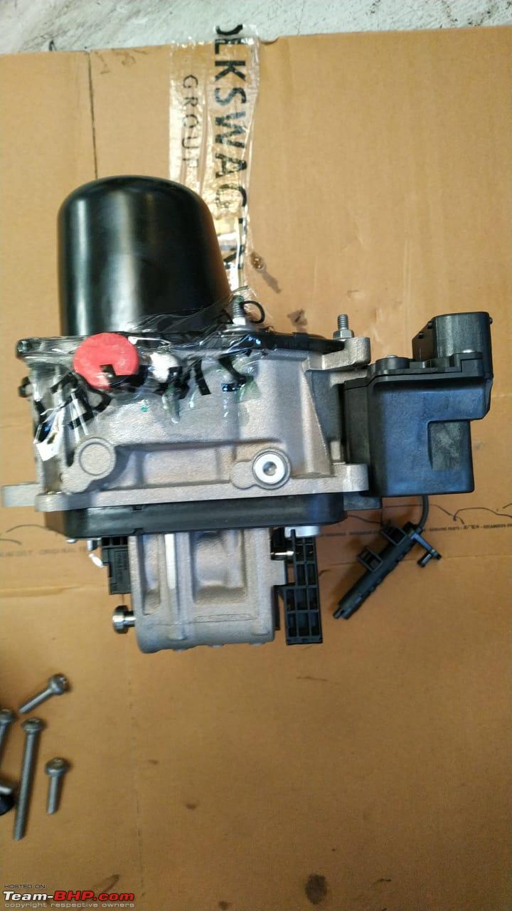

Hi, I am new to the team-bhp forum. I have seem some discussion happening on DSG hence sharing my experience in short. Please help if this is not the right thread to share.
I own a Apr 2016 Make Vento TSI. Post the pandemic situation was getting under control thought of executing a long road trip from Pune to Delhi for a stay at home of 3-4 months.
Just as we reached Vadodra, as soon as I took the exit lane from Highway the car went over a speed bump normally and car stopped moving into D2. it will keep revving in D1 and above 4000 RPM will directly shift to D3. Did an ignition cycle and the Gear indicators started blinking along with a wrench icon. Luckily we had a stay over hotel booked in Vadodra at Sayaji so limped over to that place and took RSA towing option the next day.
Long story short, The mechatronic unit has been replaced at my expense and the car has been moved to Delhi (500km was covered by RSA and rest 400km up/down tow charged paid by me).
I want to share more about my experience in a log format so long time forum members can guide me where to share this information.
However I am posting this here actually for 1 question that's been bugging my mind - Can car tyre upsize with approx. increased circumference of 3% mess up with the gear ratio calculation to this extent that can cause mechatronic failure?
And if it actually happens, should I go ahead and change the tyres back to stock size? I am basically frightened that this kind of failure if happens again will cost a bomb as it has now.
I took a gamble early Jan to change my stock tyres (GY 185/60/R15) to Yoko Earth 1 185/65/R15 on guidance of my trusted tyre vendor. He insisted I upgrade to increase some ground clearance and more plush ride (with the downside of more body roll at high speed maneuvers).

Additional context of asking this question:
Before tyre change - Di to D2 shifts were seamless just above 1800 RPM, however noticed immediately after the tyre change that D1 to D2 shifts used to happen after 2500-3000 RPM during initial run (lets say during first drive of the day), and after some time shifts would normalize in range of 2000-2400 RPM. This is not something I saw before hence not sure if this can be placebo effect or the mechatronics was getting strained. Didn't give it much though honestly thinking such behavior might be situational.
How much was the cost?
How about invoking warranty or good-old escalation to dealer Mgmt?
Honestly, haven’t heard about a tyre upgrade (of about 3% in aspect ratio) causing a DSG failure.
Most probably, something must have conked off the moment you went over the speed breaker. Maybe it was awkward angle over the bump causing the unit to not being able to comprehend what’s happening, maybe it was a combination of some last minute braking and/or physical damage to the unit from below or maybe the hall sensors not transmitting the right signal or maybe something else.
Unless the service personnel give a clear analysis, one wouldn’t know for sure.

Missed responding to the question related to warranty and repair cost.
Essentially Warranty 4th year expired on June 2020, and I didn't buy extended warranty for 5th year as it was still confusing to me as to whether I am eligible to buy once or can keep extending as VW Warranty TnC's keep changing.
Dealer Goodwill was deemed as void on account of 2019 serving happening at 1 yr 3 M period, and same with 2020 servicing. So instead of the annual service schedule of May to May it shifted to Dec 2020. Second counter argument dealer made is I have used Exide battery as replacement not OEM.
I argued on both clauses and escalating it through Grievance channels, but the complaint wounded up two times with the Pune West and Baroda VW dealerships itself. Pune West BU Bhandari SA during 2018 service had said to change the battery due to low Cold cranking amps (lasted merely 2 years, and the reason SA advised to change battery was that I was getting very long cranks after car sat under the sun for long hours; but somehow started just fine when parked in shadow or within covered parking), and said yes sir you can install third party battery it won't void your warranty; hence I did and unfortunately I didn't have anything on email to prove my case. This is my first car bought by myself so the in-experience might show here.
By the way, still to this day I have thing strange cranking issue even with the replaced OEM battery with new mechatronic. Pune Dealership insists there are no error codes hence no issue, but if the cranking starts to misbehave even when not parked under the sun then we will need to recheck.
Regarding the Cost, you can see it attached.
DSG, demystified! All you need to know about VW's Direct-Shift Gearbox-invoice-part-1.jpg

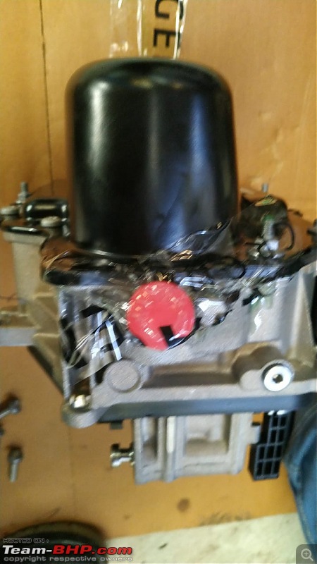

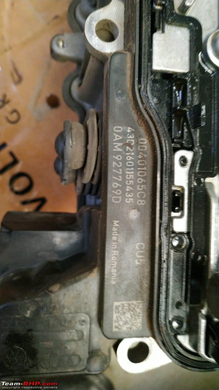

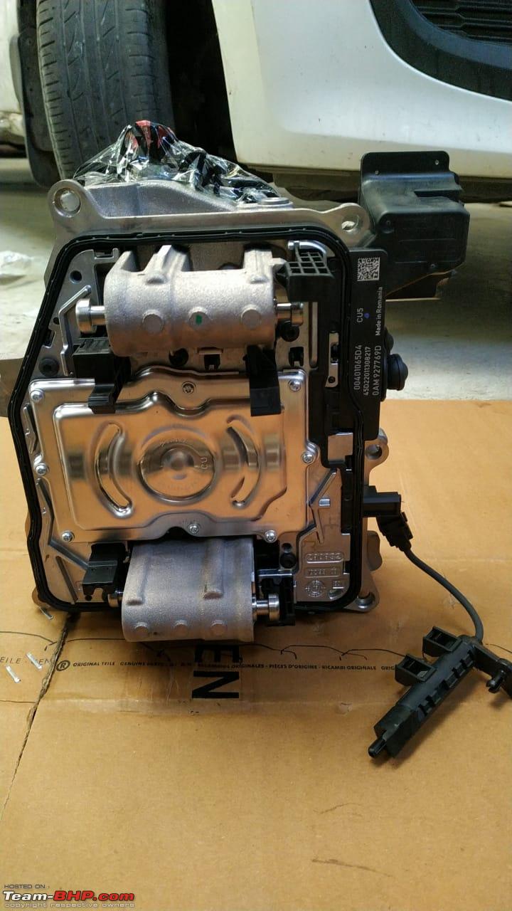

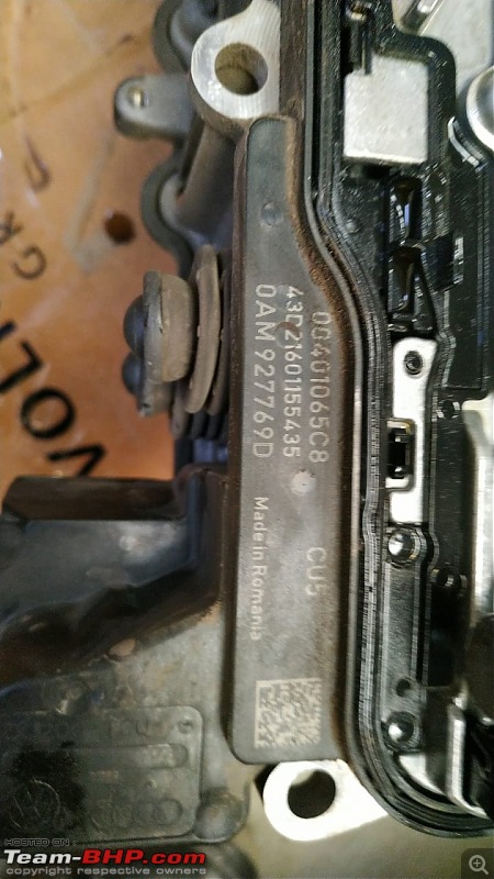

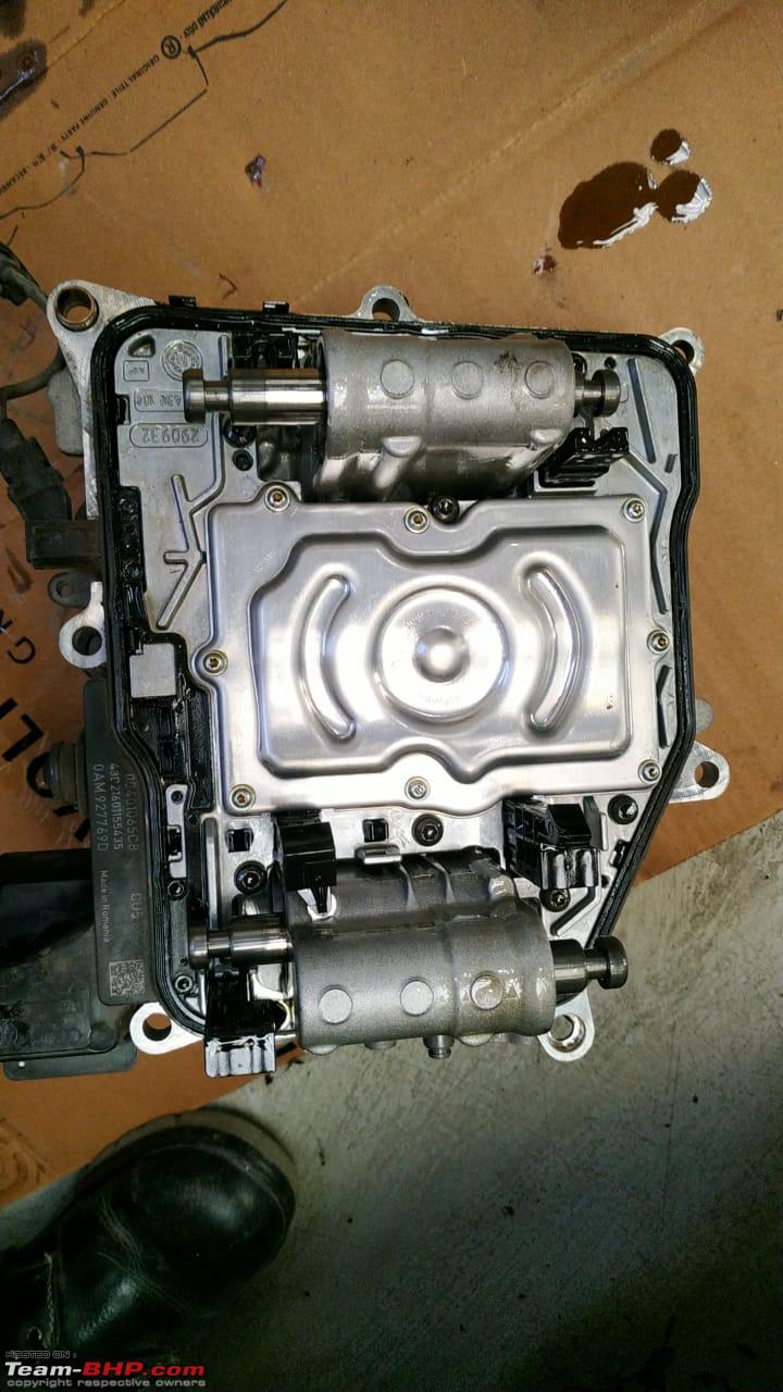

Baroda VW shared some pics of the new and old mechatronic. Sharing here the same:
New Mechatronic Unit:
DSG, demystified! All you need to know about VW's Direct-Shift Gearbox-new-mech-1.jpeg
DSG, demystified! All you need to know about VW's Direct-Shift Gearbox-new-mech-2.jpeg
DSG, demystified! All you need to know about VW's Direct-Shift Gearbox-new-mech-3.jpeg
Old Mechatronic Unit:
DSG, demystified! All you need to know about VW's Direct-Shift Gearbox-old-mech-1.jpeg
DSG, demystified! All you need to know about VW's Direct-Shift Gearbox-old-mech-2.jpeg
DSG, demystified! All you need to know about VW's Direct-Shift Gearbox-old-mech-3.jpeg
