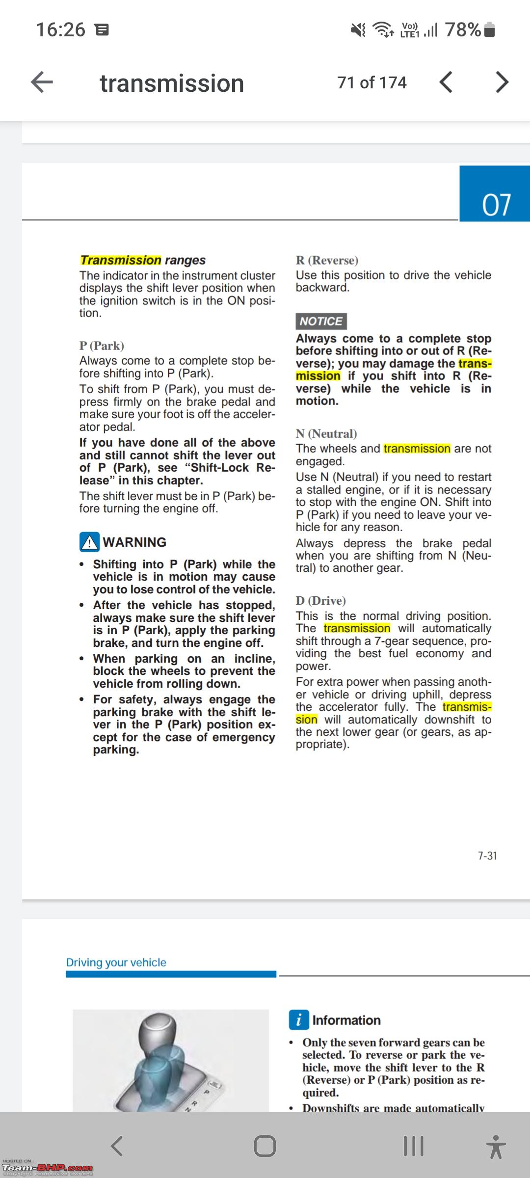

Originally Posted by jayram.r View Post
No dear, there is separate neutral to be activated in such scenario.
I think you might be mistaken sir. As far as I understand it, a dct engages neutral.
Can check the link
Also a good idea to see as it tell you things you need to or rather shouldn't do with a DCT.
Valhalla1979 is offline   (1) Thanks

jayram.r's Avatar
Join Date: May 2015
Posts: 66
Thanked: 93 Times
Re: DSG, demystified! All you need to know about VW's Direct-Shift Gearbox
Am referring to the Hyundai venue owners manual for dct transmission where it states to engage neutral in situation where car is stationary but engine is running.
DSG, demystified! All you need to know about VW's Direct-Shift Gearbox-screenshot_20220514162659_drive.jpg
