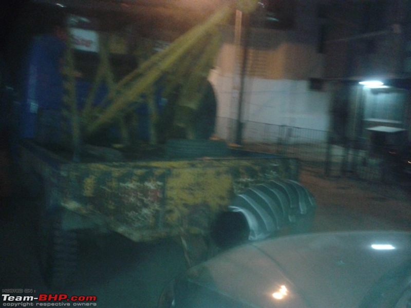

Friends just for you info please.
Got my car some road side assistance from fiat RSA and this is what I got.
Fiat RSA provides you with a number to local tow agency and you have to do the calling and talking with the local agency.
What Came to my car's rescue - A rickety TATA 407 truck which by no means can tow a palio without damaging the bumper and AC condenser.
Towing equipment- they had a countrymade hook which anchors the lower control arms and lifts the car up.
Moral of the story - be aware of this damage which can occur when you seek assistance from Fiat RSA.
Damage to pocket - 3000 INR tow charge and no receipt or paperwork from towtruck agency.
