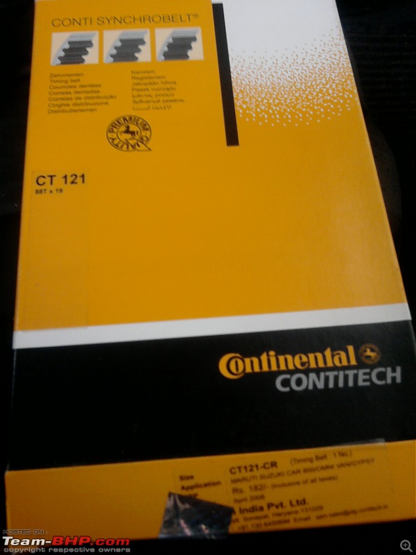

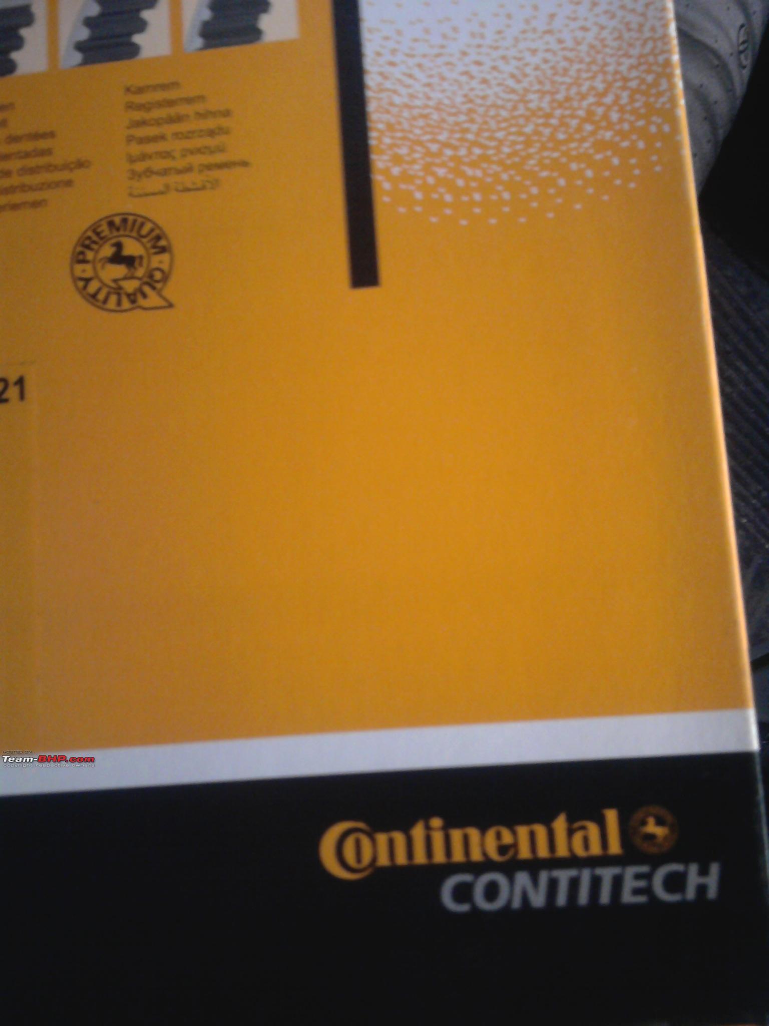

Conti Belt and 850 bucks for Labor ??
Hi ,
here are the images of the belt i purchased from Prakash Auto Store ,Milan subway (Santacruz West).I was told that this belt is a original product ,cost rs 150.
Can someone tell me whether the belt is original or not ?
And for the shocker,i was quoted 850 bucks for labor + extra for bearings if needed to be replaced.
What bearings need to be replaced while replacing the belt ?
Now i got this quote from Milan Auto at Juhu road
,the dude out there is a mr Anand from whom i have been geting the car tuned for the last couple of times.I might say they did a pretty good job
at the tuning part but i think the price he quoted seems to be much on the higher side against what others have paid for a M800
So guys what you suggest, i am yet to get the belt changed.Shall i go to mr Anand or shall i try another garage.You know its' kind of hard to find a good garage who will do a good job.
Please let me know.
thanks

Hi Sumeet,
the belt you have is indeed original continental.
Doesnt mean much though as the quality control on the OE part for the manufacturer is way better than the one for after market.
Belt price is right and the labour is a little on the higher side but not outright exorbitant. The process is time consuming ( about 2.30 to 3.00 hrs ) and involves removal of 3 additional belts , hoods , then finally the cam belt and tensioner bearing. and then refitting in reverse order and also removal and fitting of the right wheel is required to carry out the work.
Its a good idea to check and replace the other belts ( water pump, alternator, steering ) if found damaged.
For the record i paid 600 labour for the work on my accent. the tensioner bearing ( GMB ) cost 475/- and the cam belt make GATES ( 475 /) the remaining 3 belts cost r.s550/ in all.

Originally Posted by HIGHNOON View Post
Hi Sumeet,
Hey highnoon,
thanks for clearing up the process of changing the timing belt.I guess it's because all the stuff is involved i guess the charge seems to be a little high.
I was under the impression it is just a matter of replacing the old belt with a new once once the timing belt case is opened.
Regarding the originality of the belt i might let the workshop guys determine if it will be right to use the same or not.
thanks buddy.
