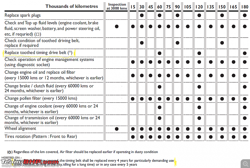

Your mechanic is right. My Linea's owner's handbook recommends replacement of timing belt at 60 k km or in any case every 5 years.

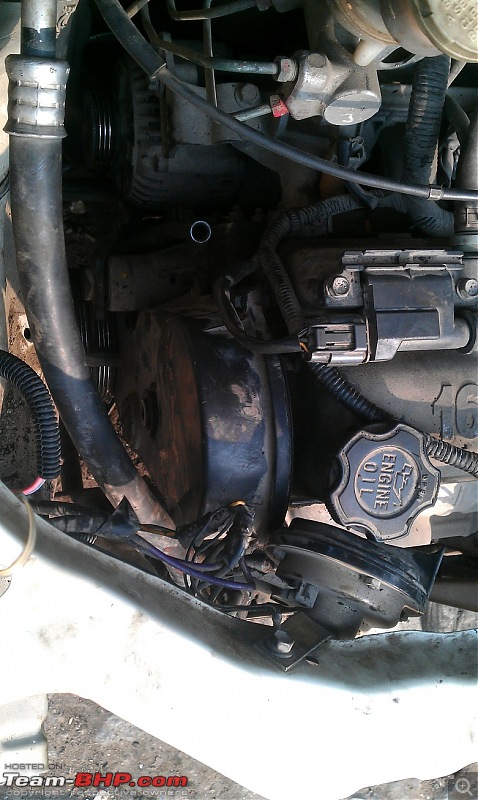

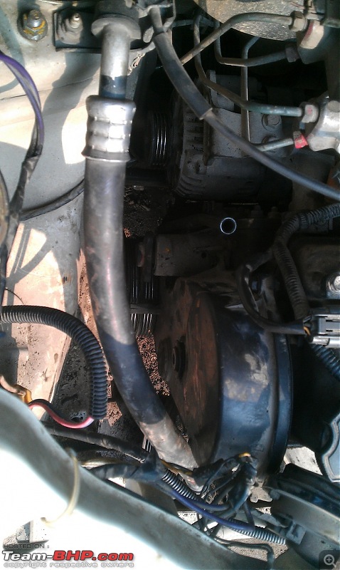

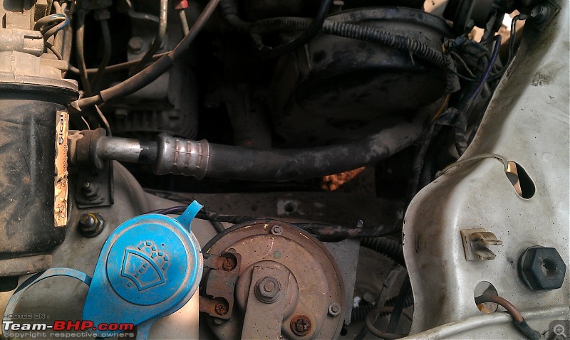

M.A.S.S. was charging Rs. 3500 as labour for timing belt replacement, which I won't usually mind paying, but I was inclined to experience the replacement first hand, so went to my trusted mechanic stationed behind Batra Auto Spares who charged only Rs. 300! (and he did a real good job). He told me he had replaced more than 500 timing belts in his 20 year career as a mechanic! There were 2 guys and the elderly fellow who operated on my machine was an erstwhile mechanic at (now defunct) Sikand Motors M.A.S.S.
First, he took out the a/c compressor and engine mounts before reaching the cam plate. And boy, there is hardly any space to maneuver the tools! Maruti Alto and Wagon-R are notorious for this.He didn't have any power tool but he moved his mechanical tools with much dexterity.

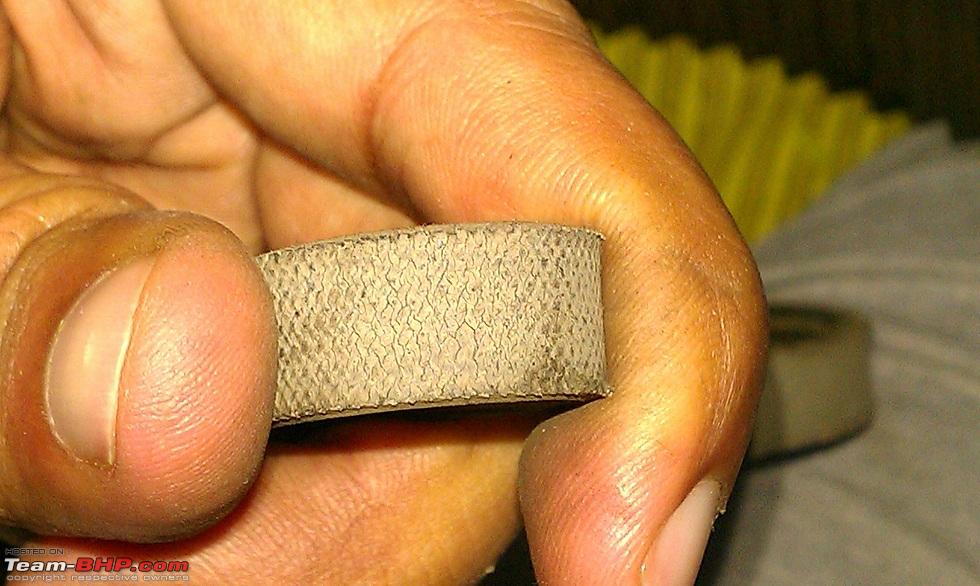

The belt that came out (10+ years old and done 66,000 KM) was ABSOLUTELY FINE. No wear or slack AT ALL. I was thinking that the old timing that'll come out will be all beaten and haggard but it seems that the timing belts are built to last. Here is the state of the old timing belt:

Compare this with drive belt and a/c belt which were about 3-4 years old. They had already developed cracks! Good that I had brought them along as well.
