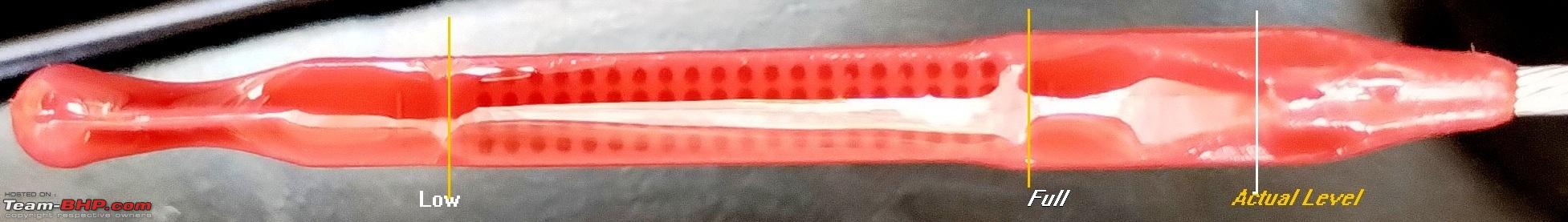

Recently I got my Kia Carens 1.4 turbo petrol first full service done with engine oil and oil filter changed. Have driven for 150 km after full service.
Casually, I checked the engine oil today morning and found the oil level on dip is above full mark (picture attached). Oil level is measured on overnight cold engine. Prior to full service, oil level on dipstick was at Full mark.
Requesting fellow BHPian member to guide me in this matter.

Old 13th May 2023, 16:50   #194
Join Date: Aug 2021
Location: Kuala Lumpur
Posts: 188
Thanked: 115 Times
Re: How harmful is extra Engine Oil?
My hunch is it is harmless.
Look out for foams with dipstick immdediately after engine shutdown as a caution, otherwide I see no problem with this.
zeng is offline
Old 13th May 2023, 18:41   #195
deetee's Avatar
Location: Mangalore
Posts: 505
Thanked: 1,632 Times
Most FNGs and regular A.S.S overfill engine oil when measuring exact amounts is a task of its own. Say, if refill only needs 3.2 ltrs but there are only 3 ltr cans and 1/2 ltr cans available, then the mechanics just pour everything in . Their logic is that a little bit of extra is no harm as opposed to low oil scenario.
However, some owners manuals suggest that excessive oil can cause extra pressure on seals, reduced performance etc. But 'how much' is too much is not mentioned anywhere.
For those cars which have odd refill requirements, this is always a problem in every oil change. So, for peace of mind, carry a measuring jar during oil change and pour in exactly the required amount of oil.
If already excess oil is filled in, and you are loosing peace, just drive to an FNG and get the excess oil removed.
