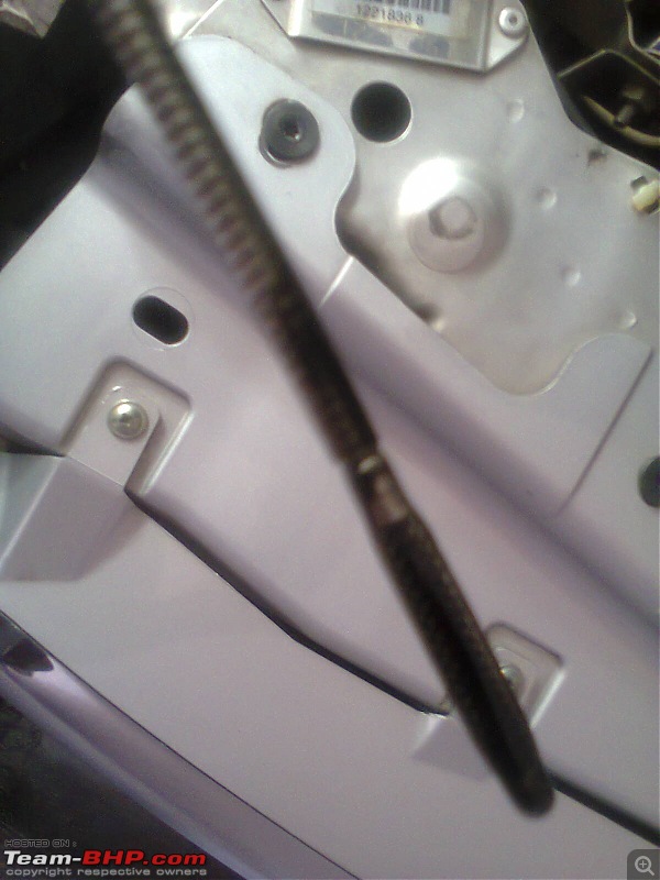

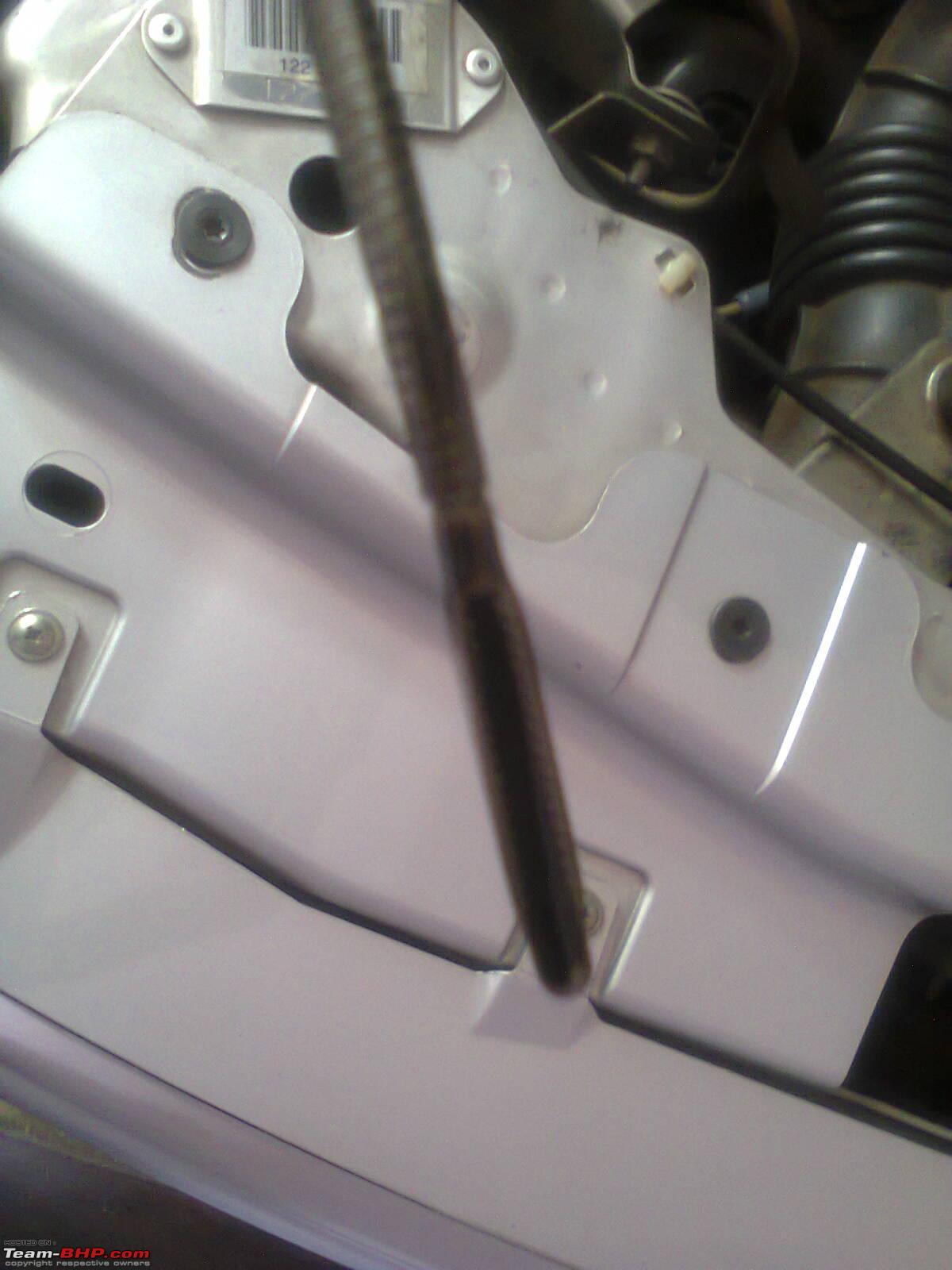

Re: How harmful is extra Engine Oil?
Hi guys,
The dipstick of my linea MJD has traces of oil above the max level after last oil change at FASS. Sorry for the ultra low quality mobile pics.

Originally Posted by Umesh Kumar61 View Post
Hi guys,
That is like 100-150ml extra.
Wont do much harm. Post clear pictures if you can.

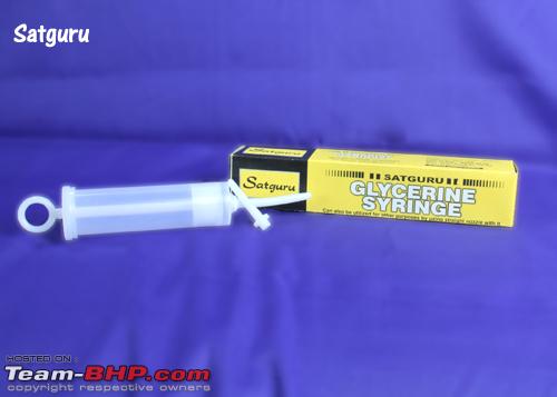

Originally Posted by Gansan View Post
I bought the Ryles tube + syringe, cut off some of the tube from the bottom (the perforated area) and tried to remove some oil experimentally. Did not work for me. No oil came out.
I later tried it out with a mug of water to see if something was wrong with the syringe, but it worked perfectly. What did I do wrong?
In addition to what BHpian goandude says, viscous oil won't get sucked in easily, esp. with small syringes, so you need patience and a few tries to make it work.
Ensure by dipping the tube first that it's breaching the oil surface (I'd recommend using a longer tube so it actually touches the sump bottom, gravity will help your cause marginally), then use the syringe really slowly. I failed the first couple of times as well and just pulled up air, before I got the hang of it.
Try to procure a Glycerin syringe from a surgical supplies store. Provides better suction due to larger cross-section of the plunger head, and the higher capacity (usually 80-100 ml) means lesser usage cycles.
Something like these (pic taken from Google image search):

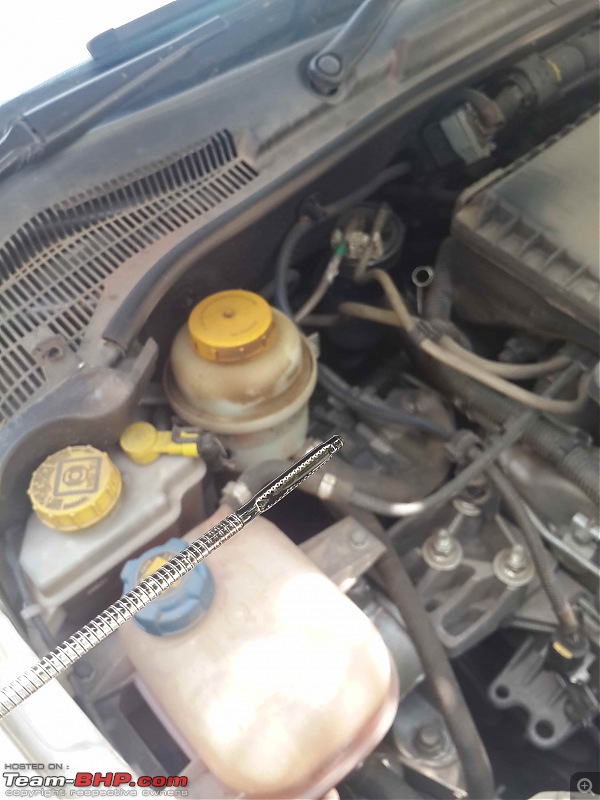

Hi Guys,
I have found that the engine oil level in my Punto 90Hp MJD is above the mark. Can you tell me if there is something to bother about?
Thanks,
Sai
