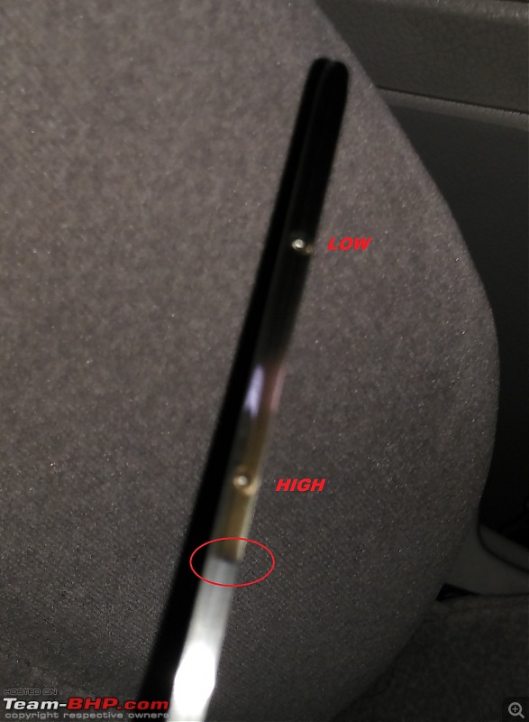

This is Dipstick of Altis Petrol 1.8 L
Oil is excess by about a CM on the dipstick from the High mark.
Do you think this can damage the Gasket and cause oil leakage?

2-3 mm above the mark is ok, but this is around 10 mm. Don't take chance, get some oil drained.

Excess engine oil causes a lot of splashing of the oil in the sump. Splashing and resultant foaming (bubbles created) can reduce the oil level in the sump. This can also build up pressure inside the crankcase.
Reduced oil level has potential to seize the engine bearings. Pressure build up can cause oil seal failure, again reducing the oil level, in turn seizing the engine. The damages are costly and time consuming to repair and if this happens out of the city, you will also be stranded at odd time.
There is an example on the forum. Punto engine damaged because of excess oil.

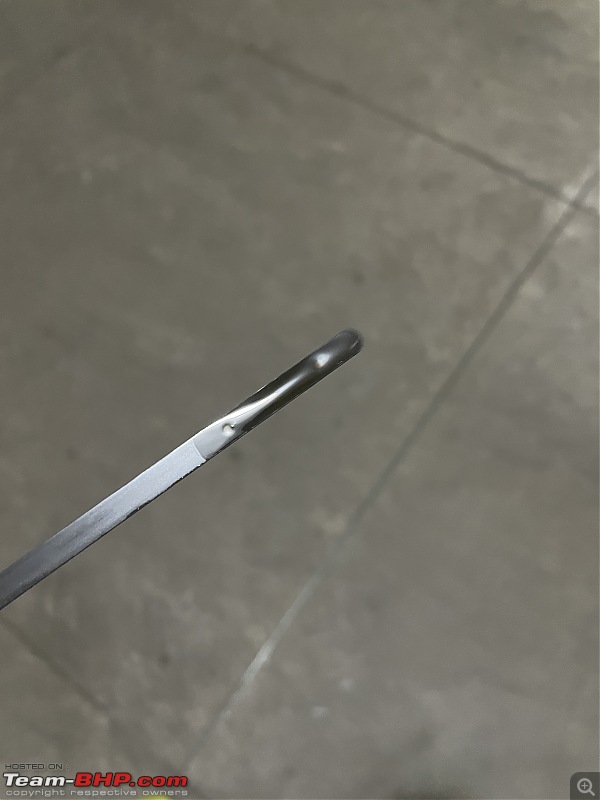

Hello fellow bhpians, reviving this thread in need of assistance. I got the oil changed on my Honda city 2019 Vtec 1.5 petrol today. I had a Mobil 1 4L jug with me since the car takes somewhere between 3.6-3.7L of oil. Added a new oil filter as well.
The mechanic emptied out the whole 4L (almost, some 50-100ml left) thinking it was the 3.5L can (since mobil jugs look the same)
Attached are some photos of the dipstick taken when car was on a level surface and engine warm (not hot). The oil indicated is certainly above the max mark by around 0.4-0.5mm. (attached photos)
The mechanic says for cars a slight bit of excess engine oil is a non issue but I'd like some advice here on whether I need to get the excess oil drained,

The oil level is above the mark by .5 cm or so. My recommendation is to buy a big syringe and pipe to fit it from a chemist and take out excess oil from the same hole where dipstick goes. Excess oil could cause foaming and damage the cylinder etc. A petrol car anyway doesn't bring oil so ideally it should be a little lower than the mark.

DO NOT over fill engine oil. This is NOT a casual matter. Midway between the min & max levels will not do any harm, but engine oil must absolutely NOT be overfilled.
The intent may be to show TLC to the engine/car. But excess engine oil is NOT one of them.
Buy a Ryles tube & a large sized syringe, and draw out the excess oil through the dipstick. Please do it only when the engine is cold. (This may seem obvious to you but it's for visitors who refer to the forum for guidance.)
The mechanic says for cars a slight bit of excess engine oil is a non issue...
Please find another knowledgeable mechanic for the next oil change.
