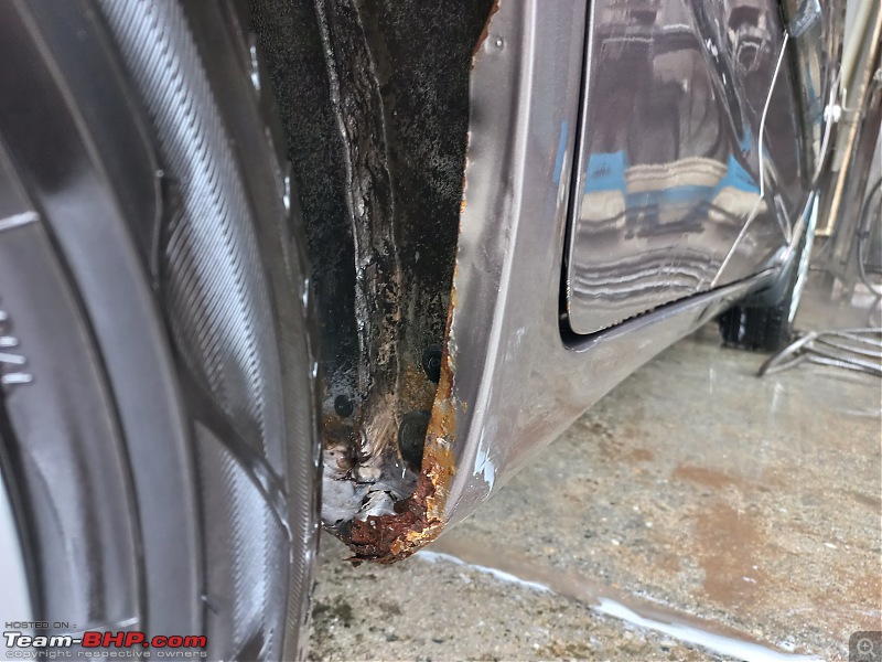

Hello @All,
I have an 11-year-old Honda Brio and recently during a wash I observed rusting in both the rear wheel arches. Except for this issue, the car is absolutely fine, and I plan to keep it as long as possible.
What are my options to fix this?
Will under body coating help in arresting the rusting?
Attaching photos for reference:
Underbody treatment / Anti-rust coating for the car-rust_image_1.jpeg
Underbody treatment / Anti-rust coating for the car-rust_image_2.jpeg

Originally Posted by onthewheels View Post
Hello @All,
Technically the correct way is to get rid of the rust as much as possible using a abrasive brush,then use a marine grade rust converter and then apply anti rust coat along with a top coat.
This would prevent further rusting.
