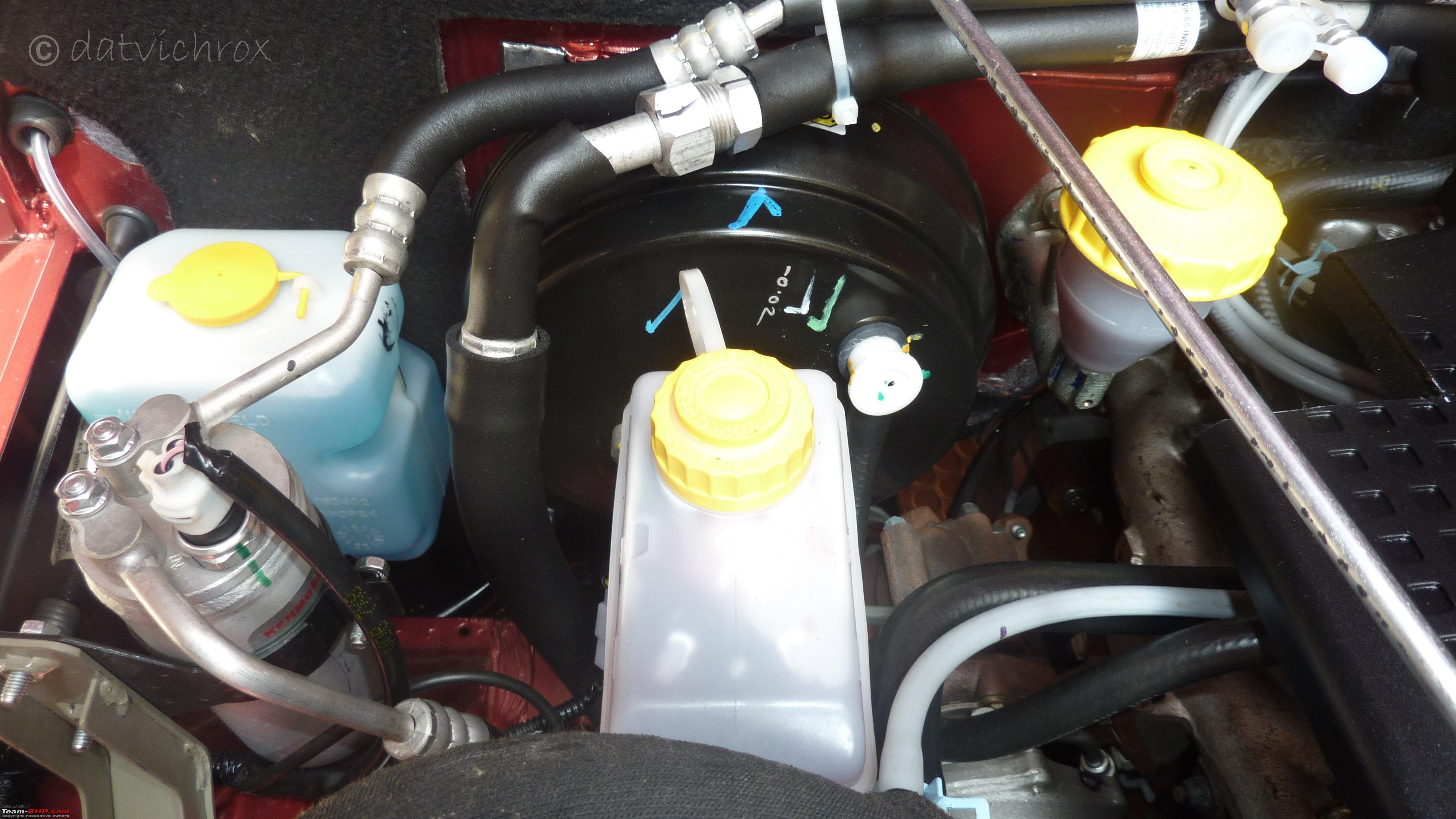

Sorry for the delay, I could hardly spend any time with the new jeep after I got delivery!
Review: 1st-gen Mahindra Thar (2011 - 2019)-upl_1.jpg
Some images of the brake parts. I have to say that the brakes feel really good, I don't see a reason to worry. Taken her upto speeds of 80 and slowing down is not a problem, no problems in stop-go traffic too. Got to do some highway runs and see.
I don't exactly know what the vacuum tank looks like, so let me know if its not in these pics.

I had set aside a budget of 10k for brake upgrade, I think I don't have to do that now. Going for the HHT next month.

Originally Posted by datvichrox2 View Post
I don't exactly know what the vacuum tank looks like, so let me know if its not in these pics. I had set aside a budget of 10k for brake upgrade, I think I don't have to do that now. Going for the HHT next month. I also faced the first issue after ownership. Complaint: A high pitch sound was coming from the front wheels, and frequency increased with vehicle ]
Hey,
Thanks for the picture however the vacuum tank is located in front of battery, right side of the engine bay.
Gr8! I am also looking for HT however still confused about design please upload photos once you fit HT.
