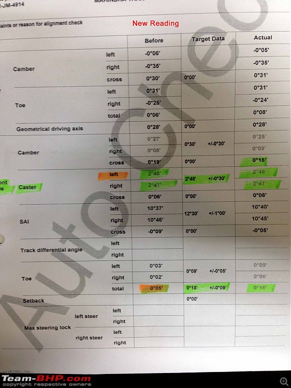

re: Review: 1st-gen Mahindra Thar (2011 - 2019)
Hello everyone! I have a Oct 2012 Thar CRDe. It's been a pleasure owning and driving it. Lately I have noticed the front left (passenger side) tyre tread has worn out much much more than the other three tyres. I have driven approximately 11,500 km so far and was scheduled to have the tyres rotated at the next service. The owners manual recommends tyre rotation at 10,000 km. My question is, is the uneven tyre tread wear on the front left tyre only, a result of wheel alignment issues or does it point to something more such as suspension setup?
I have also considered the ASC swapping that particular tyre during a past service, though I don't think so as the tyre serial numbers almost match. But I would not put such behavior past the ASC as I have witnessed their crook behavior first-hand in the past.
The front, right-side (driver side) tyre also has tread wear but still not as much as the left side while the two rear tyres tread are as good as new.
Would you recommend I have the tyres rotated right now along with an alignment job or have it checked for other issues also such as suspension setup?
The problem is I don't trust Mahindra ASC to even comprehend the problem considering my experience with them in the past. It would be time and money down the drain going to an ASC. They have absolutely no clue on how to service a Thar. Instead will a legit alignment center be able to sort it out?
Thank you!
Thank you!
The problem is with left caster adjustment. I had same problem however I realised it when I installed the alloys. It was at 5000 km, so luckily no tyre uneven wear out.
After installing alloys I observed left pull so rushed immediately to known alignment guy and fixed it. You will have to approach the right/friendly shop, many alignment shops do not do this job as it is time consuming and charges are negligible.
I do not know the technical details or implication of this however I am attaching before and after figures of alignment report. Hope it will help you.
Old reading where steering was pulling left.
Review: 1st-gen Mahindra Thar (2011 - 2019)-old-reading.jpg
New reading, steering do not pull anywhere.
Review: 1st-gen Mahindra Thar (2011 - 2019)-new-reading.jpg
Bill
Review: 1st-gen Mahindra Thar (2011 - 2019)-bill.jpg
Thar4x4 is offline   (2) Thanks
