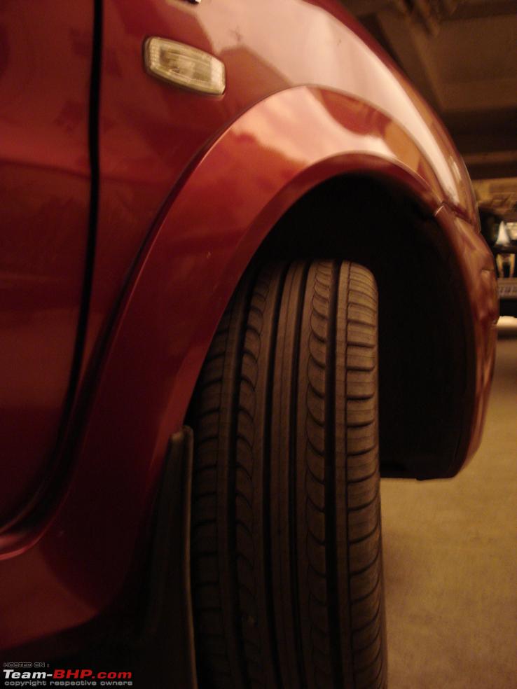

OMG before buying it i checked with Apollo tyre company as well and they directed me to a dealer..its ok nothing can be done now. i am attaching the snaps as well

600/- is bogus.
At the most the rates would have varied by 100/- or so. No way anyone would have got 185/60R13 Acelere for 2200/-. Impossible.
BTW, it's not safe to run those tyres on the OEM rims. You can see ho0w the tyres are squeezed into the narrow rim.
WHOA!
What are those? 4J rims?
nitrous is online now

They should be 5J rims
Tanveer ran that size on his indica ( same rims ) without issues

there is no problem till now i have faced having it on OEM.... But soon will change it to alloys..... Budget issue so didnt go with it But the size looks really huge to me

For 185s, 5.5J is good. 6J is besht!

I run 185/60R13 on my indica stock rims. This is the max those rims can take. 195 is overstretching it
