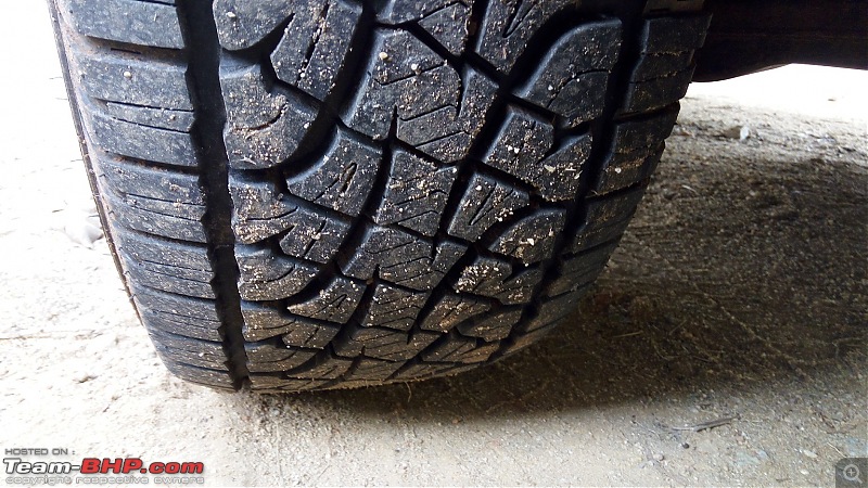

Hello,
Got the stock apollos changed to Pirelli Scorpion ATRs on our company's Scorpio S4+ 4WD. Apollos clocked 42000KMS. These are OE size 235/65 R 17. Have already clocked 1000KMS in a week, they are a bit noisy on road but are good in slush and broken roads. Paid Rs 12500 a piece, got them from Tyre Empire - Whitefield, Bangalore.
Darshan
