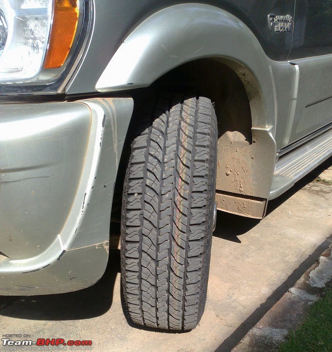

Alright guys, so my Beast has a new set of Shoes. Thanks for all the inputs. I settled for Yoko Geolandars A/T-s. Just done about 50 Kms on them. The ride comfort seems to have improved. Road noise seems to be more than the JK Elanzo. But this is the first impression, need to go for a longer drive to come out with a more authentic view point. Will keep you all posted.
Also attaching couple of pictures just after the change.
Mahindra Scorpio : Tyre & wheel upgrade thread-lookstbhp.jpg
Mahindra Scorpio : Tyre & wheel upgrade thread-treadstbhp.jpg
