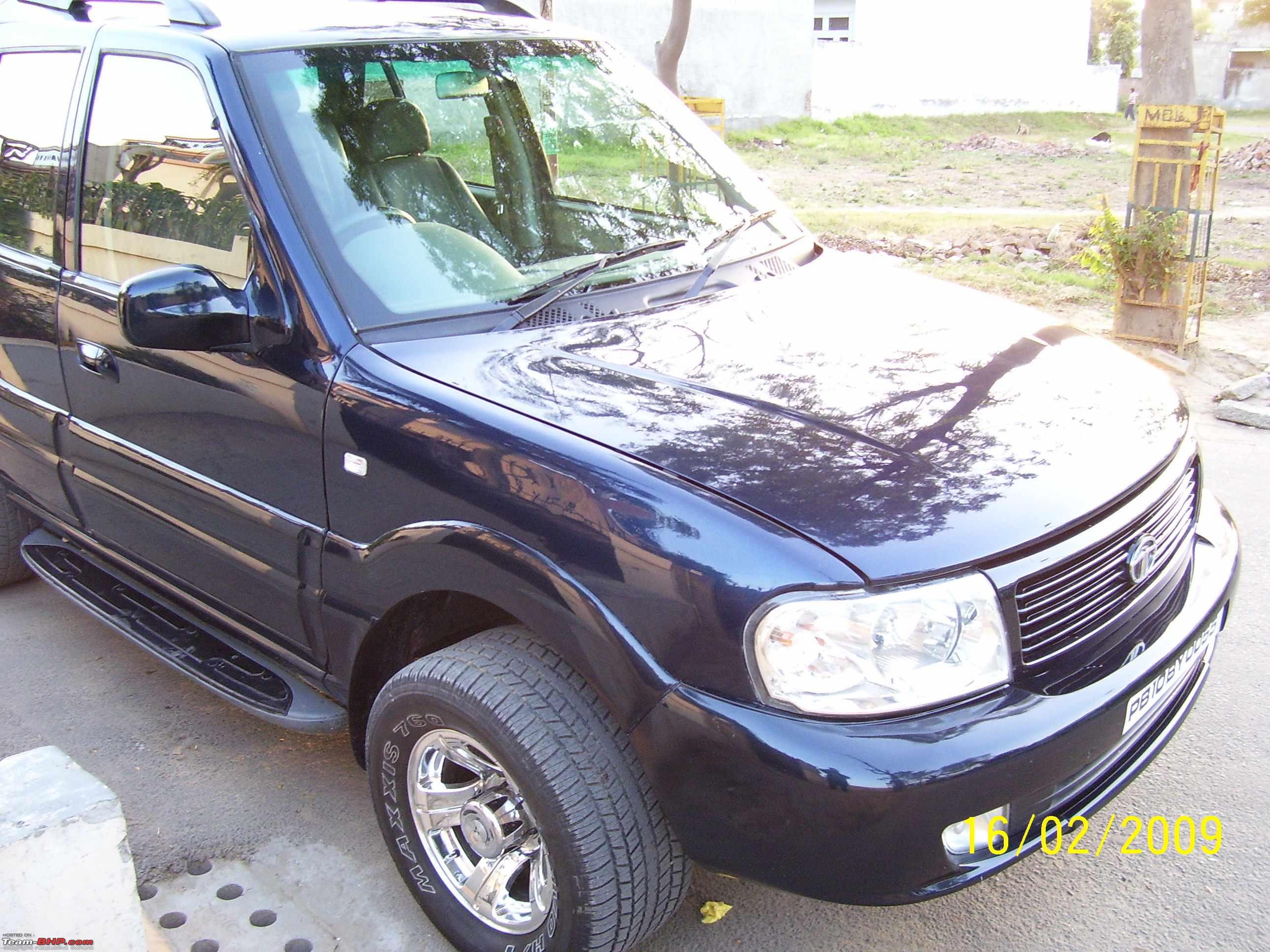

Originally Posted by ibm_jennifer View Post
Guys,
Whats the "widest" tyre available for a TCIC Safari? Will a Endevour tyre fit?
295/55/15 maxis
check out this pick of my friend's DICOR who is running 15".
and paint job is new its a 3 tone one.
