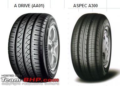

Are there different models in the Yokohama A-drive series? I have heard of AA01 and A300 patterns - is it just a difference in the pattern or there different uses as well?

AA01 = A drives
A300 = ASPEC series
Both are good comfort oriented tires. A300 is only better than A drives in terms of road noise. The pattern of A300 is such, that it will look smaller than A drives.
The prices quoted are on the higher side. Check with some dealer also.
