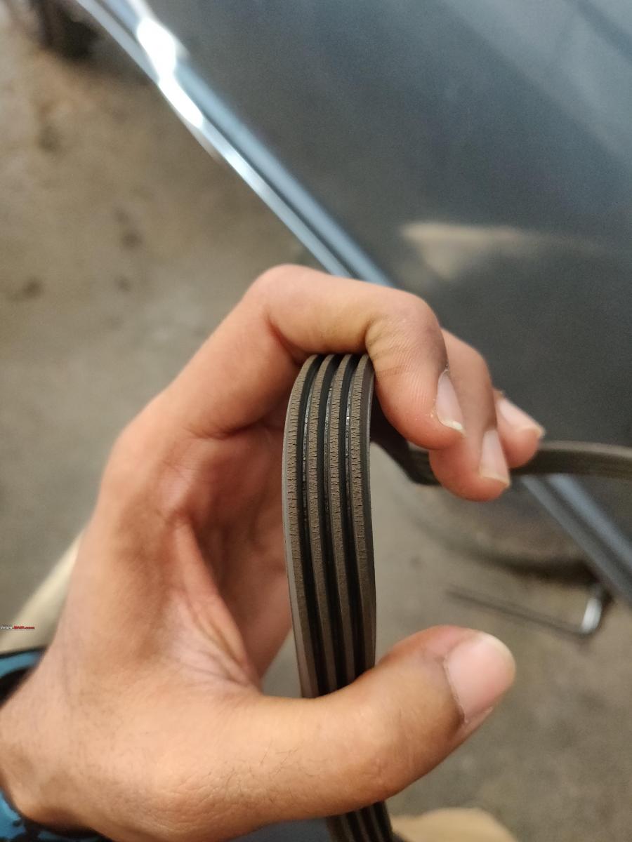

AC belt had become weak and a replacement was due so it was good I chose to change all belts.

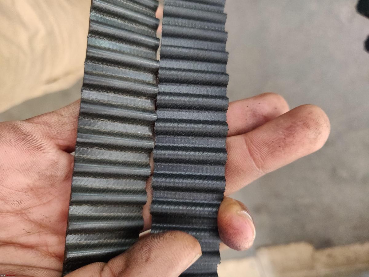

New belt vs old belt.
New belt vs old belt, notice the cracks on the old belt.
Close up of the cracks.
